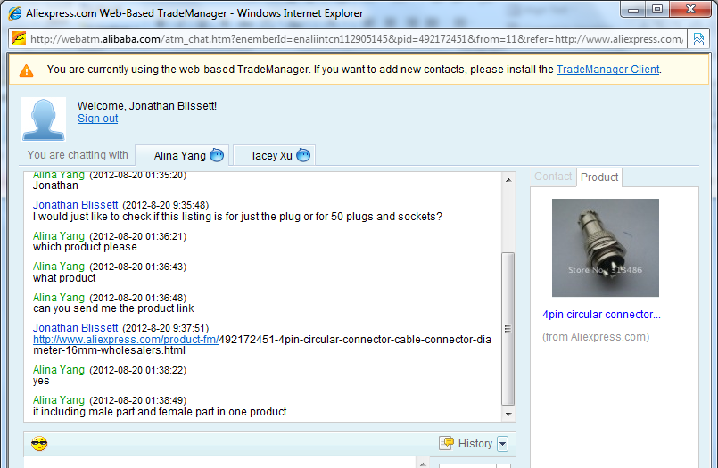

Yes managed to cancel the order but spotted another problem.
The multi pins I already have [ forget the high speed motor ] are opposite, the chassis sockets are female. If you use these GX16-4 or the 19-4' [ or 5's ] for stepper drives the pins, when connected, are live.
Can't seem to see the opposite version, must have a different designation but can't see what it is.John S -
