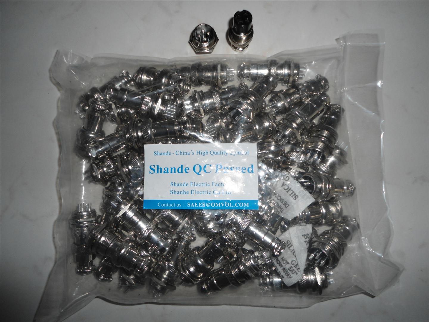

    They arrived today:

    I prefer to do that, but for some reason people seem to enjoy sticking connectors in between.

    Whcih ones are those Jonathan, they look like they're still the back-to-front ones (chassis plug/line socket)?
    Did anyone order some chassis socket/line plug ones in bulk and be willing to sell some?
    Yes they are, but they'll be fine for limit switches and signals as they're well under 50V. I'm going to order some of the right-way-round ones - once the seller has got back to me about getting them with 19mm external diameter I'll get some of both sizes.
