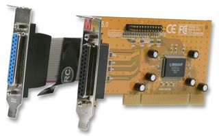

    CPC have loads
    PCI

    CPC have loads
    PCI
    Did you note the price? Or have I got to look it up?
  9. £37 (just click the link!) but CPC aren't cheap. that card uses the same chip as the LogiLink one I posted about earlier from Amazon, which is only £11!
  10. #9
    Circa £26 extra to get a half height version. Hmm.

    U did say small form ? thats what I was looking at for you..
