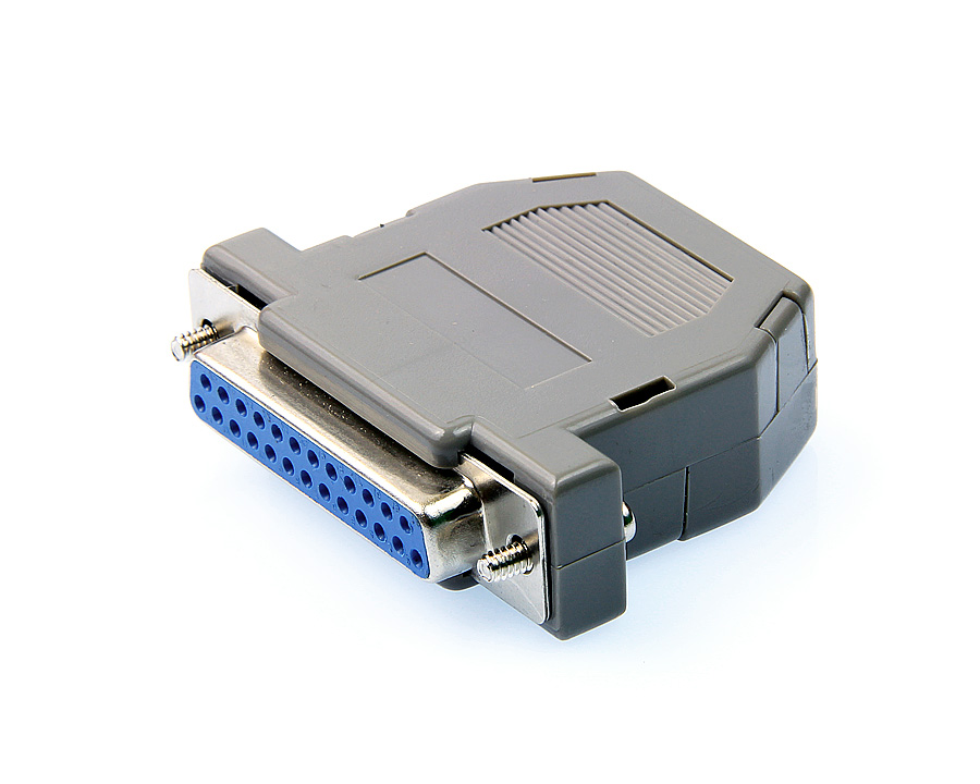

  1. Purelogic RnD new USB tiny Mach3 motion controller PLCM-LPT2
    Interface
    : STEP/DIR/ENABLE
    Max. freq: 100KHz
    Pins: 1 port (same to standard LPT ports), 12 "out" and 5 "in" pins. All ins and outs are buffered.
    Site: http://plmotion.com
    Main features:
    • USB Full-speed connection
    • Up to 6 axes, 100kHz pulsing engine
    • PWM spindle control
    • Probing
    • Torch Height Control
    • Slave Axis support
    • Soft limits
    • Easy firmware update
    • DB25F connector to reproduce standard LPT connection
    • DLL for direct access to controller could be provided
