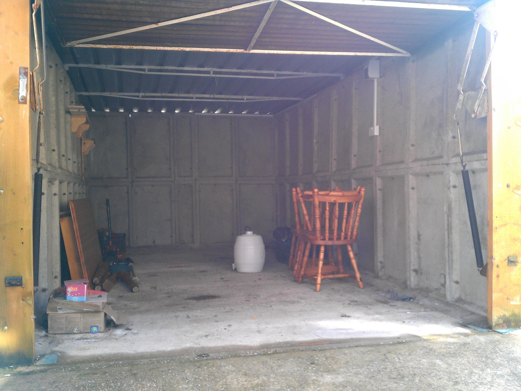

    we've recently moved in to this house, and part of the criteria for us moving was that i had a garage for all my tools and for me to have a place to work on my hobbies and slowly build up my collection of tools which will peak with the build of my cnc machine at the start of next year.
    now the choice of how the garage has been built is not my choice as i'd have had brick built over this any day, but either way its at least 20 times bigger than the outhouse i worked out of at our previous house.
    started off like this

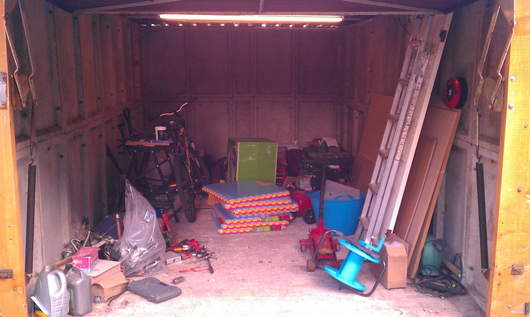

    as a storage place while we moved, believe me the amount of crap I've shifted out of that garage the last few weeks has been depressing

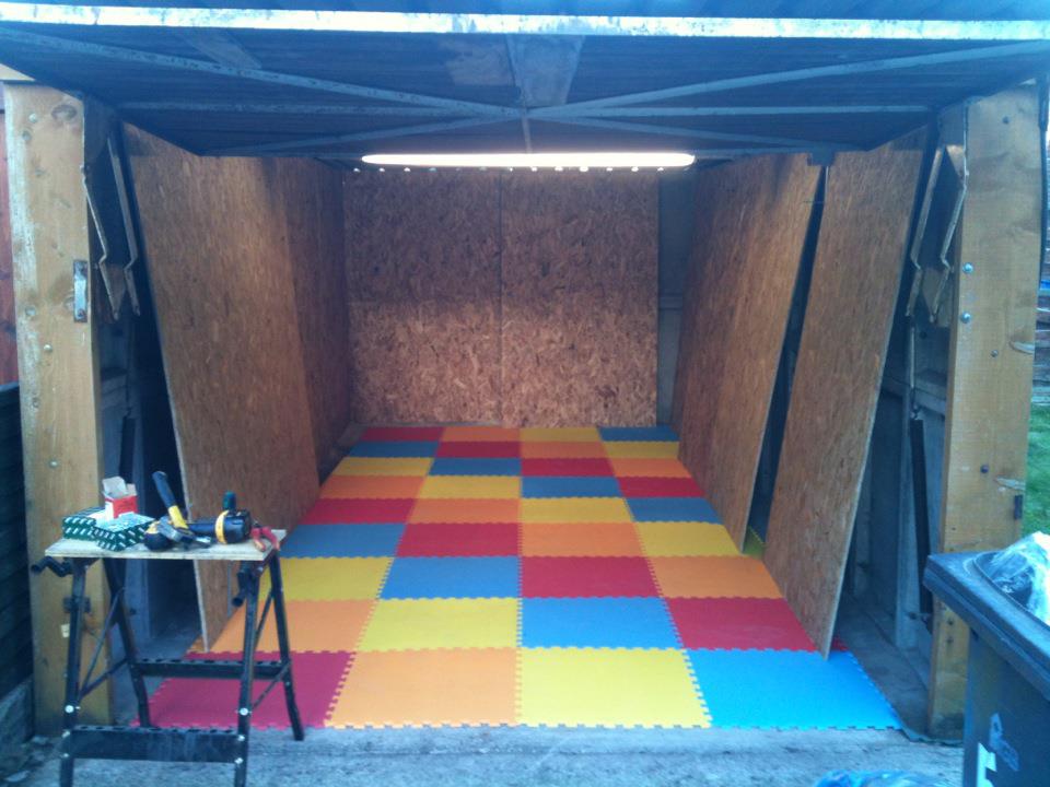

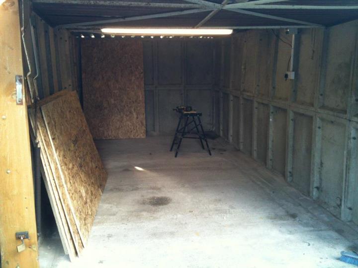

    so today i got started on cladding it out, material of choice is BnQ's OSB 2 11mm board, all cut to size and delivered to the garage all i have to do is simply drill a few holes and it's done
    all cleaned out ready to clad
    I've had problems drilling the concrete garage as i believe it's steel reinforced so it's pot luck if i hit any metal.. i hit something today i'm it melted the bit square off, so i'm borrowing an SDS this week which will hopefully help get it done

    the funky flooring is actually some cheapo outdoor play mats that Tesco were floggin off for £3.50 per pack of 4, i'd always said i wanted a padded floor due to bad knees so i'll never have to worry about where i'm kneeling down, plus i plan to do some exercise in here as well so it's multi purpose it also has the added benefit of being soft on the feet so when standing still for ages it wont be a cold concrete floor beneath me. i actually like the fact it's coloured :D
    future plans are 2 x 25mm mdf worktops which to start with will be mounted on some timber frames, but i would like to make steel box section frames and bolt them down to the floor so i can mount a vice on one and have better stability. at the end of one work top will be the mig welder I've just bought, the end of the other one will be a table saw. the cnc i plan to build will basically take up the space of a 2x2 square of the flooring.
