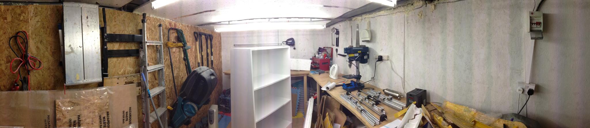

    here is a fancy pano picture of the garage as it stands in its messy state.. i cant wait to get that box painted and reclaim some of my space.

    i was out there spraying some expanding foam in some gaps, frost outside, me nice and warm inside the garage with nothing but the oil rad on... while it's not perfect out there, it's certainly a nice place to work in.
    the problem with my new gear arriving is i have nothing to do with it at the moment.. i need to find a steel supplier who doesnt wanna charge me the earth
    well i've got a friend on the case he has a contact through work who he thinks can get me what i need. however i found a place today on the net that will supply full 7.6mtr lengths of both types of box section i need.. and the 50 x 25 x 3 is a good price 2 lengths delivered for £72 but the 60 x 40 is a big jump and i honestly only need around 2.5mtrs so i'm getting some quotes from ebay guys as we speak
    well we've had a big enough downpour to prove my roof is now leak proof.. and i've only had the oil rad on 3/4's all day and it's keeping quite warm in there now.. i'm acctually really happy with my garage now
