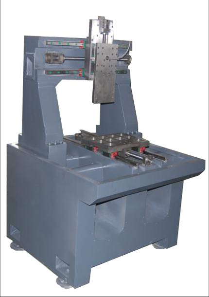

    I do mineral casting Click image for larger version.
