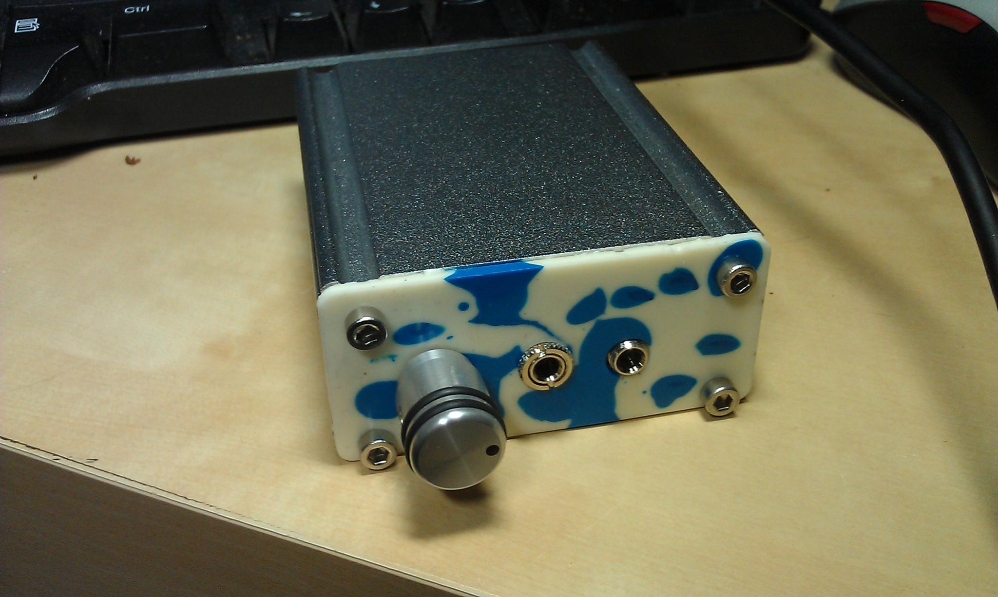

    I added a picture of one of my prototypes, the face is cast and bolted to a standard enclosure. Disregard the colours etc its just what I had left over from another project , but I hope you get the idea :)

    sweet !
    if you ever have the time (and inclination) id love to see a quick guide on how you go about casting resin like that

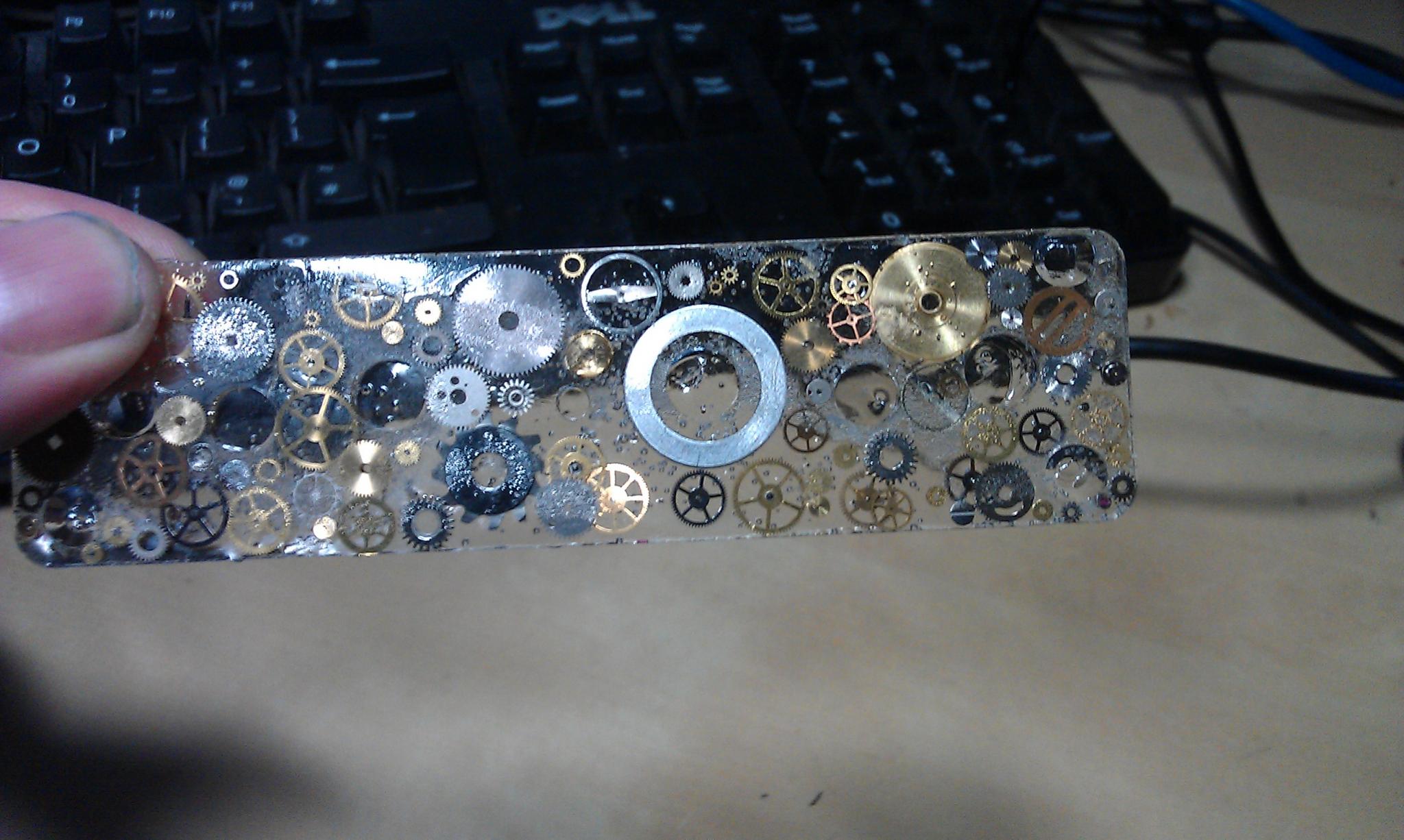

    well it can make things like this , btw I need a pressure chamber to get the bubbles to go tiny, i have one on the way from the USA ,
    This is the front face to an O2 amp Im working on , like I said its a prototype I will get it alot better with my new shiny pressure pot :)

    nice
    pressure makes sense, do you not also pull a vacuum to get the larger bubbles to rise first ?

    Aahh, a bridgeport power feed gearbox, heavy duty version.

    Actually Mark ..no and thats why there are so many more bubbles than normal, because I did vacuum it first. The problem is it expands the bubbles but they dont pop even with my Robin-air pulling 50% more than the recommended -27.5inHg. So I read up on it and found that the reverse is needed , pressure of around 58 - 62 PSI. You see for me every days a school day lol !
