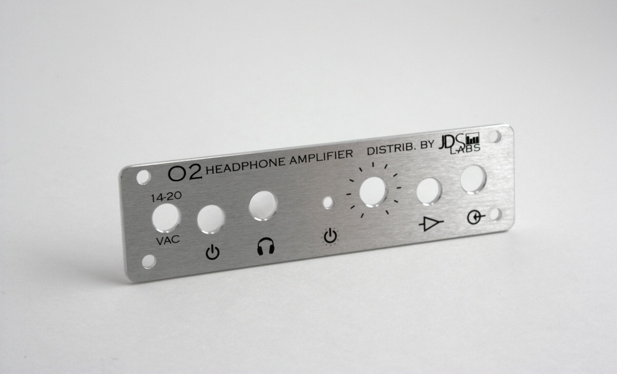

    Just as a query .. I take it that being liquid cooled means the spindle and not gushing water over the tool ? Also if anyone can answer this, and yes it may be a silly question but how do they put the letting on the face plates .. i was thinking of etching them then filling with paint but is there a tool for the miller ? BTW theres money to be made making these custom plates for people, one of the reasons I invested in a miller, to do the one below as a "one off" would have cost me close to £100.. now they sell for less than £6 plus postage .. but back before mass production to get one made so I could mould it would have been very expensive.

    Yes, its the spindle thats water cooled. there's no option for coolant on that machine, but when cutting ali a garden spray bottle filling with cutting fluid and the occassional squirt is all thats needed... or a compressed air blast works too. Depends on cutting speed/material/etc.
    When I used to do faceplates like that in the past we had these approaches...
    prototypes: letraset and lacquer
    short/medium run: Screen printed or photostencil, etch and paint-fill. For ali panels, photoresist, etch and anodize was also an option.
    medium/large run: screen printed or die punched. Tho milled/paint-filled was used on occassion for equipment that would take a battering or where the panel was too thick for die punching - usually military stuff where cost was less an issue and the paint-fill could be redone in the field.
    You can now buy metallic layered perspex that when engraved shows the rear colour thru. You can also get reverse laminate where the front stays clean and you engrave in reverse on the back then fill in with paint, so you get all the engraving on the back and a clear front so it can't mark or rub off.
    These were done with a laser but no reason why they could not have been done with a CNC router, in fact that's all i had until I got the laser.

    yes, the spindle is water cooled.
    im guessing that plate has been etched, mayber with a lazor?
    it would take quite a bit of effort to machine it with the diffrent size/thickness of fonts
    if you tacticaly designed a line drawing decal you could easily drag engrave your plates add a touch of paint then burnish it clean?
    a simple spring loaded drag engraver it pretty easy to make if you can get to a lathe?
    Seems Like a lot of work Mark .. I think Irving’s idea of printable decals could be more my skill level lol I have seen dry decal kits advertised, I’m looking into that..
    Thanks for that , I have a compressor I’ll find a 2nd hand air gun and buy some cutting fluid, and I think decals will be the safest and probably easiest method.
