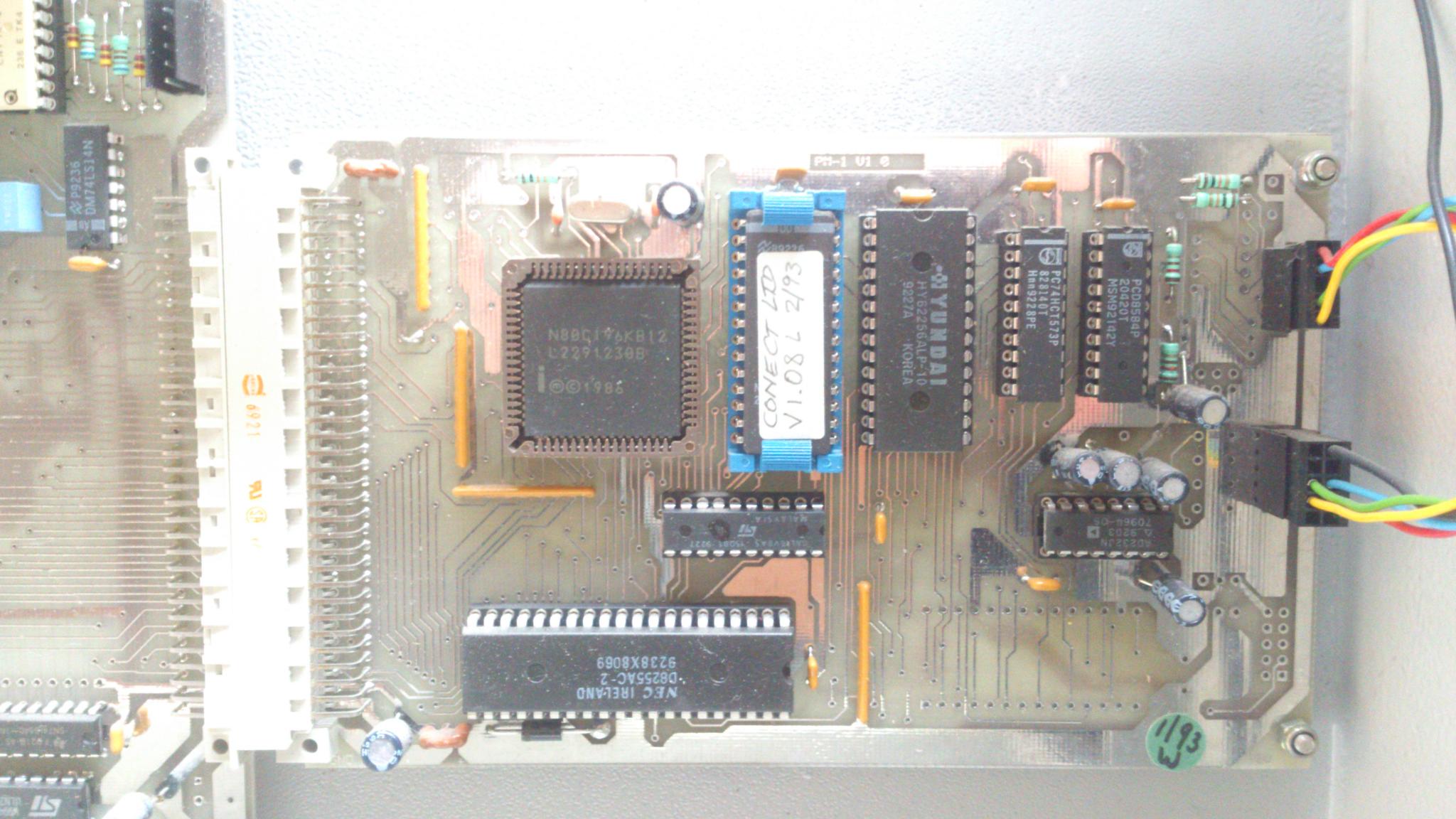

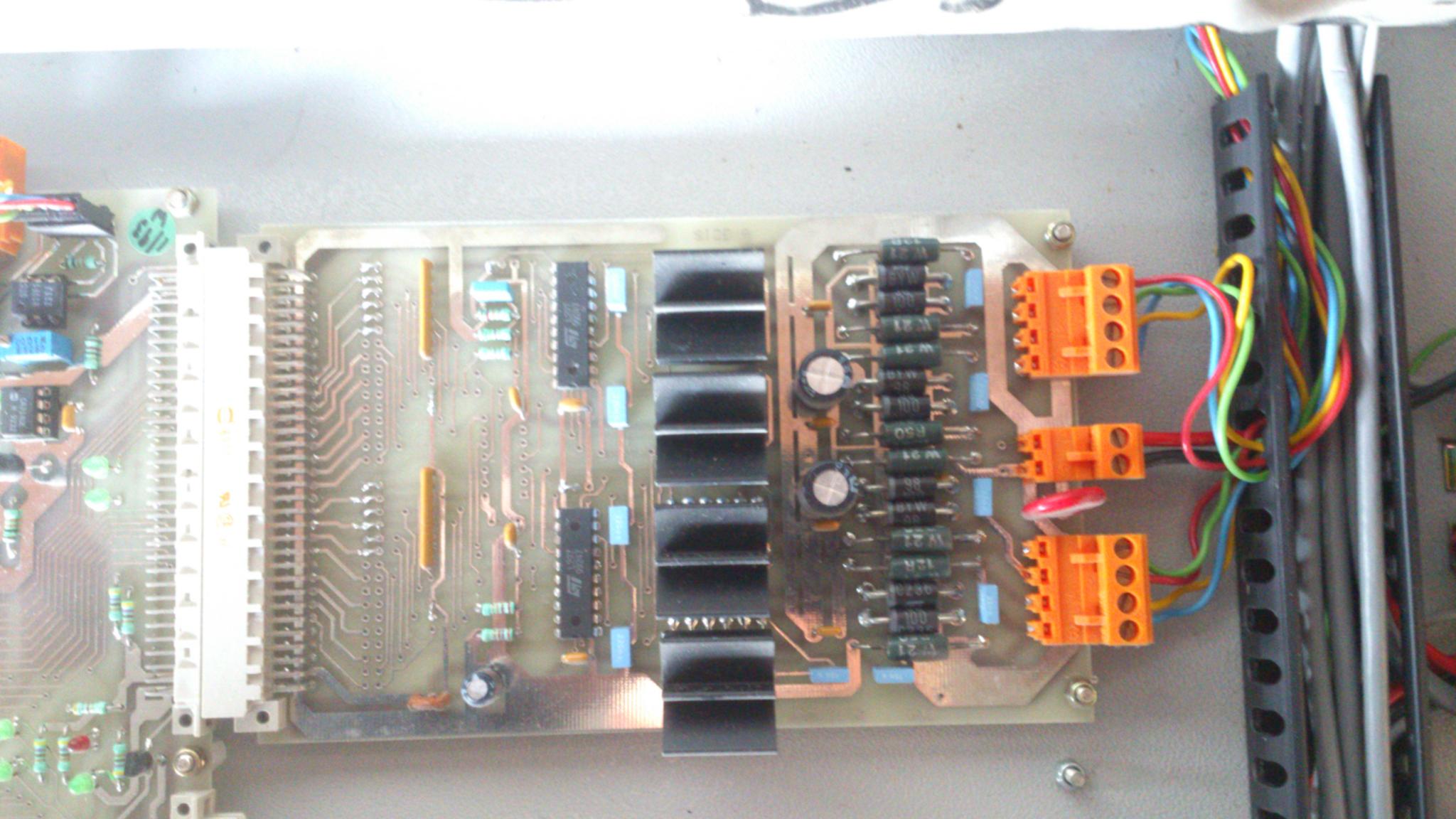

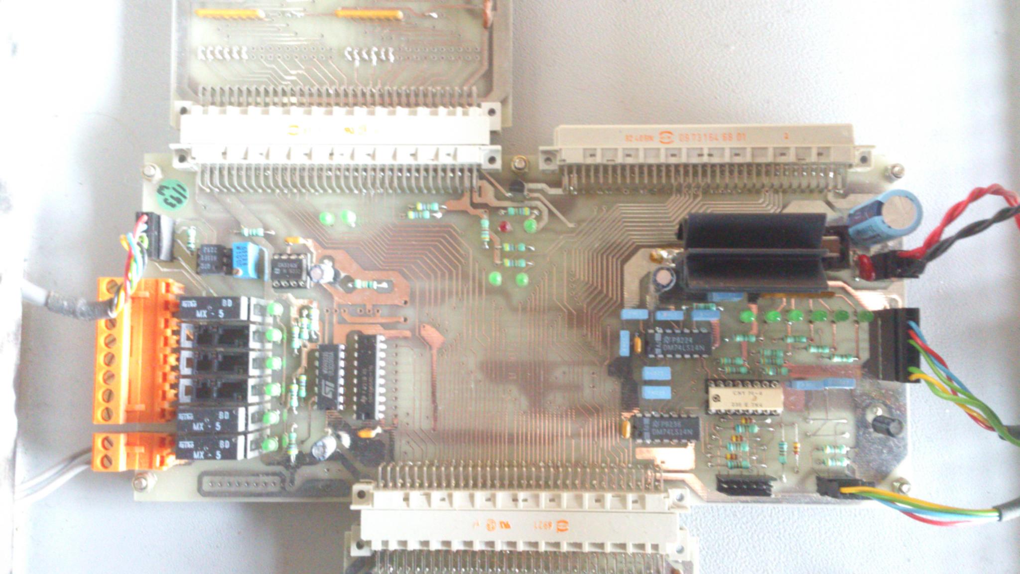

    Hi John S,
    I've attached some photos of the boards in my Conect Cadet lathe. Are these the same, or similar, to those you removed from the Conect 121?
    Smithy50

  12. #40
    Hi x-rayman,
    I got a USB-Serial cable, and got it set up OK on Windows 10, but had some difficulty configuring it in DOSbox. Consequently, I used an old Win98 laptop with one serial port (COM1) and configured it using 'MODE COM1: 96,n,7,1' in the autoexec.bat file.
    I initially installed the Turning 1.2 software, but it gave a 'Runtime Error 200 at 0003:363D' message. I then installed the V2.7 conectl in the conectl simulations folder. I was able to run the program, but not connect to the lathe. I tried different baud rates, etc without success. Sometimes in showed an incremental counter of the number of connection tries and other times it showed 'on' next to connect machine, but the program hung and I had to reset each time.
    Can you please advise what configuration you used for the serial port.
    I assume that the software needs to be in communication with the lathe control board, before the front panel keys will move the cross carriage. I noticed that there were two large relays that appear to control the DC power to the spindle motor and stepper motors, so I assume that whatever needs to operate them is not happening.
    Any help would be much appreciated.
