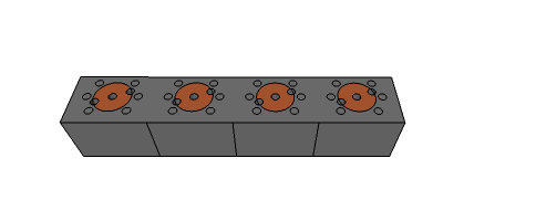

    I need to drill 4 x 28mm holes through aluminium to make ballscrew nut mounts.... from 1-3/4" 44mm square bar.
    Does anybody have any tips for doing this?
    I'm thinking of using a good quality bi-metal holesaw.... Irwin/Bosch... at 545 rpm in the bench drill press... Drilling a 6mm pilot hole first... and possibly drilling two 6mm holes at opposing ends of the diameter to help with clearing chips.
    Sure I would have to tackle the bar from both sides, but have no idea whether I would be fighting a losing battle, or whether cutting fluid would help keep the tool cool or have the opposite effect by making the chips gum up?

  2. A hole saw will do it. but accuracy wont be great. A straight shanked boring head would be better if you can get a small one with a 12mm arbor to fit in the chuck. Theres no need to drill any holes other than the pilot hole..
    Cutting fluid will help in either case... compressed air also works
    Or ask someone nicely... hobnobs and/or beer often work ;)
    This would be a nice little lathe job for anyone with a 4 jaw chuck and boring bar.

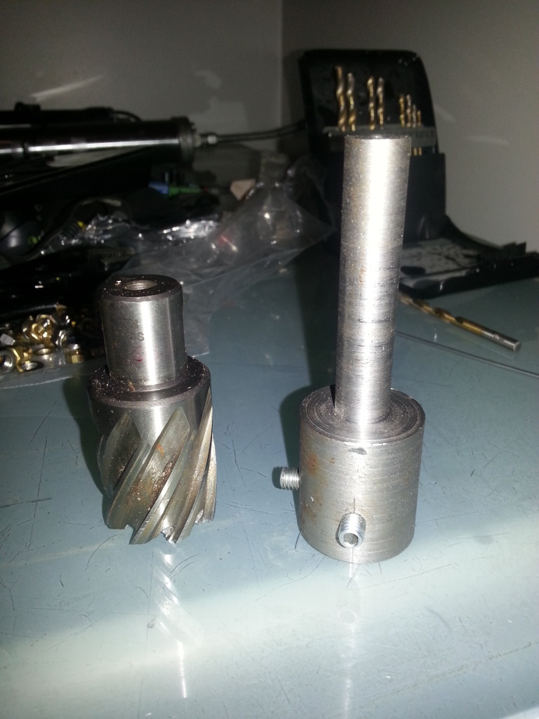

    I used an annular cutter with an adapter for it to fit the pillar chuck. Worked great. Or, you can buy a morse taper one for them.
    Didn't know those existed and it looks like they will clear the swarf quite well. What does the adapter you used look like/where can they be bought?
    Quote Originally Posted by WandrinAndy View Post
    They go through ali like butter. Ive seen the adapters on ebay before, or you can make one like mine on a lathe for nothing.
