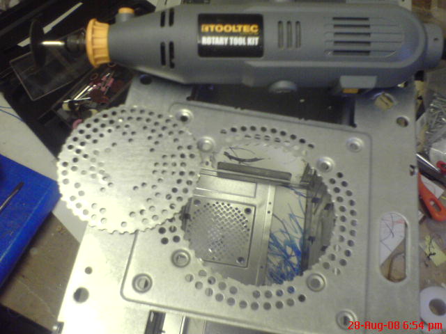

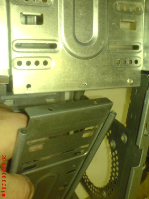

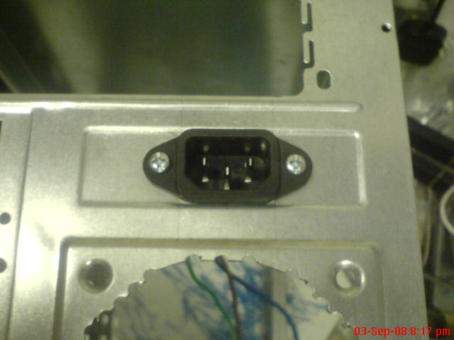

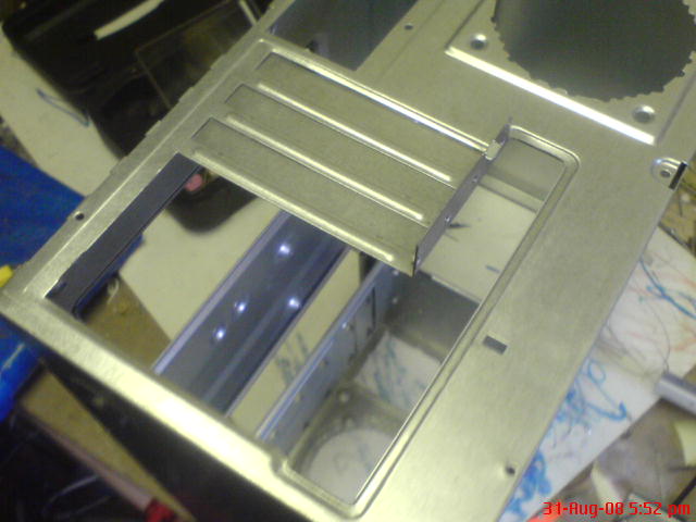

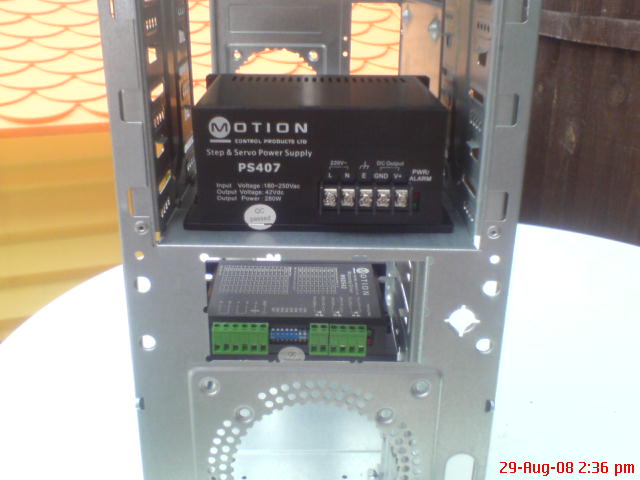

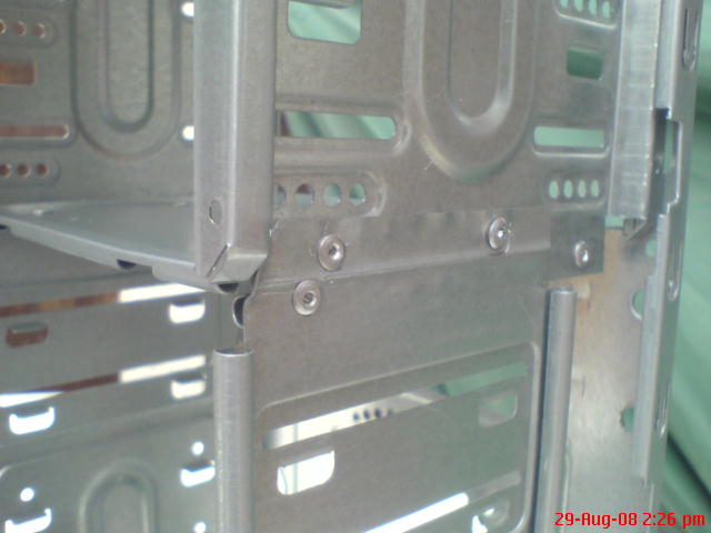

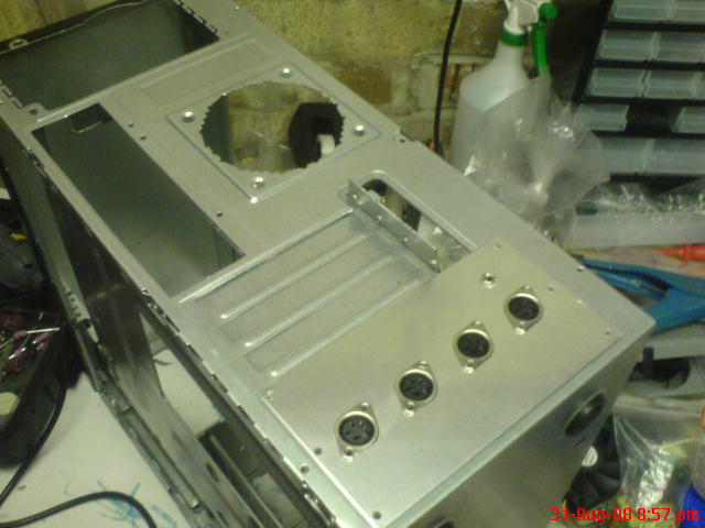

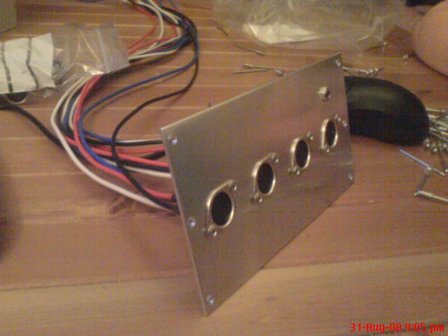

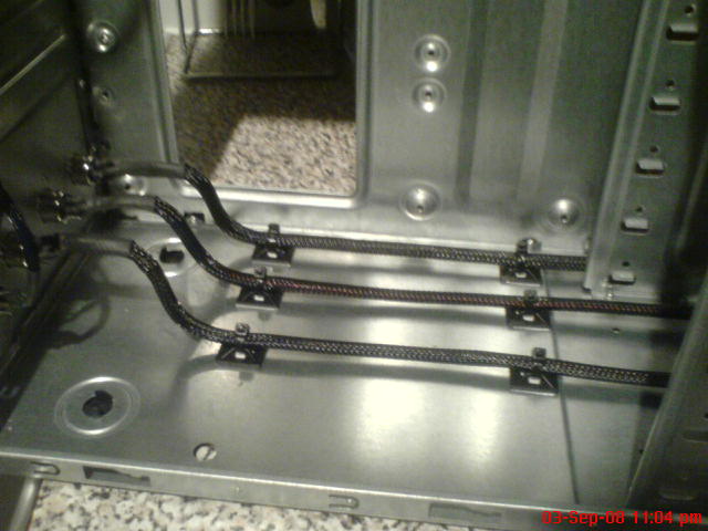

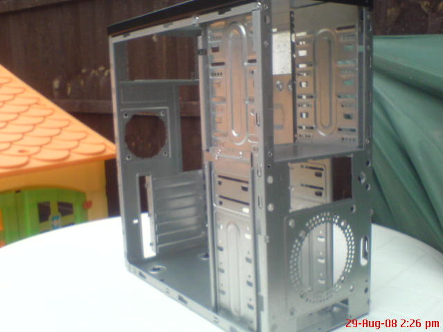

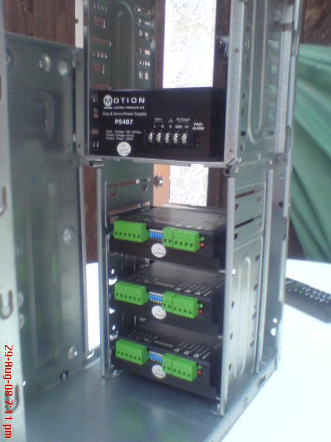

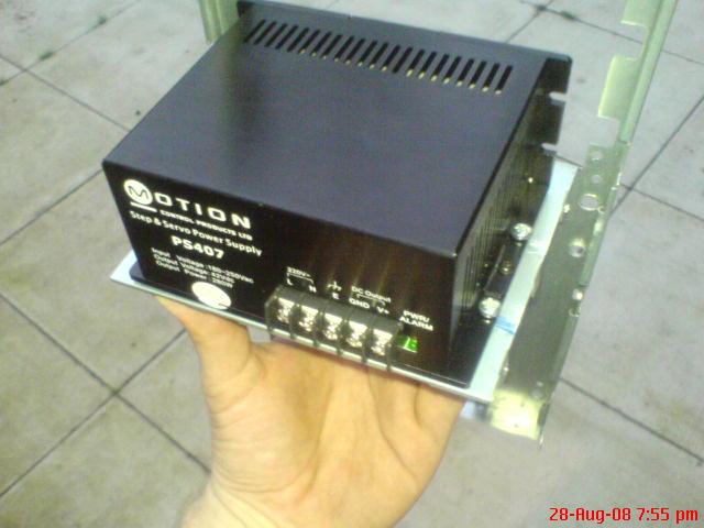

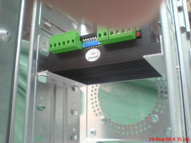

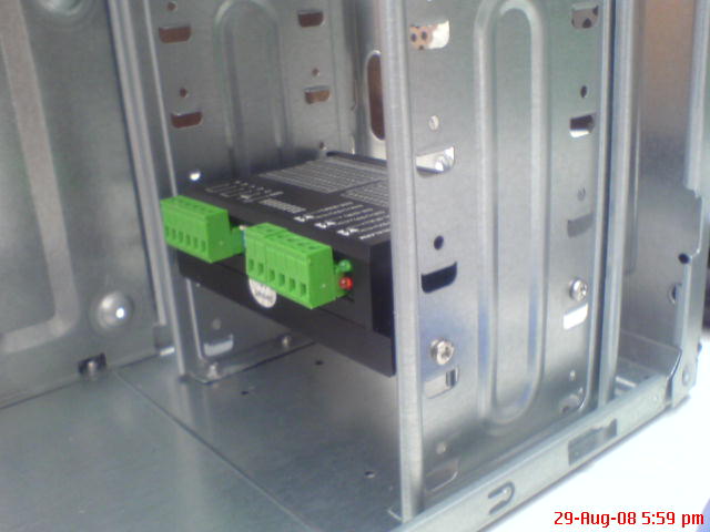

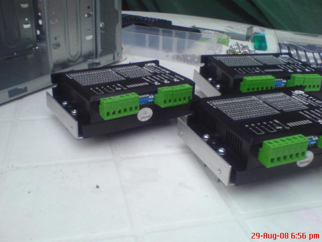

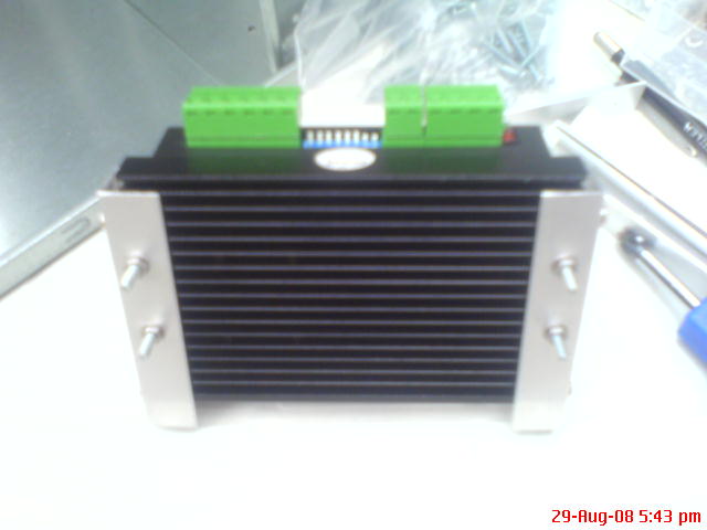

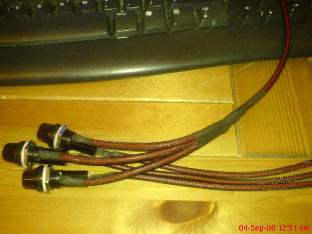

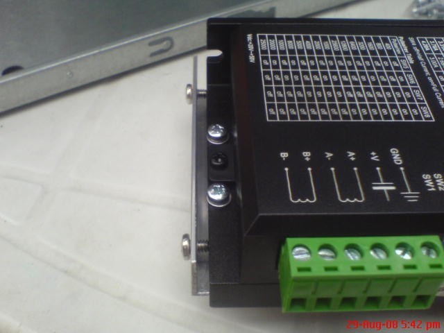

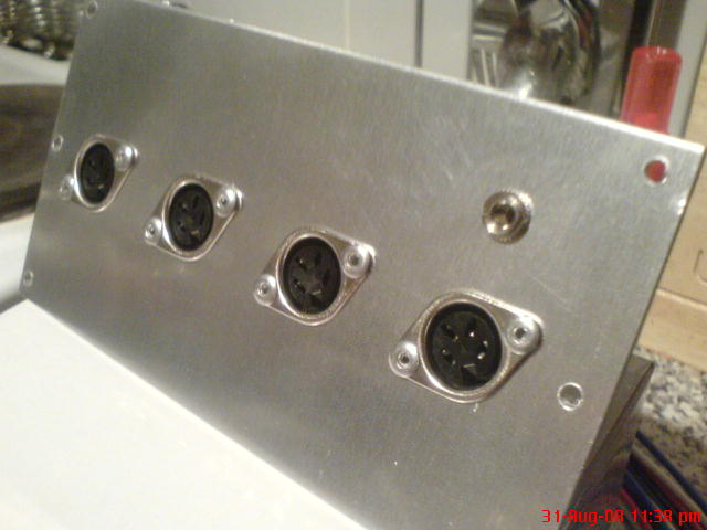

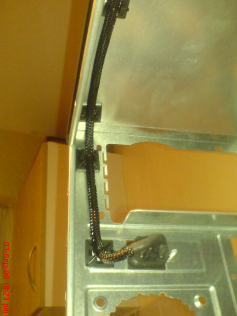

    I can’t see this being a problem, more so if you use shielded cables. I would try and keep the cable runs as clear as you can; I would maybe look to keep the rack under the cnc with the other stuff though.
    I did a build in a pc case and had everything in that enclosure, including the pc stuff without shielded cables and didn’t have any problems. I know others have done this as well, I’m currently working on an enclosure for the same again featuring an Atom based system so hoping all will go well with that, I cant actually recall anyone having an issues with the PC next to the drivers and so on but I think it does happen for some, may have to try it and see.
    .Me

    Thanks Lee,
    Sounds like my rack may be housing more than servers now and save me some workshop real estate.
    Good idea on using drive enclosures for your stepper drivers. I have some of those spare, so will be "borrowing" that idea :-)
    I guess the interference problems people experience (steppers skipping etc) come from the VFD and its cables being in the same cable run as poor quality unshielded stepper cables - Tesla vs Edison again? ;)
    Chris
    Hey,
    Sorry didnt mean to post so many pics...i should have thought about it, the only problem i had doing it that way was the 542's are a little wider than a hard drive and as luck would have it the side of the rom bay lined up nicely with where the side of the hd bay needed to be. I did have a 4u nocking about i could have used and i did strip it down ready to start hacking it up but it was old and grey/cream and a new tower was only £20 and looked a better option at the time. I did plan to put the fuse holders, l.e.d extensions for the drivers and so on in the front bay panels but i nver really got that far, the case and bits are still sat on a shelf collecting dust.
    I just used some ali angle for the side plates the drivers sit on, looked cool i guess.
    Re the VFD cables, i've not got one or any experience using one so cant really comment sorry.
    .Me
