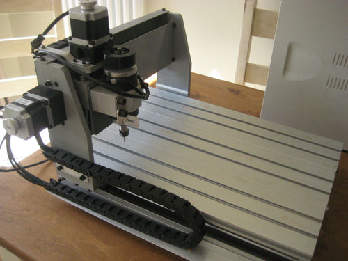

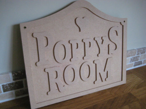

    I saw this tonight on ebay , you may get a bargain but it looks like the kind of think for doing the mdf .. wood letters
    CNC ROUTER / MILLING MACHINE / ENGRAVER | eBay
    Hope it helps sorry if I'm way off :)

    I think you should seriously consider a machine big enough to cut a reasonable number of letters from one sheet since, unless cutting letters from identically sized pieces is the sole purpose of the machine (in which case you use a jig to speed up the process), you could well find set-up time to be greater than the time taken to actually cut the part.
