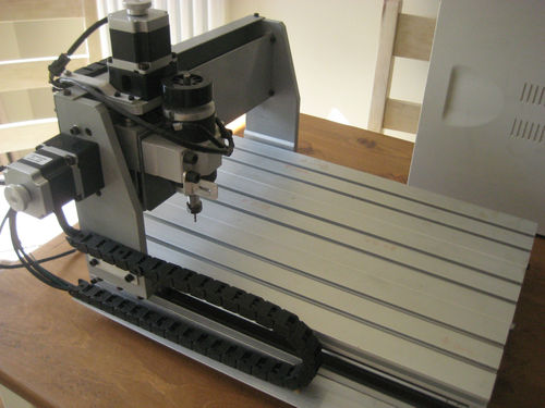

    I saw this tonight on ebay , you may get a bargain but it looks like the kind of think for doing the mdf .. wood letters
    CNC ROUTER / MILLING MACHINE / ENGRAVER | eBay

    Hope it helps sorry if I'm way off :)

    I think you should seriously consider a machine big enough to cut a reasonable number of letters from one sheet since, unless cutting letters from identically sized pieces is the sole purpose of the machine (in which case you use a jig to speed up the process), you could well find set-up time to be greater than the time taken to actually cut the part.

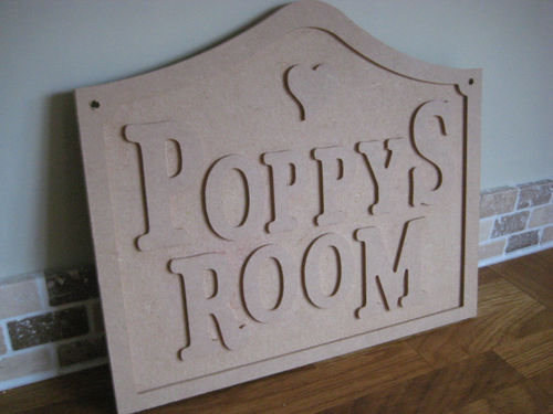

    Thankyou for all your replies, in order to answer a few point, i would definately want the bigger work space doing one letter a time would take a long time i fear.
    i will mainly be cutting MDF wood but possibly up to 18" for free stading letters, obviosusly if i have a machine capable of other woods i would look to use them, bt this is not a top priority on things i would like.
    then it comes to cutting speed, up to 20 mins per letter is quite long, i would obviously like something quicker if i can, the picture than was put for an item on ebay looks like it would do a good job for me, only the working area is very small, this may have to be my compromise to stop having to pay silly money.
    with all that taken into account, roughly how much am i looking at needing to save up, my business turnover is around 5k net profit per year (it would certainly be more if i wasnt restrictied im sure) i could fork out 3-4 grand at hthe end of hte tax year if i had to, to get something i want but then i have to look at how long it would take for me to recoup that money...a long time i would think
