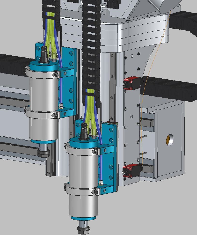

    Oh. It's going to have two spindles.

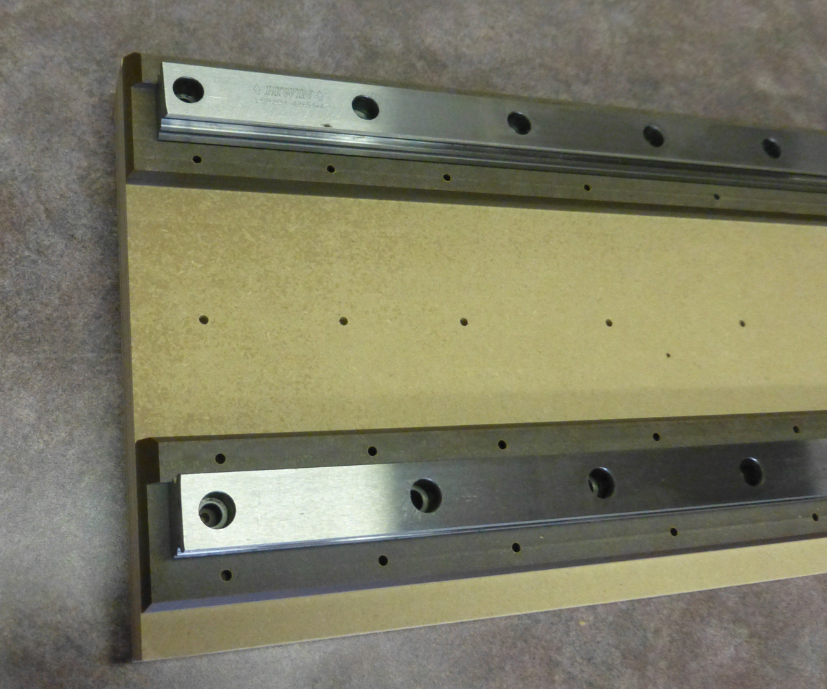

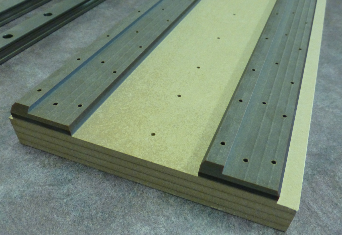

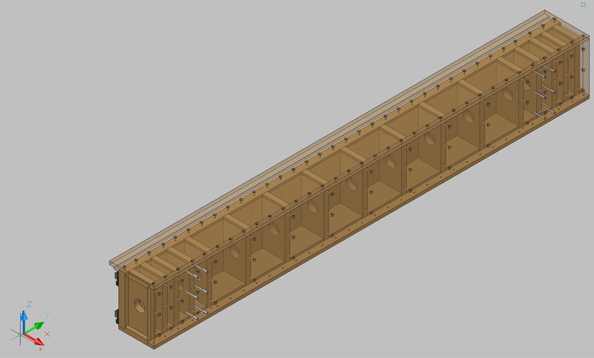

    Today I cut the parts for my gantry beam. It's about 1700mm long, made of MDF. Front and back of the beam are 1" thick, made up of a lamination of 4 layers of 1/4", glued with plastic resin glue in a vacuum press. Phenolic mounting pads for the linear rails were epoxied on.
    My day job is in a cabinet shop, so I have access to a 5x12 Morbidelli router. This is what I ended up with. Sorry if this is off topic. If anyone's interested, I've been documenting the evolving design at CNC Zone for the last 5 years.
