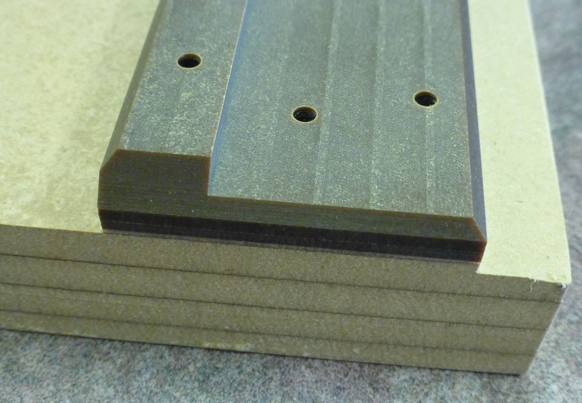

    Building a high quality wood machine requires some high tech construction techniques (IMO). Anywhere that metal parts are fastened to wood, I have aluminum or phenolic "mounting pads". This keeps the wood from being crushed and maintains precision.
    Most of the wood parts I use are made up of laminations to increase rigidity and stability. In addition, everything is sealed in epoxy to minimize moisture absorption, and subsequent movement. Whenever possible, torsion box construction is employed to again maximize strength and stability.
    I am using some aluminum for mounting the linear bearing blocks, but in some cases it's bonded to baltic birch plywood, which let's me use thinner panels.

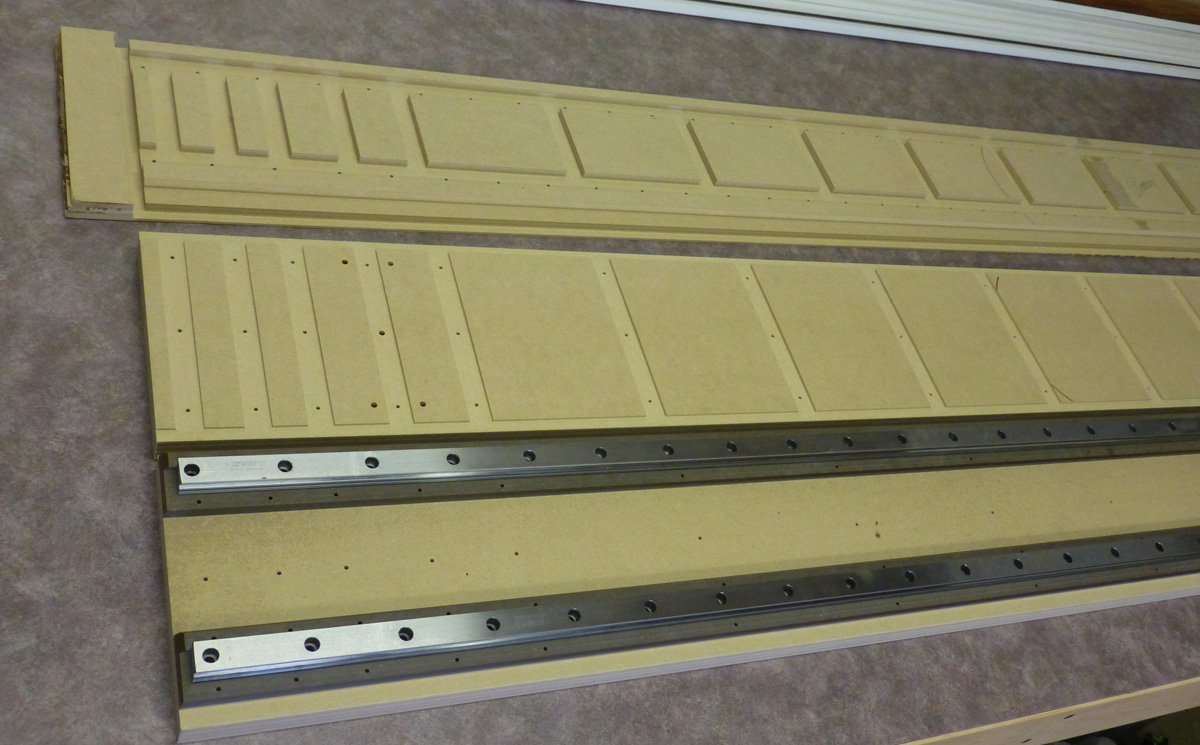

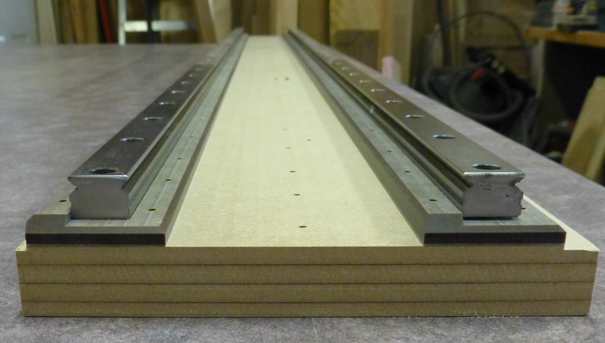

    Today I cut the parts for my gantry beam. It's about 1700mm long, made of MDF. Front and back of the beam are 1" thick, made up of a lamination of 4 layers of 1/4", glued with plastic resin glue in a vacuum press. Phenolic mounting pads for the linear rails were epoxied on.
    My day job is in a cabinet shop, so I have access to a 5x12 Morbidelli router. This is what I ended up with. Sorry if this is off topic. If anyone's interested, I've been documenting the evolving design at CNC Zone for the last 5 years.
