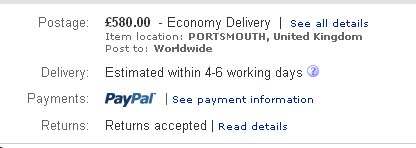

  4. John,
    Quite expensive delivery(£580) taking in account it is located in Portsmouth

    Already spotted this but it's just a way to keep Ebay fees down. Plus side is they are in the country so no getting hit for VAT or import fees on top of what you pay. Regardless they are all roughly the same price, the Chinese based ones could be a tad cheaper but extra delivery time, unknown fees could soon even this up.

  6. Quote Originally Posted by John S View Post
    You're right, you pay fee from the value of goods not from delivery costs. Clever
    Next time I'll try to sell something for £0.99 and charge £500 for collection costs
