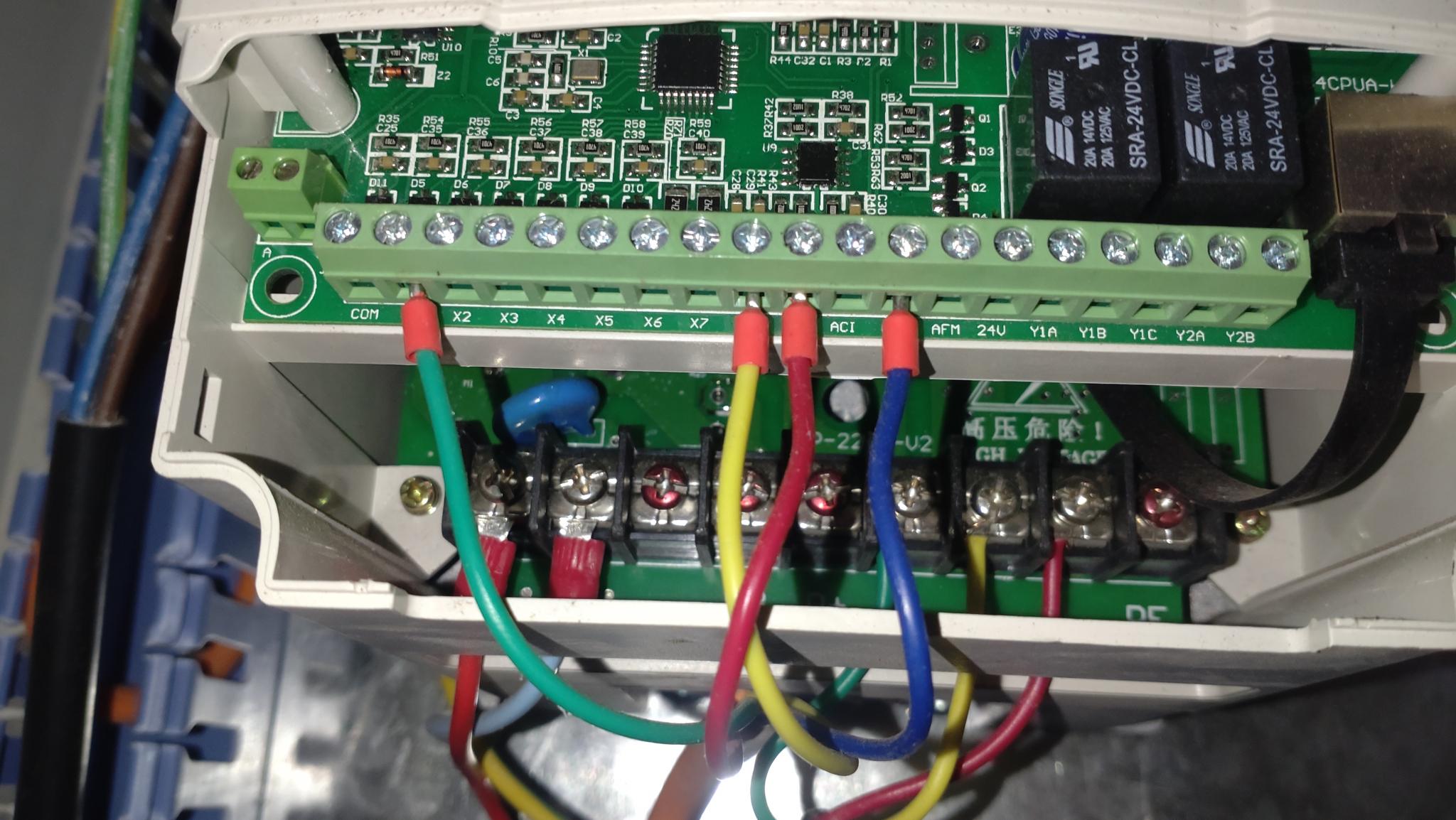

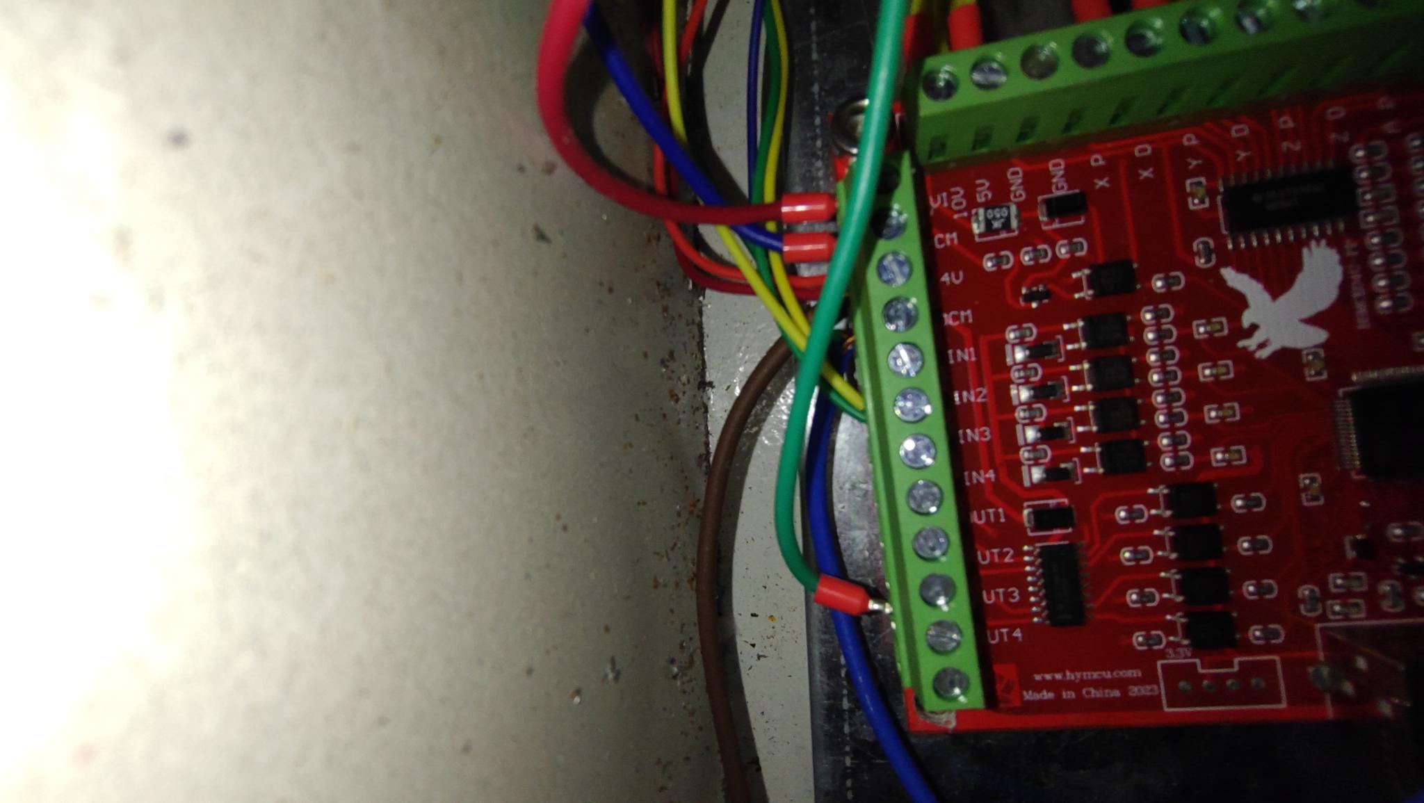

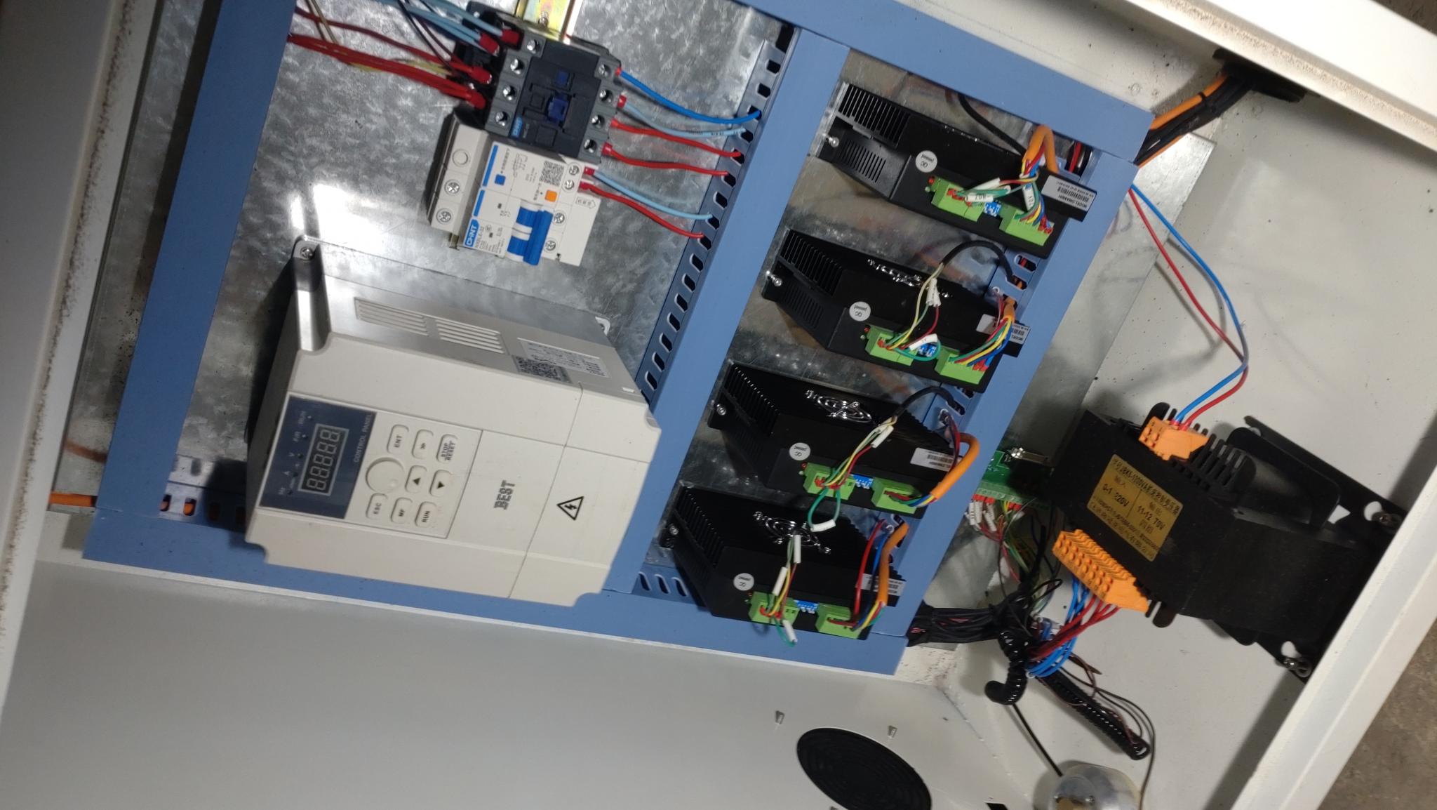

    Hi guys,
    I've taken the advise of m_c and added an USB controlled breakout board and an extra 24VDC power supply.
    Tried to hook it up and got the drivers and limit sensors working, however the spindle doesn't seem to respond in Mach3.
    The Chinese VFD leaves me puzzled as the only manual I can find is not for this model (FC300-4.0G-S2-B4C).
    I'm hoping someone on here can shed some light on how to connect it to control the speed in Mach3.

    Lives in East Lothian, United Kingdom. Last Activity: 6 Hours Ago Forum Superstar, has done so much to help others, they deserve a medal. Has a total post count of 2,994. Received thanks 376 times, giving thanks to others 9 times.
    What are the terminal numbers on the VFD that the wires are connected to?
    Green will be X1, which is an input, and I'd guess is used to switch the spindle on.
    What are Yellow, Red, and Blue terminals?
    Can you post a photo of the complete controller that you have fitted, or a link to where you bought it from?
