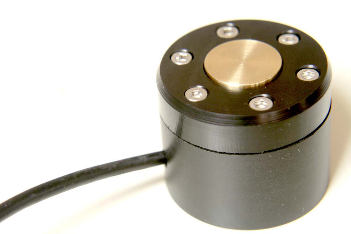

    After reading Hilton Steve's post on his tool hight probe and how useful it was i thought id give it a go.
    As i am a tad paranoid about driving my tool straight through the probe I also thought I would add a couple of E-Stop switches in parallel under the spring loaded contact
Name:	tool hight 1.jpg
    looks posh :)

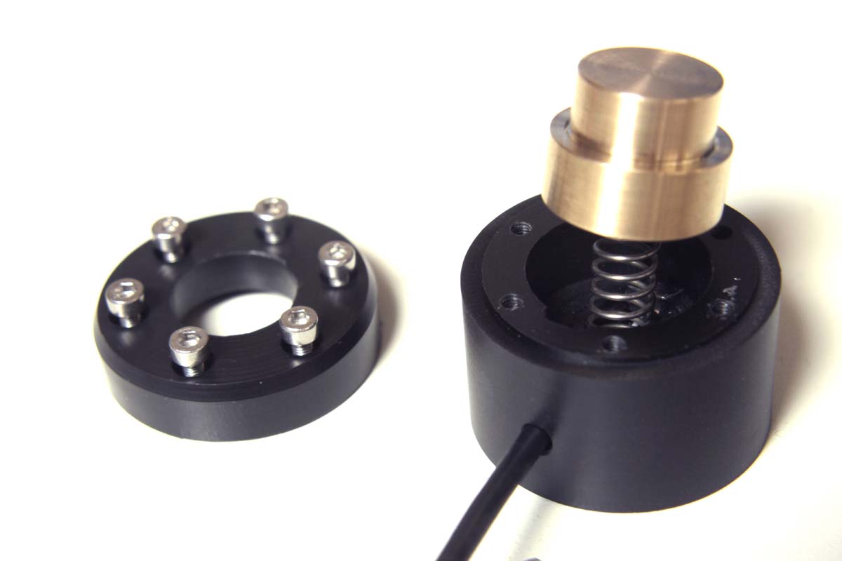

Name:	tool hight 2.jpg
    simple :)

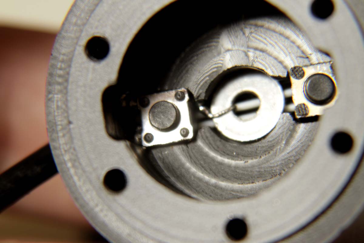

Name:	tool hight 3.jpg
    should have grabbed a sharper tool :(

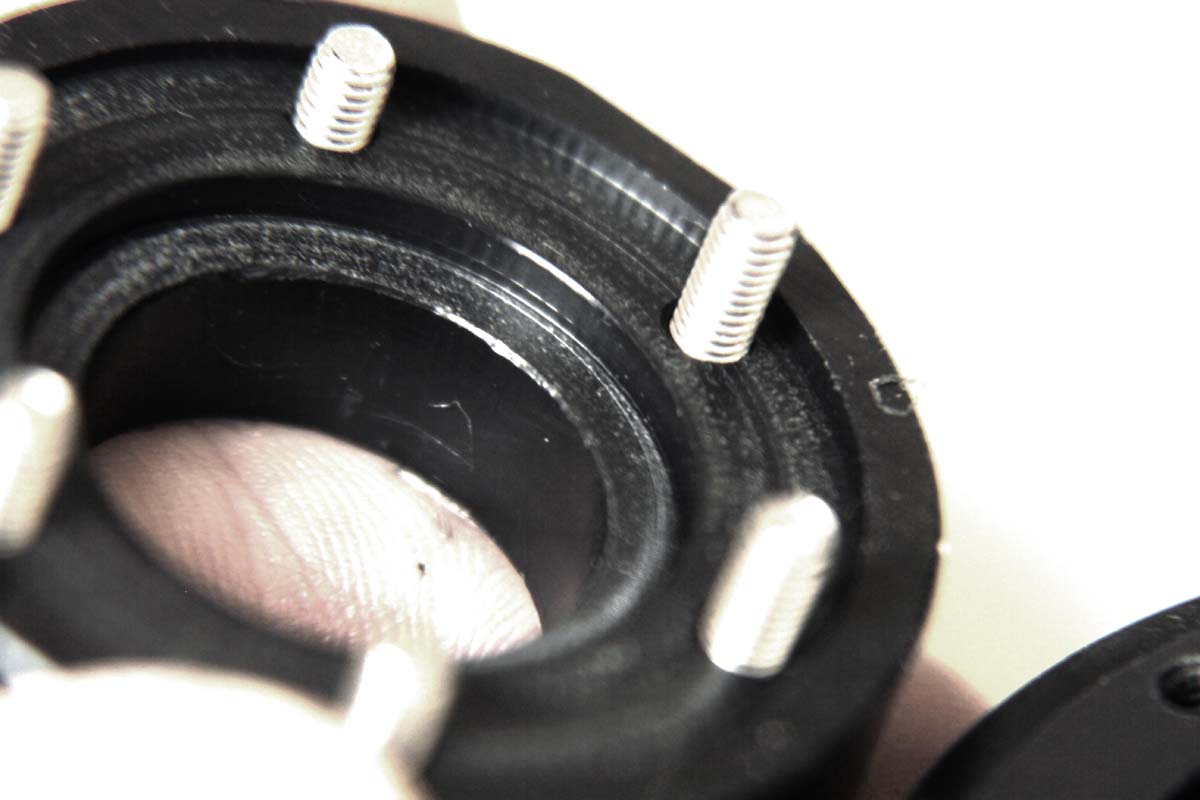

Name:	tool hight 4.jpg
    the switches run straight back to my bob E-stop (iv not wired it up yet, ill feel much better when I do)... the washer makes contact to the brass contact through the spring
    this could be made much lower profile as its a bit tall... i may have to have another go at this but for now ill see how we get on :)
