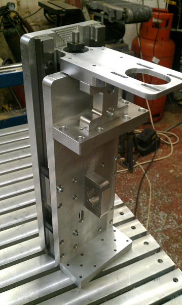

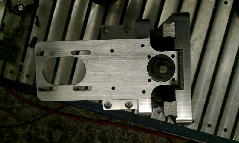

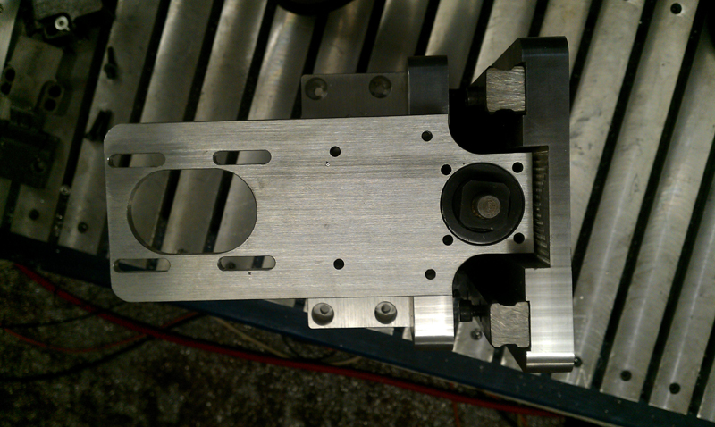

    Building a decent Z axis isn't difficult but there are a few things which are best done in a certain way. If you can afford profiled rails then I suggest you do because they are so much better and neater thou supported rails can work very well.
    Basicly have the rails mounted on the front plate and the bearings on the rear, this helps support the front plate and gives a variable stiffness according to extension.
    Don't scrimp on plate thickness, 19mm is min I'd use.
    Use the belt setup like you describe it helps with resonance.
    Use 5mm pitch screw not 10mm.
    There are many examples on the forum but here's one shown many times. Click image for larger version.

    Right, Jazz, Your photos have thrown a real spanner in the works and given me a headache. I know im on the right path now with regards to the rails, but as for the design of the Z im lost. I can see your design as being a good way forward, but i just cant get a perseption in my head on how i can transpose this into my design.
    I think my real problem is working out the vertical spacing of the pillow blocks on the rear plate & the length of the front plate and rails to get the spindle down to the table and to have roughly 100mm between the gantry at its lowest point in Z when the tool is raised, and the table. With the chinese spindle mount i know its adjustable to some degree but I just have no idea at this time writing this which is why I Think ill take some real time to come up with something.
