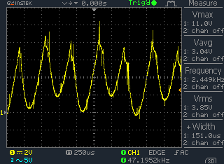

    I just put an ammeter on my 500VA PSU and ran a few programs on the router. With 4 motors maximum current was 2.66A and at standstill 0.72A. Just going by eye (not great I know, should use my oscilloscope) the mean current looked to be about 1.9A. The drivers are set to 50% current at standstill, so since the power supply is outputting 68V we expect the current current when stationary for 4 motors to be 4*0.5*2.73*4.2/68*2=0.674A, so the measurement is fairly close.
    So lets be very safe and calculate it with the peak current since we know if the temperature is fine at that current (2.66A) it must be fine for the lower current when running. The 8A rectifier I used is 2.2°C/W junction to case and forward voltage is 1V, so 2.66*1=2.66W to dissipate. (150-25)/2.2=68°C/W which is a large value, hence why it works with no heatsink. Also the datasheet specifies up to 3.2A with no heatsink, so clearly we're fine especially as in reality the mean current for 3 motors is less than 2.66A.
    Edit: Just tried measuring using the oscilloscope with a shunt resistor and running one motor at the speed it draws the highest current I get 1.58A mean, so 4.75A for 3 motors which implies if I get all 4 motors running at their peak, it will draw 430W from the 500VA transformer.

    Here's a graph to brighten things up:
    (0.47 ohm shunt resistor and one motor going at speed which obtains the highest current)
