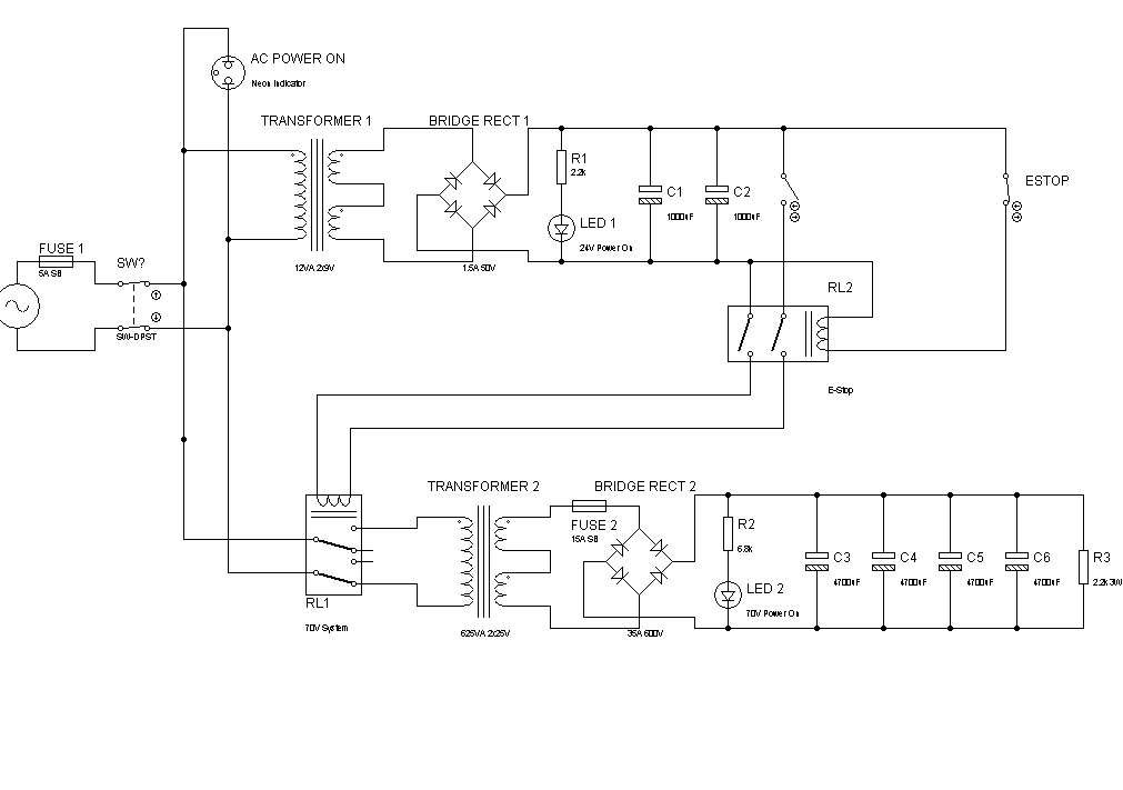

    Here's the plan - listing is indicative of order, should roughly correlate to this:

    It's a little rough, I rushed it for the post. You might need to pretend there is a relay-controlled bleeder. And you might need to pretend there are any outputs to the rest of the world, but hey, that's the power of i-m-a-g-i-n-a-t-i-o-n!
    Fused IEC Chassis Plug (23-0360) with 5A slow-blow fuse (20-1072)
    High Current Toggle Switch DPST (on/off) rated 250VAC@10A/12VDC@20A (75-0253)
    Splits out to
    - 12mm 240V Green Neon indicator (42-0330)
    - 24v system
    - 70V system (via relay)
    - potentially other systems, ie BoB etc.
    24VDC System (well, 23-ishV)
    Transformer: PCB transformer 230V 12VA 2x9V (88-3877)
    Bridge Rectifier: Woo5 1.5A 50V Bridge Rectifier (47-3190)
    Indicator: LED to be determined (probably have something suitable upstairs)
    Smoothing Cap(s): 2000uF according to my magic spreadsheet, so 2 x 1000uf 63v Caps
    Bleed Resistor: Not needed, but otherwise I worked it out as 3.5kOhms 1W
    Toggle switch 24V for turning on 70V system
    70VDC System
    Relay: 24VDC 4PDT, rated 240VC@7A (60-1310)
    Transformer: Well this is annoying, see below.
    Fuse: Slowblow 15A in fuse holder
    Bridge Rectifier: 35A 600V Bridge Rectifier (42-3228)
    Smoothing Cap(s): 4 x 4,700uF 100V caps (11-2912)
    Bleed Resistor: I work this out as a 5 second bleed = 2 kOhm 3W, controlled by a relay wired NC.
    Transformer for 70V system - Rapid has 500VA 2x50V transformers which should give me 50VDC@10A in parallel. I'd prefer 625VA but they don't carry 2x25 and the 2x50 has a 1-2 month wait from order. As I'll be sourcing this component last I have time to hunt around. A few other links to sources were posted in the thread; I'll check up on them later.
    The wires to the relay that turns on the 70V will pass through another, normally open relay. This second relay is powered
    Various crimps, wire and connectors should be easily sourceable at the local shop.
    If I don't post for a month, my widow will probably be selling my stuff on ebay so keep an eye out for some bargains - she might be selling it for what I told her it cost before I got turned into crispy bacon...

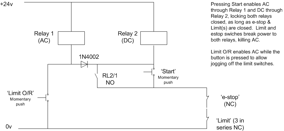

  7. For safety reasons don't use a toggle switch for the 'start' switch on the 24v supply to relay 1. It must be a momentary push to make to enable both relays and use a contact on relay 2 to lock it in, as I drew it.
    Why? your machine hits a limit switch, triggering estop (or you hit estop). everything turns off. You turn off the power at the main isolator but in your desire to see what happened you forget to turn off the 'start' switch. You reset the estop, or move the machine off the limit switch and turn on the main isolator... but the start switch is still closed so the 70v rail comes up and the machine starts moving again because you forgot to stop the PC...
    Its a safety interlock, it mustn't remain in an ON position. Also you don't need both contact on Relay 2 to drive Relay 1, only one side of the coil needs to be switched.

  9. #59
    Ahhh. The reason why I basically re-drew your drawing was to get my head around what was happening. Now you put it like that I can see what is happening there. I guess I should have asked. It's not like it's the first daft question I've had :)
    I know, but I wasn't using those poles for anything else at the time and it looked untidy. I was envisaging the second poles driving a relay that disconnects the bleed resistor when the system is running.

  10. An easy way to provide the limit override (non-locking) and start (locking) logic is with a diode:

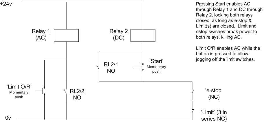

    An alternative would be to use a seperate contact on Relay 2 to enable Relay 1, but I prefer to keep contacts free for use.
