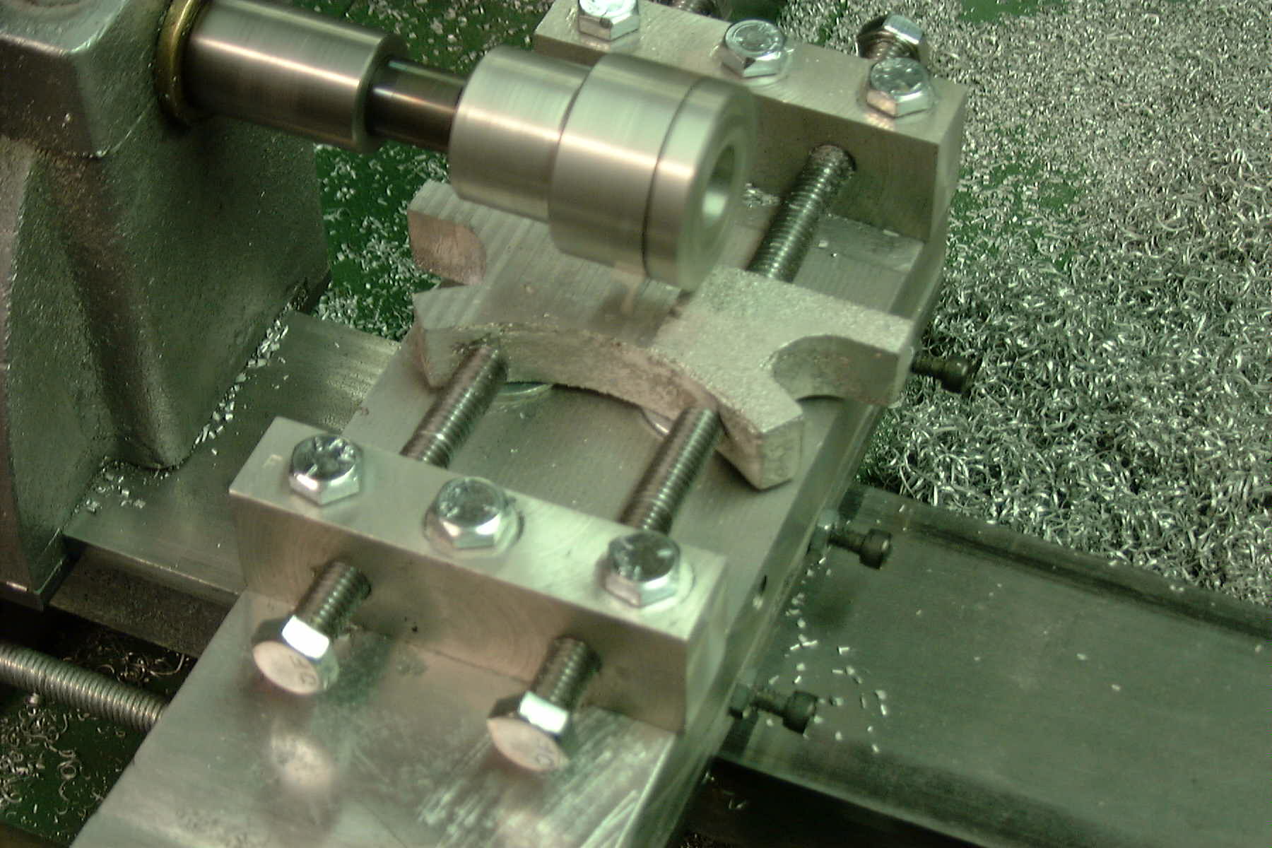

    Thanks very much. Here are a few pictures of projects and processes I've used while casting.

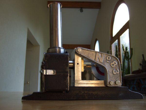

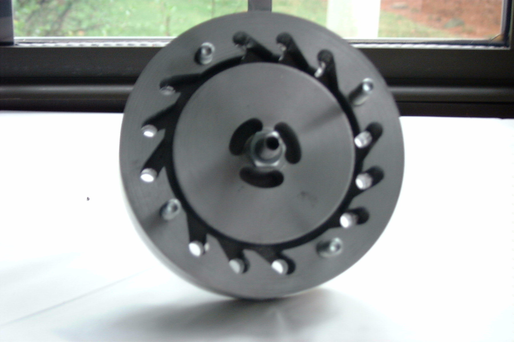

    They are, in order, 1. a Gingery lathe with tooling and patterns, 2. a milling attachment that enabled me to cut rotary slots on a Tesla turbine disk, 3. a typical drag with greensand ready for casting several parts in one pour, 4. the milling attachment used as a horizontal mill with a homemade cast flycutter -- here facing a casting, 5. a Tesla disk style compressor stage -- disks and housing are all machined castings, 6. a Stirling engine I made for my father's 83rd birthday as a gift.

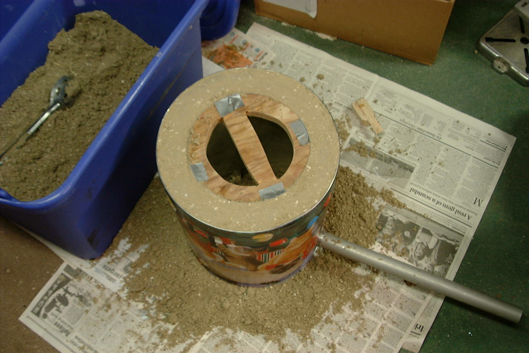

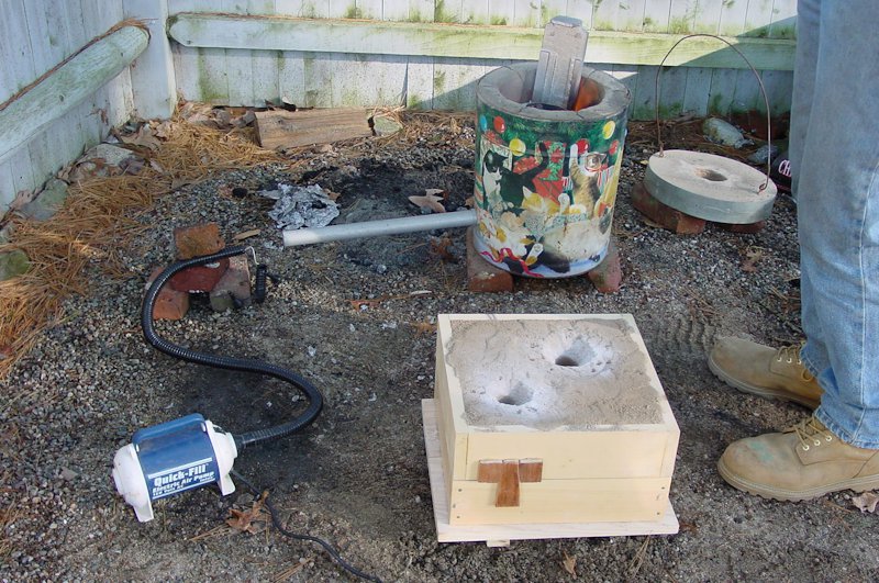

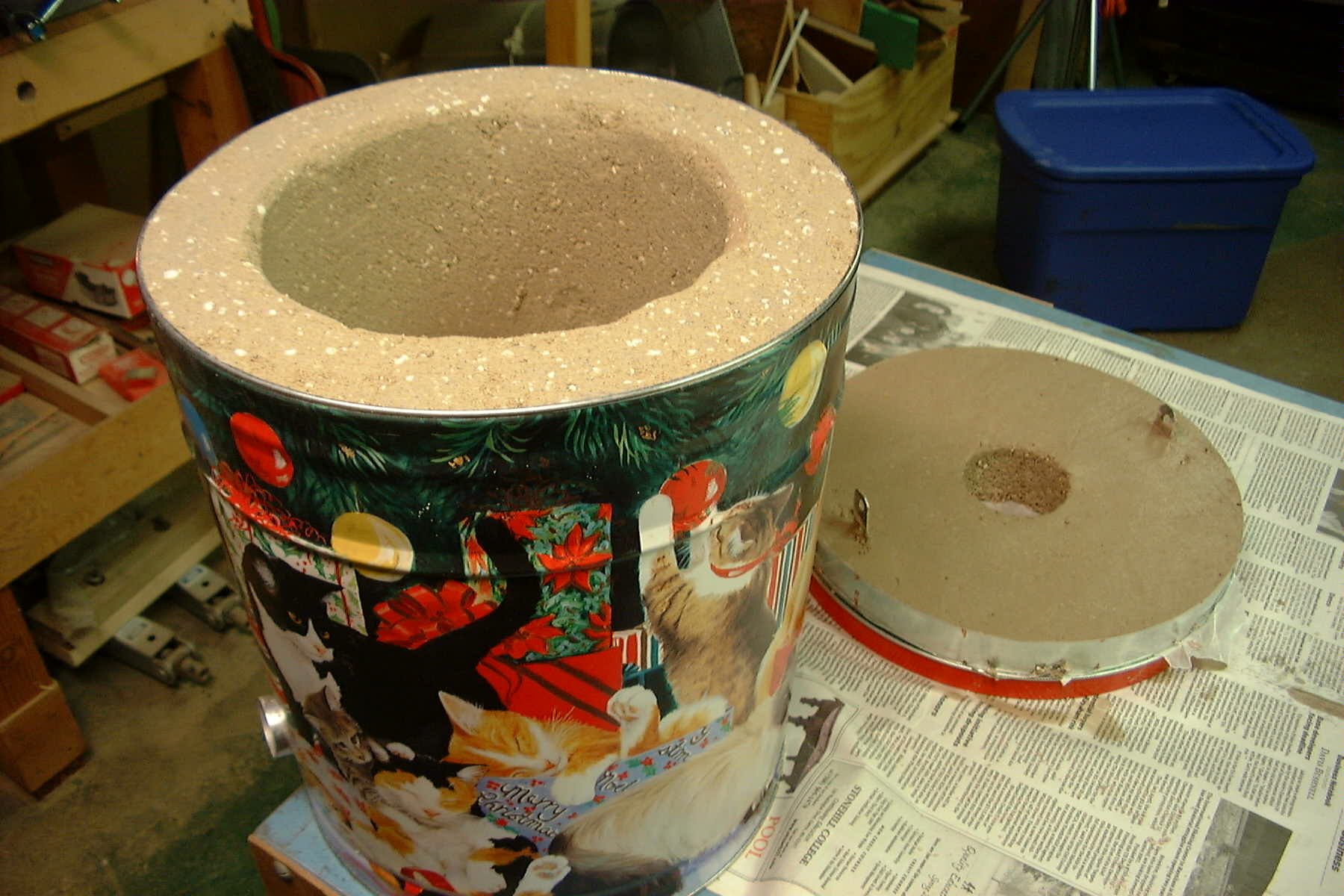

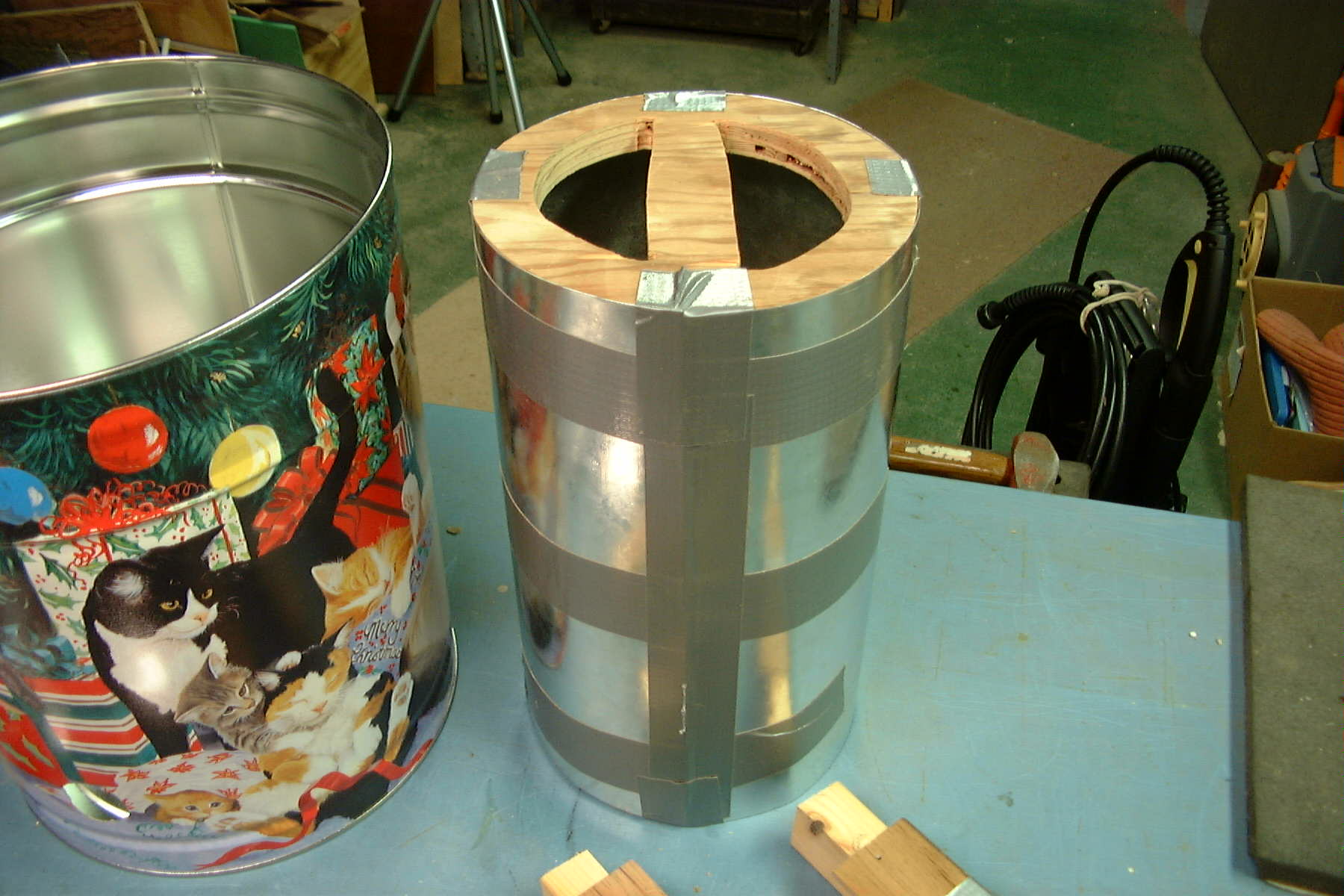

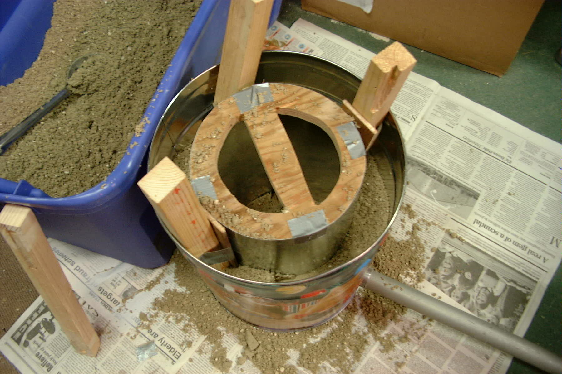

    Irving, I originally built a popcorn can furnace using , well, a popcorn can (popular here around Christmas -- roughly 20L in size thin sheet metal and painted with a seasonal scene -- and containing stale popcorn.)
    Lined with sand and clay mix and rammed -- all according to David Gingery's little books. Used an air mattress inflator as a blower. Loaded it with charcoal briquets, and proceeded to melt metal.
    I later found that even a fire of fallen pine boughs we cleared up after a stormcould melt aluminum, even without a furnace or furnace blower.

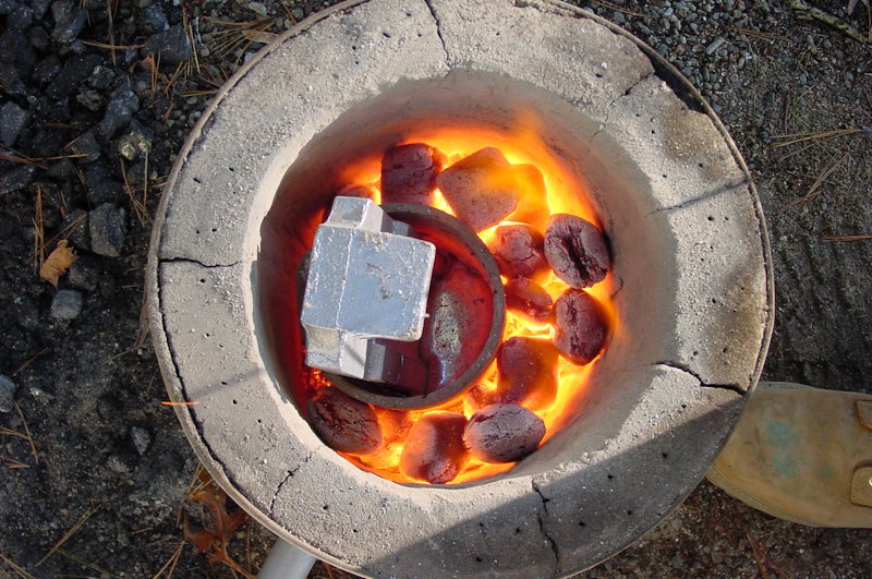

    After nearly ten years my original furnace gave out, so lately I have just piled up fire bricks into what looks like a 1 foot tall chimney on the ground. Used a running bond but no mortar, stuck a pipe in the bottom for the blower, loaded it with briquets and again was melting metal.
    So it really doesn't take anything very sophisticated, though building a nice furnace is still very satisfying to do. I guess we all like a nice piece of shop equipment!
    I saw one once where someone used an old gas cylinder cut in half with a hairdryer for the blower that was really effective. Really want to have a bash one day.

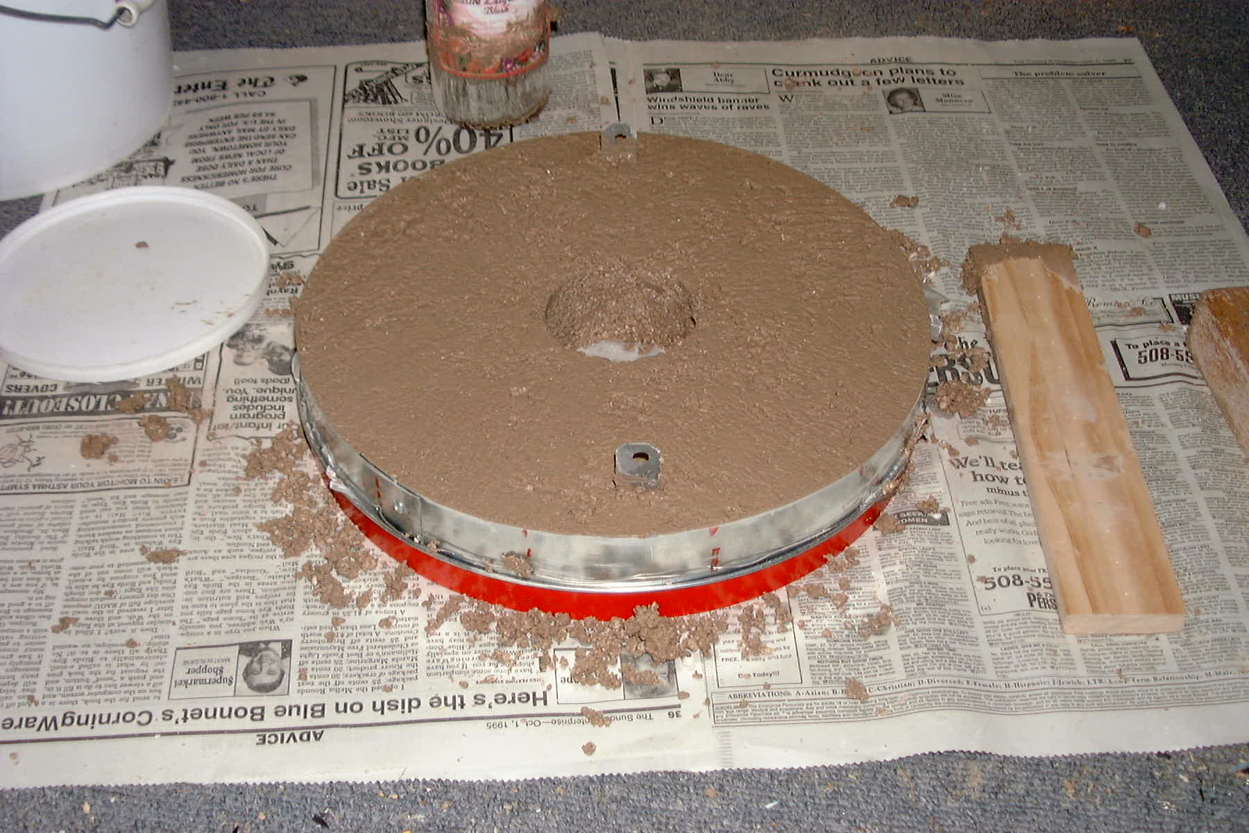

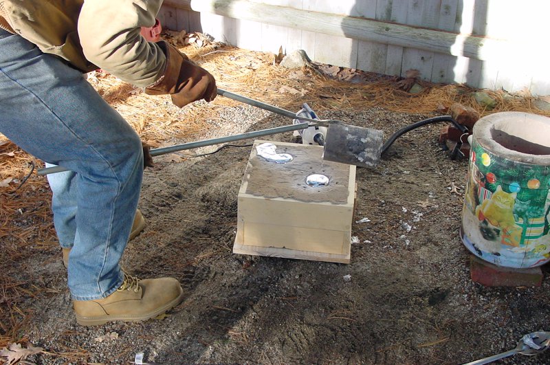

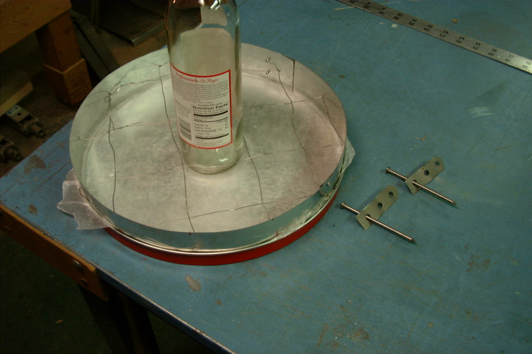

    Okay guys, here are a few photos of the foundry construction, melting setup, and pouring.
    1.) Popcorn can and inner form
    2.) Lid reinforcing wire and vent form
    3.) Lid filled with refractory
    4.) Filling and ramming the furnace body
    5.) Refractory in place -- pipe located for tuyere
    6.) Inner form rempved -- lid has ears for a bail
    7.) The casting setup: blower, cope and drag in place, furnace
    8.) Melting -- here I am re-melting a casting that had a shrink cavity and was rejected
    9.) Pouring
