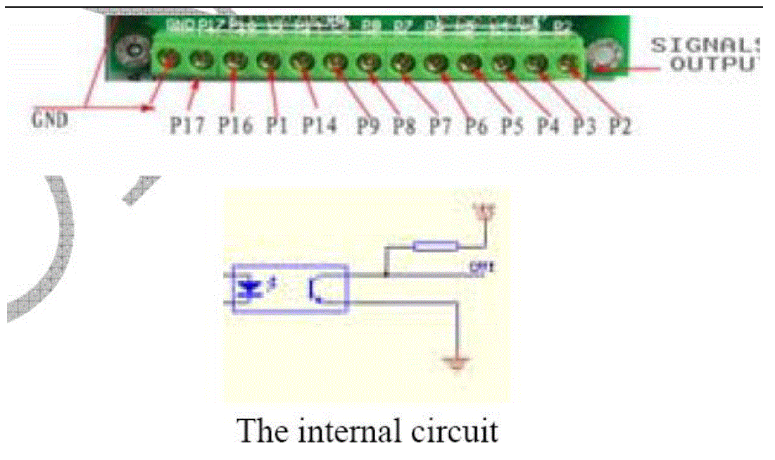

  7. Quote Originally Posted by Peter. View Post
    So from that I gather that whatever voltage I use to power the BOB, that's the signal voltage sent to the drive? Will that BOB linked in post 3 definately run safely off 24v?
    The problem I have with running this BOB at 24v is this:
    The output circuit has a pull up to 'Isolating + supply'. Without knowing the value of that resistor you can't be 100% sure its not going to fry. In the manual it shows 'Isolating Supply +5v'so I would assume they are sized for 5v and not 24v supply...
    They are 1K.
