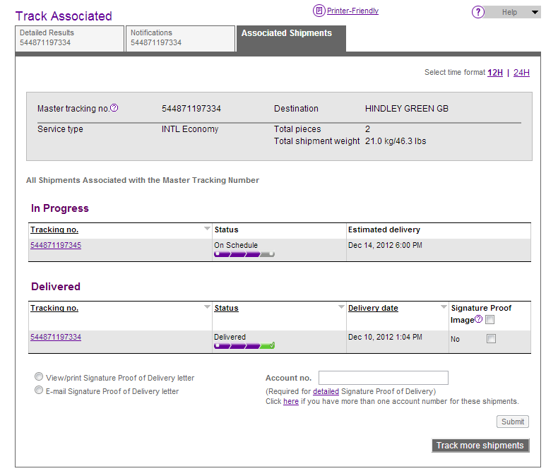

    also just realised there is a tracking number on what they sent me

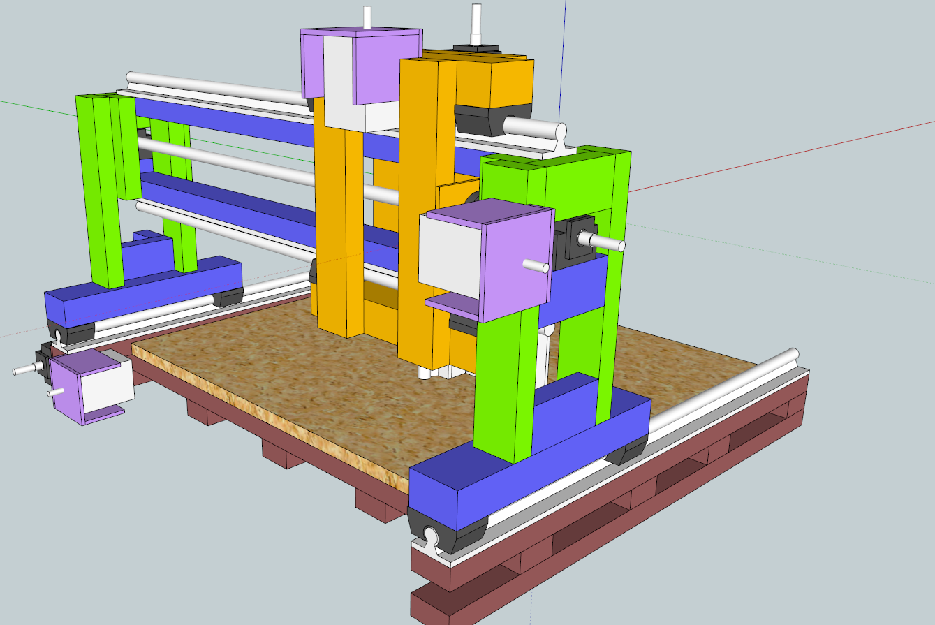

    i've added steppers to my drawing.
    brackets are made up of 5mm steel welded in to shape and i think maybe bolted to the box section, the top of the stepper supports will have slots for tension of the belts.
    i've also beefed up the underside of the bed.

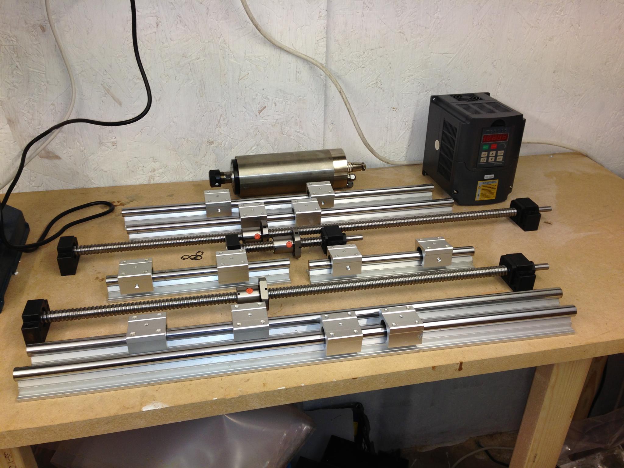

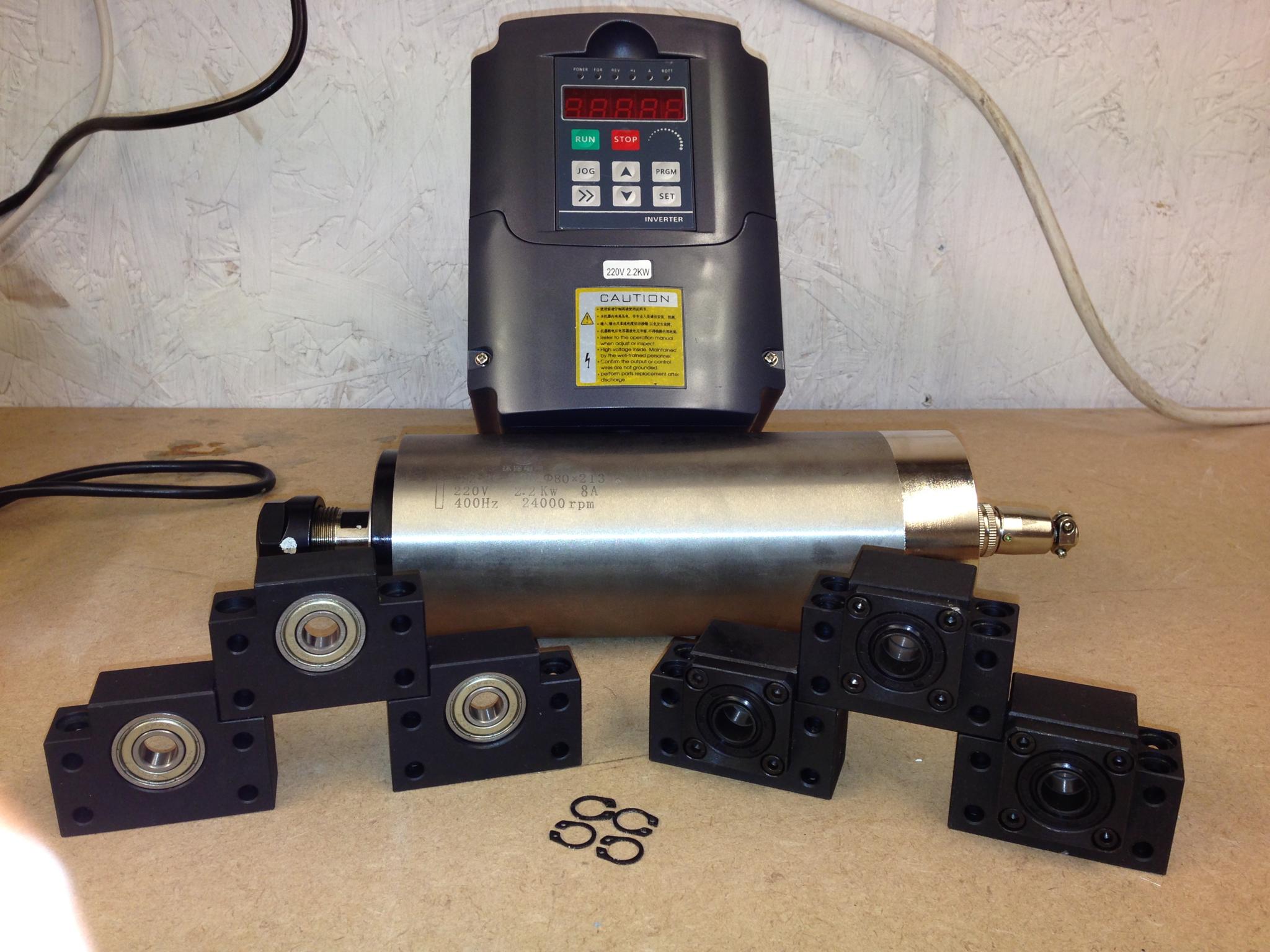

    more goodies as expected the bf/bk blocks did come with the spindle and vfd
    and heres a shot with them all together

  7. #87
    jazz.. you do know my design uses 13+ mtrs of 50 x 25 and another 2.5+ mtr of 60 x 40.... i've a feeling it's massively over engineered
  8. #88
    going to be redesigning this now which is a pain considering i have the rails and screws here today.
    the reason for the redesign is i have been using a drawing of the rail bearings from zapp i think. looked at my rails today and thought they aint 60mm wide.. turns out they are 45 mm wide which means they will fit on a 50mm box section which will help me a lot as i only needed 3m of 60 x 40 and it was proving to be a bigger cost than i wanted.
    so take note guys, make sure you are using the right drawings for your designs before you order
  9. #89
    i fell into that trap aswell.
  10. #90
    you've made me feel so much better knowing it wasnt just me.. i'm acctually quite happy i noticed as i didnt really like having an odd size box section in my build, so now i get to pull the design apart and possibly even gain some cutting area now... the only limit is i need to restrict myself to 2 x 7.6mtr lengths of steel which i think will be a push
