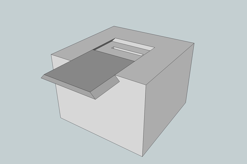

    BTW - I've been looking at mills, trying to find something suitable to cut "dovetails" into an aluminium recess that a bevel edged 3mm plate can slot into - any idea what I would need to do that?
    Chris
    You need a dovetail cutter, but depends how wide/deep the slot is as to what size to buy. Something like this: http://www.ebay.co.uk/itm/16mm-x-45-...-/120938840568
    Perfect irving2008 - exactly what I need - the main block of ali will have a recess made into it 3mm deep and the dovetail will be around the edge of that - the chamfered plate will then slide into that so it is flush to the block surface. That mill will also solve another problem I had which is how to cut adjustment slots for a latch which will be mounted into the sliding plate (the plate itself will have to be a milled shape to make that work). Quick and dirty sketchup to show what I'm on about and thanks for the link:
