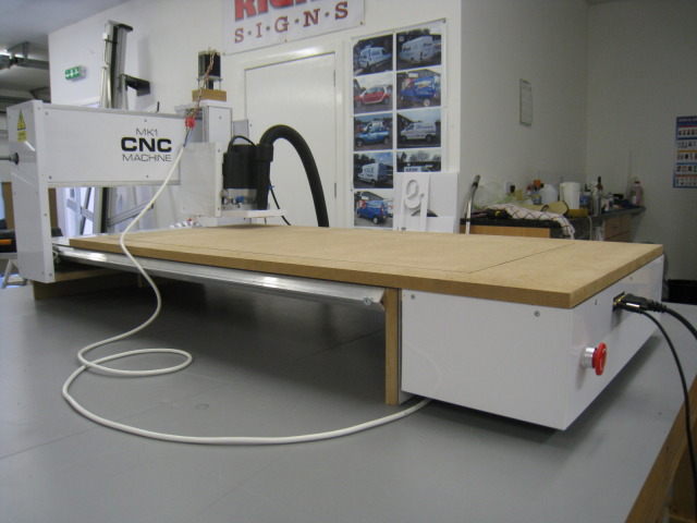

    No problem with low budget here !like I said, scrutinse the one that is already built. If you are completely happy with it, then just build one the same
    The guy that built it is only a 20 min drive from me so I had already been to see him & talk about the machine before I bought the book, one of the reasons I felt this would be a good starting point was that I already had a lot of the materials needed for the construction so the initial cost would be quite low & I could make a start without having to outlay a lot of money. Did have to buy another sheet of MDF as some of the bit's I had were warped but that was down to me not storing them standing correctly. Sheet of 19mm was 14 squid so not a large outlay, have all the fastenings I will need plus the alluminium so I can do a fair bit & see how it goes before spending on more expensive items like electronics.
    This is the actual machine that Phill built.

    That looks very tidy.
    If it works well enough for what you are thinking of using it for, then keep it as is .
    If you want it a bit 'stiffer' then some work to stop the bed sagging, or the gantry risers moving etc would be quite easy and cheap to improve.

    Yes Phill has done a good job with the build & he has already made a couple of modifications of his own to it. He has fitted a Truss rod which he says helps well with the table sagging, he has altered the bearing block a little so he now has a way to make small adjustments which helps to remove the free play & he has fitted a super pid to the router to control spindle speed through mach3.
    As for being able to do the sort of work I would like to do, well Phill has already used his machine for a few Sign related jobs with very good success so if I do happen to get any sign work I could use it for then it should be able to cope, obviously has some major limitations but for a first machine & a way to help learn the software & how to use it I think it should cover my needs very well. Time will tell lol

    what's the cutting area ? don't forget he can cut parts for your machine :)
  6. #16
    Can't remember the overall to be honest. It's a 4' x 2' table & I can remember him saying that max width was in the region of 18" (470mm) so length I am guessing will be somewhere around the 3' 6" mark or about a metre in new money lol.
