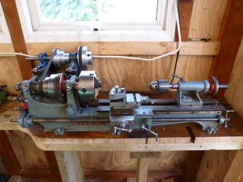

    Hi , I will need a lathe for some parts I'm thinking of doing knobs mainly some very small gears perhaps and the odd 1/16 scale wheel .. i dont want a huge lathe or pay alot if I can help I have seen this one on ebay
    Lathe
    its close to where I live and so not a problem picking it up I've been looking a while and this seems like a good deal so far.. what would you guys pay for it ?
    And I think bidding has two 'd's lol

  2. It's a 1930's Grayson, poss as late as 1940's. The tricky bit about buying an old lathe like that is you have no idea how worn it is. You can expect some backlash in the cross slide and feed screws, and some wear on the bed. If you're lucky the spindle bearings will still be usable. Dont go more than £75 - £100, maybe £150 in really good nick. If you can, go look at it before you buy. Remember you can pick up a good secndhand modern 'Chinese' lathe for £200-£300

    As usual irving sound advice .. what I could really do with is a micro lathe , in all honesty looking at it now it looks a little to big for what I need, but looking at the price of micro lathes on ebay and it’s as expensive or not more expensive to buy say a Clarke hobby.. Don’t know what to do .. anyway if I get it “dirt” cheap say £60 then I can see if I can make room for it. Factor in £10 for fuel .. as well.
