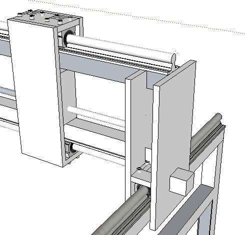

  2. #22
    Here's a quick mock up the ballscrew mount running between the Y rails. All uprights are approx 500mm

  3. #23
    Quote Originally Posted by r0bsk1 View Post
    That would be very tricky to do as the box section is 60mm and the rail base plates are 65mm
    The SBR25 rail base is 55mm wide unless I'm missing something?
    What could you get the ballnut mount down to?
    About 160mm if you're happy being limited to only using 1:1 or 1:2 ratio without changing the belt. Don't quote me on that though as I need to draw it first!

  5. #25
    Due to a change in plan i've settled on a 1200mm for both X and Y. Ill be using 2 lengths of 60mm box section on a back plate with sbr25 rails to form the Y axis. Y is mounted on the X bearings near enough at the mid-point of the Y bearings. I've not drawn them in yet but ill put some diagonal pieces in to support the Y uprights against the X bearing plates.
    Would taking the Y uprights below X bearings and box section and linking up with the opposite side of the X bearing plates offer significant more support to the X bearings?
    Y bearings appear to be a little out of position. Everytime i move 1 bearing, they all move! I must have grouped them somehow. Going on the bearing blocks are 65mm i have a 20mm space between the 2 which make 150mm from one end to the other on each Y rail. Is this spacing sufficient?
    Is it best to drive Y on the main Z back plate or can i use the shorter Z back plate? I'd like to protect the Y screw from any debris.

  8. #28
    From the drawing it looks like the plan is to mount the rails on the top and bottom of the welded box section? If so you'll have problems with how much the steel will distort due to the welding. The rail spacing needs to be very accurate (guessing probably <0.05mm) for them to run smoothly, which is hard to get even before welding. Perhaps consider bolting them to a backing plate instead, since this allows adjustment to get the rails parallel. Also you will get much less deflection on this Y-axis if the ballscrew is placed between the rails. Currently when a force is applied parallel to Y, the Y-axis bearings can deflect in the same direction since there is a long horizontal distance (parallel to X) between the cutter and ballnut/rails.
    If you decide to mount the rails on aluminium plate (as in post #15), then yes it is best to use tooling plate, but realistically the tolerances of the bearings are not that good so you would be fine with normal aluminium plate, but definitely not flat bar. If you were using profile rails then tooling plate would be the best option.
    With reference to the section marked in bold, you simply cannot make such a sweeping statement, ive just welded my complete 7x4 and i used my dual dial guages one the gantry was clamped and ready to weld and there is no diference in the distorsion after welding or certainly no more than there was before the welding. If you weld it in the correct fashion and you have used a jig to hold the pieces, then it is fine. I will admit that if you use a 2mil rod on an old stick welder crank up the amps and weld 2mm box together you will have problems but a modern mig used to tack the items together before finishing the welding of it turns out fine, im not saying Its better than Ali, just that if care is taken during the welding of steel box no more surfacing and leveling will be required than before you welded it. Obviosly when mounting the rails onto the gantry you will have to do some remedial leveling work but its just not difficult, I will show you how ive done mine in the next week or so and it certaily ticks the 0.05 accuracy box you mention with ease
    Rick

    Even before welding, it's questionable whether steel box section is accurate enough to mount round rails on opposite faces, so no matter how good the welding is it's not a good plan. It certainly wouldn't work for profile rails without further machining or shimming.
    How do you know?
