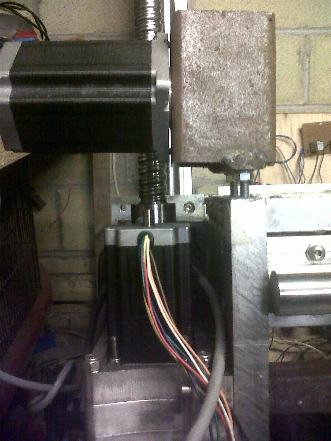

    X ball nut and stepper
    X screw clamp. For some reason i asked for 10mm to be added to the mounting face of the stepper mounts. Cant remember exactly why but that's put the 2 screws out of line with the rails. No biggy.
    The camp is made of 60mm box section with 2 aluminum wedges inside that clamp of to the screw when bolted together. They also wedge thigh inside the box section. 50mm box section is welded underneath and slide in to the main frame.
