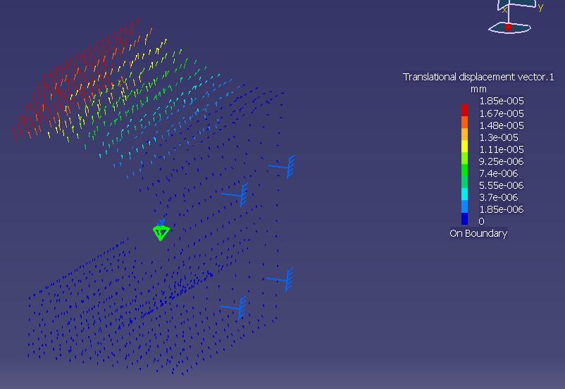

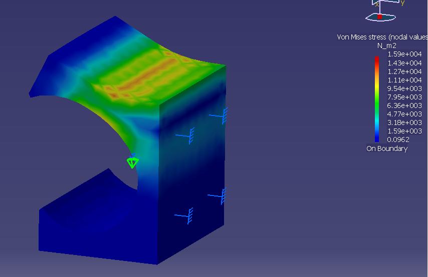

    I've answered previous posts on sideways mounted open bearings by pointing out that they will open up a bit with load in that direction. This time however I decided to carry out some stress analysis on a simplified part. The results were quite interesting.
    For a 16mm open bearing:
    1N load was applied vertically to inner bearing whilst restraining the outer face (the area you would clamp your gantry to).
    Displacement is 1.85e-5 mm, therefore 1.85e-5 mm/N.
    So for a 30kg gantry spread over 4 bearings thats 73 N per bearing, which is about 0.00136 mm or 1.36 microns.
    Initially that seemed pretty small so either there was an error in the calcs or I was worrying over nothing - but then realised that I should really model the supported rail and include that since I think it would be quite significant. Will have to wait for another night . . .
    Here are the pretty pictures for the open bearing under 1N vertical load. Stress on the left in N/m2 and deflection on the right in mm.

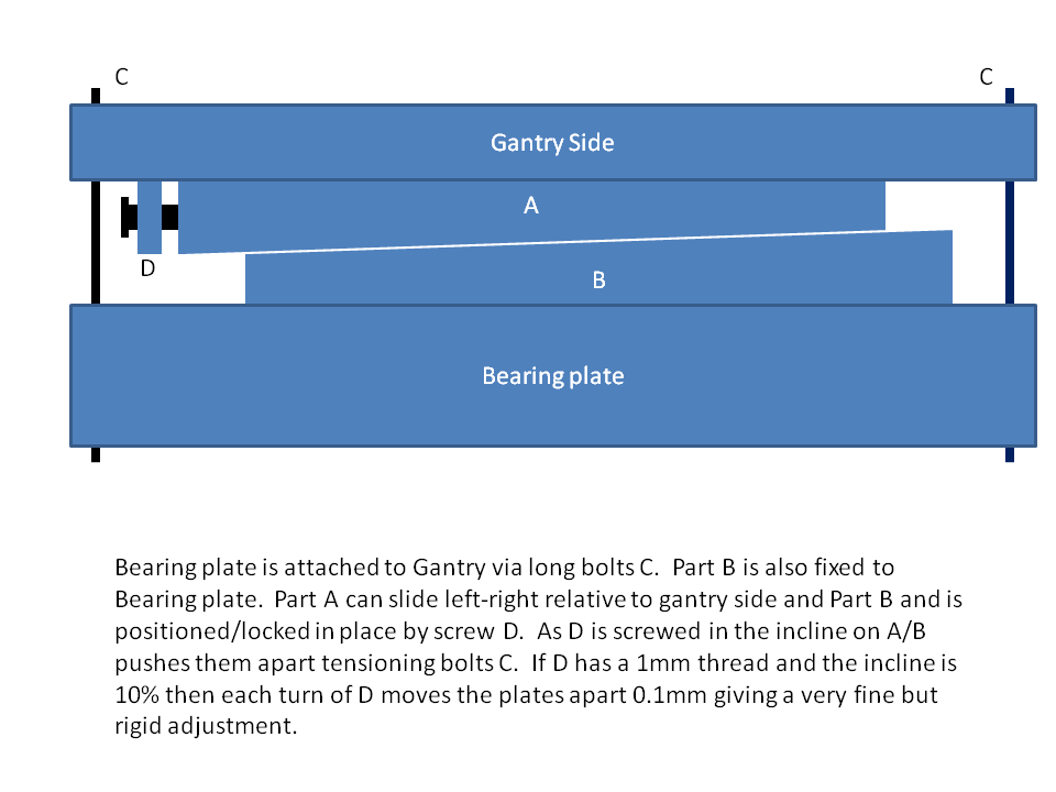

  6. This is where an expanding joint arrangement a.k.a something like a gib strip would be helpful...
    You mean like a slightly sprung plate?
  8. no, a gib strip is a tapered piece that slides against a similarly tapered piece so as they are pushed together they exert an outward force. The diagram explains all...
    Ahh I see. That is an elegant way to do it, but seems rather tricky to implement in practice. None-the-less the job is done now!
  10. Not at all, its standard practice on pretty much all milling machines and lathes where you have 2 moving parts that you want accurately controlled levels of 'tightness' between them
