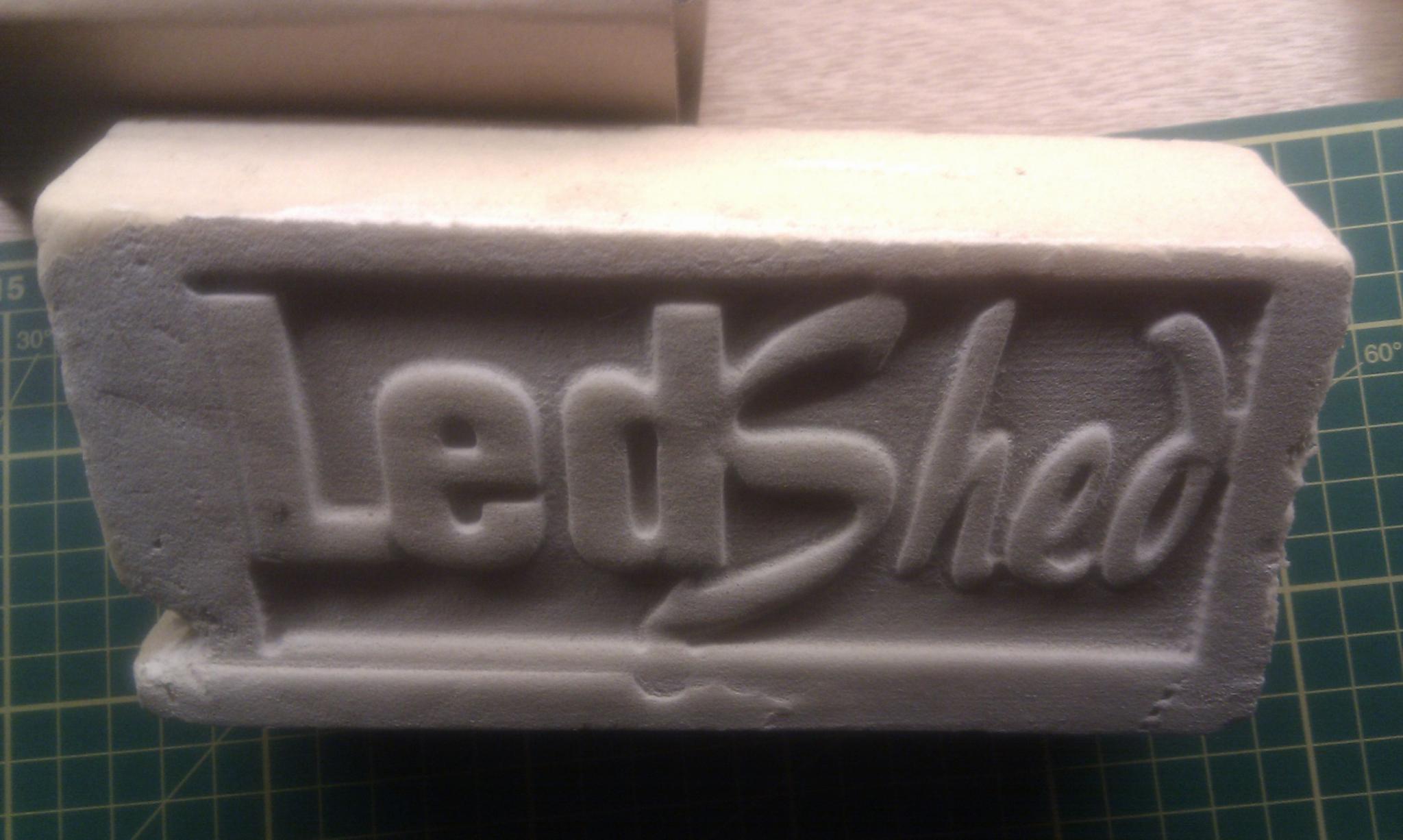

    Foam comes in many grades, Cellotex and 1/4" cutters from Toolstation, thanks Jonathan, are a cheap and available way of prototyping,
    Meshcam test on logo into cellotex with 1/4" 5mm cutter, can`t be any harder on cutter than wood or MDF.

    Celotex Cavity Wall Board 50mmx1200x450 - Polystyrene Insulation - Insulation -Building Materials - Wickes
