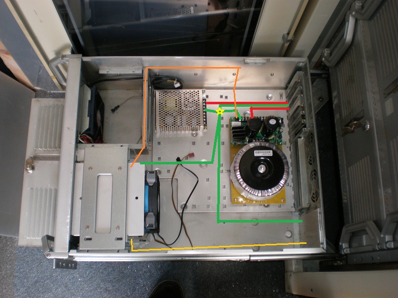

    As the first materials for my CNC Router have started arriving, here are the results so far:
    The second pic shows the re-purposed 4U Server case housing the PS806-5 PSU and a 240v AC to 12V DC PSU for the fans (two 80mm fans will extract the hot air out the back). The 3 x PM752 drivers are int eh drive bay behind the blue 120mm fan in the lower left corner.
    My wiring routing will be largely as shown:
    Red= AC in to both PSU's - will probably wire both of of the same 3 pin input socket, which will be housed in a plate to be fixed to where the old expansion card slot are.
    Orange = the route I will take for the driver power from and to the PS806
    Yellow = the stepper wires and any other wiring e.g. limit switches, estop etc - I'll be using 4 pin XLR connectors
    Green = earths from everthing back to the yellow star point and then back out the case via the three pin connector
    The 12V DC motor wires will be roughly wher eyou can see them now running at the bottom of the case to the 2nd PSU.
    The main power switch will be in line with AC live and will be a two button start/stop similar to what I have on the front of my pillar drill.
    The breakout board will likely be mounted to the left of the PS806, with its feeds to the drivers going in the same side as the yellow stepper feeds.

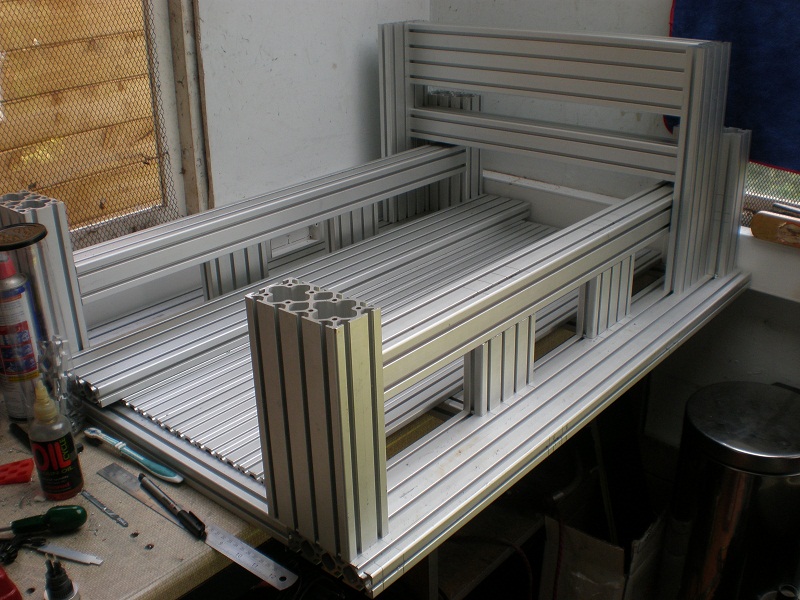

    Oh and there is also a pic of where I have got to with the mechanical end of things (ignore the undersized work surface - that is being replaced with something large enough and additional supports added). The thin bed ali profile was a fail purchase on my part and will be replaced with the 30mm profile you maybe able to see sitting on top of it and the thin profile is going to become wall mounting for my guitars and maybe tools etc, so it won't be wasted.

    PS. I am thinking that I should the VFD's earth back to the star point shown in the case in the pic and not back to its own 3 pin plug's earth (both will be on the same 32A spur, along with the PC that's going to run Mach3 so the whole rig is on its own RCD)?

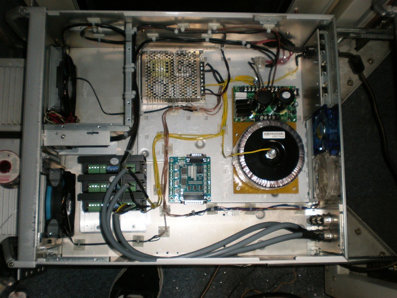

    Whilst waiting for my bed extrusions and some other components to arrive, I have been busy festooning the rack mount case with wiring (see pic below).
    Stuff wired up are:
    - the small PSU, which is powering the case fans (tested this and all is running fine).
    - The 240v AC input, which goes to a front panel mounted On/Off switch (same kind you see on pillar drills etc)
    - 240v AC from the On/Off switch to the two PSU's
    - The CY cables for X, Y and Z from the drivers to the XLR sockets (shielding grounded to the star point) - I'm wiring my steppers in parallel, so am following the Zapp wiring diagram here: http://www.zappautomation.co.uk/down...%20%281%29.pdf
    - The high voltage DC side of the drivers to the transformer (running it parallel off of one PSU output (hope that is right)
    Still to do are:
    - Low voltage DC side from the breakout board to the drivers (waiting on some lower guage wire for this job)
    - Limit switch, spindle, e-stop wiring from the breakout board to the spare XLR connectors
    - Find out if the earth lead I have on the main PSU is really where it needs to be, as there doesn't seem to be anywhere else to attach it to, or discard it if its not needed?
    - Perhaps get some QA on my wiring, because although I am following the diagrams etc to the letter, a fresh set of eyes is always useful before throwing the power switch for the first time....
    The mechanical side of things is on hold for the moment pending delivery of some extrusion channel nuts to start mounting the rails and some ali plate for mounting adapters.
    More to come........
