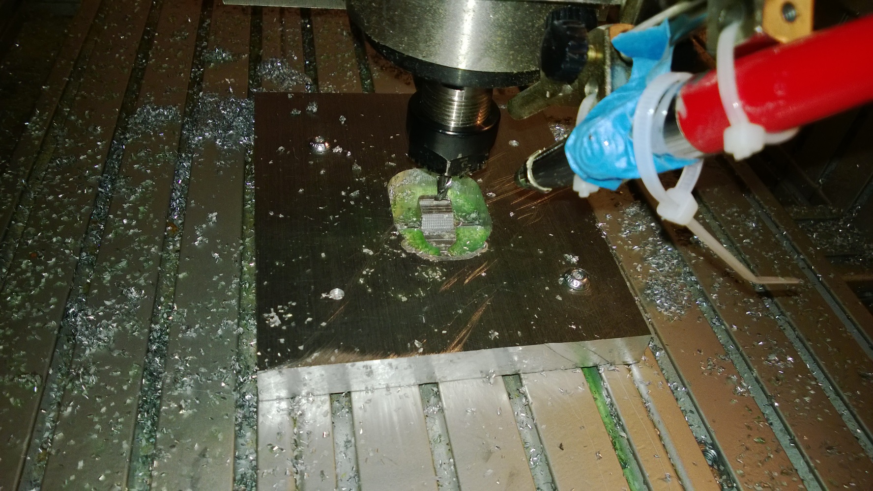

    Some pics of the changes to the machine over the weekend, including the new spindle mount, the additional Z clearance and touch probe.
    Also I have the mixing block for the mister mounted to the right of the spindle and am now awaiting a 1/4" BSP tap so I can hook it up to fluid and air.
    The axis is chocked up as a safety measure as the more freely move (read better aligned) Z-Axis means there is very little resistance to prevent the axis "falling" when the machine is off, other than the stepper motor "steps" themselves.
    Hopefully I should be cutting again this week.

    Evening all,
    A quick pic showing some more progress since my last post:
    This one shows:
    a new and longer air line,
    a remount of the "mixer" block so I don't lose any Y axis travel
    the coolant/cutting fluid line attached and also a reservoir for the fluid on the top of the gantry at the back
    The only thing I am missing now is a 1/4" male to 1/8" male adapter for the air line (its current position is "fake" as a "dry run" and the connector there is a mock one from a PC cooling system. Hopefully the adapter arrives soon or I'll have to work out how to setup my lathe for threading (if it can cut BSP - it does metric and imperial).

    Quick update (sorry no vids yet again)
    I decided to have another go at GWizard to try some feeds and speeds as there is now a new set of parameters you can plug into the tool for gantry style machines such as mine. I did that for a 6mm Carbide end mill using 2mm DoC and 40% step-over and it suggested 17304 rpm at 793mm/min, which I thought was a bit wacky. However, I have just run a circular pocket climb milling in my usual 6082 Ali which was 10mm deep and 63mm in diameter and it ran like a champ, with just blown air (see note 1. below) and the odd squirt of diluted cutting fluid.
    That was the good news but I have a couple of frustrations to sort out:
    1. My misting solution is not working, as air is being blown back up the fluid tube rather than sucking it out - might need to redo or rethink that either by making the injection port for fluid very small (its pretty small as it is) or just dripping fluid out of a separate line into the air flow.
    2. I have some chatter when cutting in the y axis (x axis passes are beautifully stable) and I have some flex when pushing sideways against the z axis (if that makes sense) i.e. looking at the machine from the end on its like the z axis is trying to roll sideways - I'll have to go over all the bolts around that area and see if anything is loose as something may have loosened or I didn't tighten properly when re-assembling the new z-axis (that chatter wasn't there before I cut the replacement).
    Oh thanks to mekanik and the tool above I cut some 1/4" BSP threads on my lathe, but even though the SC4 comes with a 127 toothed gear it still took some fiddling on a spreadsheet to work out a close match, as 19TPI doesn't use that gear and the closest I got was 19.05, which was a little tight but a but of brute force "finished" the threads up nicely ;-) Thread cutting was actually quite easy compared to what I remember from doing it at school, as the Seig has a good reverse and the half nut means I didn't have to faff about with a thread dial etc.
    I have a queue of parts to cut so will make an effort at a video later this week.

    Hi All,
    A couple of vids, as the machine is cutting again. They're not very long as the one was just a facing pass to get the material block to the right thickness and the second one I had to start clearing chips with the air gun (more to be safe now I have decent air).
    Sharp eyed amongst you may notice I abandoned the mixing block effort from before and just ran two lines - one brass tube for air and the other PVC for cutting fluid, which just drips into the air flow.
    The second one was a 2mm DoC using F&S from GWizard, which I was quite happy with and I think I could go deeper. A good sign was scorching hot chips, which I noticed when one fell down the front of my t-shirt, but no discernible heat on the part (I wasn't going to touch the cutter, but trust in my coolant) ;-)
    I'll try and get some more video once I work out a way of mounting my phone, so I can fuss over the machine whilst recording.
