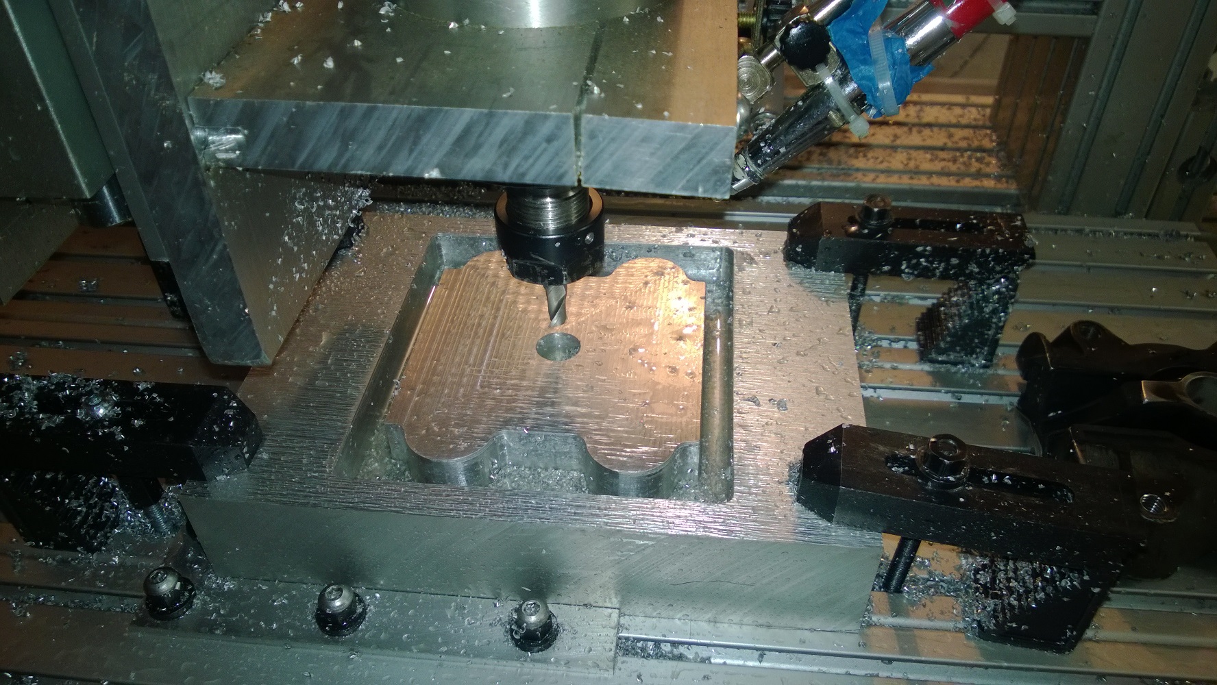

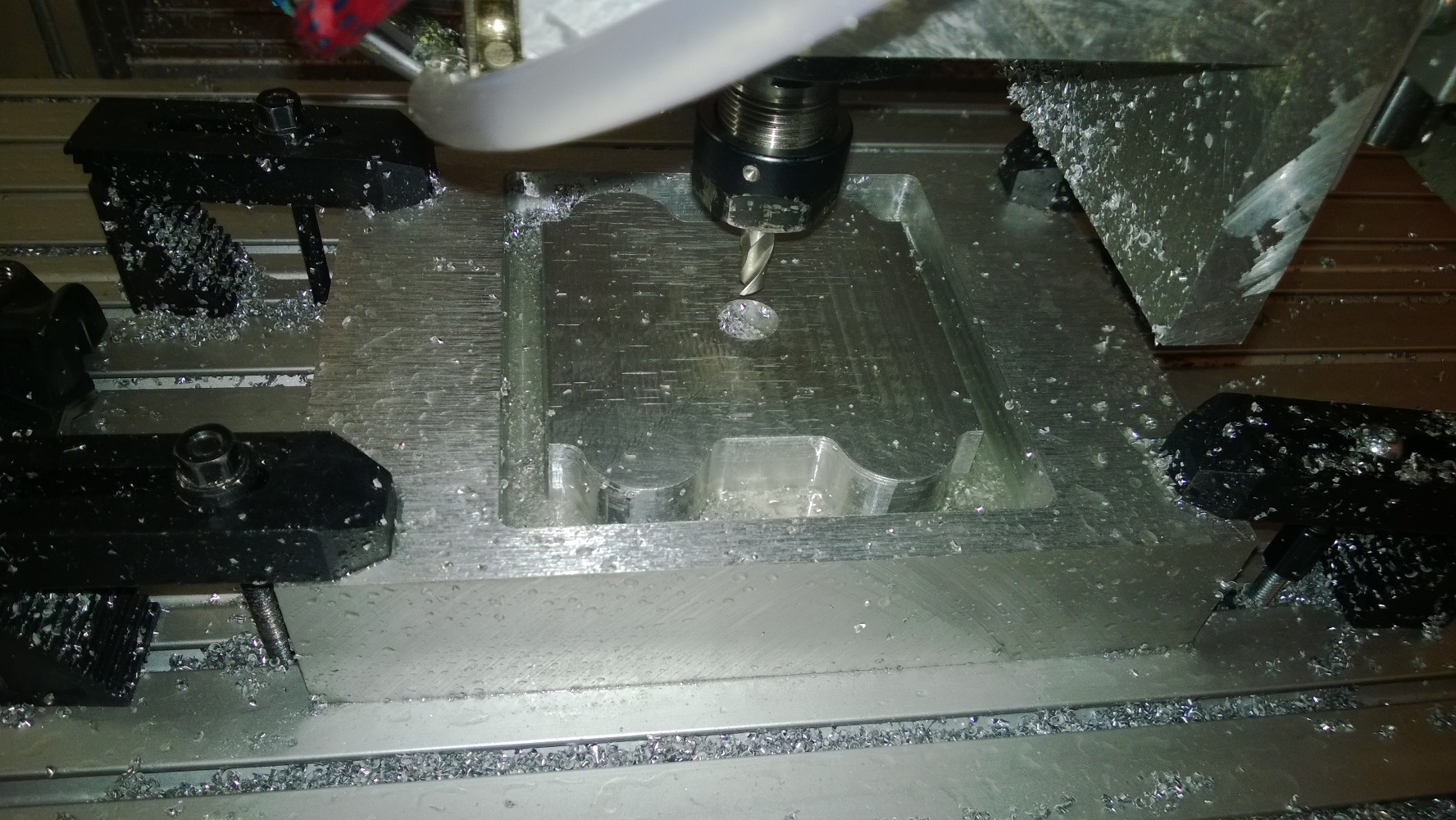

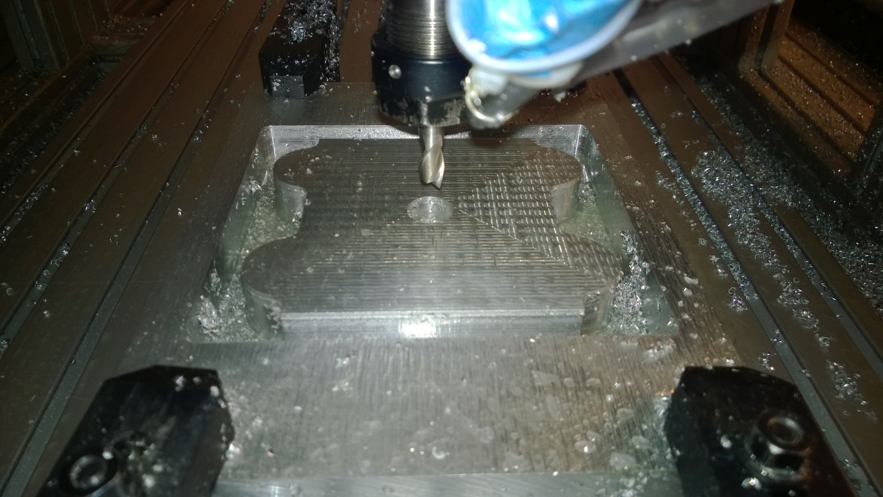

    Another update on progress and again machining rather than building the machine, even though I have upgrades queued up waiting for some time.
    Anyway, I have a paying customer now and even though my machine is still in the later stages of build he's an understanding sort, so I'm doing my best to oblige. So the pic attached are the result of a few 2D operations -
    1. was a 0.2mm facing pass to get rid of the "texture" on the aluminium plate (40mm thick 6082 T651)
    2. was a pocketing operation to do the hole in the centre
    3. was the pocketing/profiling operation (on one side only at this stage)
    All were programmed in Vectric Cut2D and this is where some "fun" started - my machine for some reason likes to mill when running in a clockwise direction in a pocket, which I think is conventional milling i.e. the spindle is running clockwise as you look down on it from the top. My understanding however is that climb milling should be better?
    Also another observation is that compared to climb milling around the edges of a pocket my machine actually seems to like doing slotting better?
    All 3 operations above were using a conservative 1mm DOC @ 10000rpm @ 800mm/min using an 8mm 2 Flute HSS End Mill-
    I think I can go much more aggressive in DOC but I do have an issue with getting the chip out of the pockets at deeper than about 10mm - I probably need a more powerful compressor or wing at on blown air alone rather than the heavy mist I'm currently using, which tends to pool cutting fluid/water/chips mix in the corners and bottom of my pockets. Shallower cutting is great as the chip are getting thrown out nicely.
    The results of the main pass and facing is a little rough, but I guess that's why its called a roughing pass. The centre hole pocket is much better.
    I will eventually get some more video once I can trust the machine to run on its own on an operation without me brushing out chips and generally hovering about the thing watching.
    Chris

  4. #114
    I plan to cut hardwood but currently I use an overhead pin router with templates, as you say with the cutter running clockwise from above I would be moving the workpiece anticlockwise as this is the only safe way to cut hand held stock. If it's moved in the same direction as the cutter then the cutter tends to acts as a power feed and just pulls it out of your hands but if you can hold onto it the finish tends to be better. So maybe the best plan is to use conventional milling for the most part and leave a finishing pass in the opposite direction ? at least with it being a cnc and everything clamped it should not 'run away' as a hand held would.
  5. #115
    Lives in East Lothian, United Kingdom. Last Activity: 22 Hours Ago Forum Superstar, has done so much to help others, they deserve a medal. Has a total post count of 2,994. Received thanks 376 times, giving thanks to others 9 times.
    Climb milling will produce a better finish, but only on a sturdy machine with near zero backlash and flex.
    Any flex or backlash can cause the cutter to grab the workpeice leading to an inconsistent cut and poor finish.
  6. #116
    Exactly what I experience with hand held routing.
    Edit: following Wobblycogs' post below I'll have to clarify that by saying hand held routing I'm not meaning with a cnc machine but just with a standard woodworking router or my overhead pin router. In both cases hand holding the workpiece or at least using some hand held push-stick is the correct method.
  7. #117
    Climb cutting and hand held routing is asking for trouble. You'll get away with it in something like MDF where there's no grain but I wouldn't do it with real wood. There's too much risk of stresses in the wood or an awkward bit of grain suddenly causing the router to take a bigger bite than you are expecting and getting away from you.
  8. #118
    Thanks guys - that makes sense - so conventional gives the machine an easier time but doesn't always produce a good finish, whilst climb beats the machine up a bit but finishes better, provided its sturdy enough.
    I'll try a conventional version of the toolpaths and see how that goes on the other side of that block (hence the L Shaped locating bracket seen in one of the pics).
    Whilst I remember I also have a MACH3 query if anyone knows the answer: when I Feedhold (to clear chips) and I hit Cycle Start to resume cutting, the operation I interrupted resumes, but at a much slower speed than before I hit Feedhold. Is there a way of stopping this behaviour as changing my feed rate is a bad idea......
    Chris
