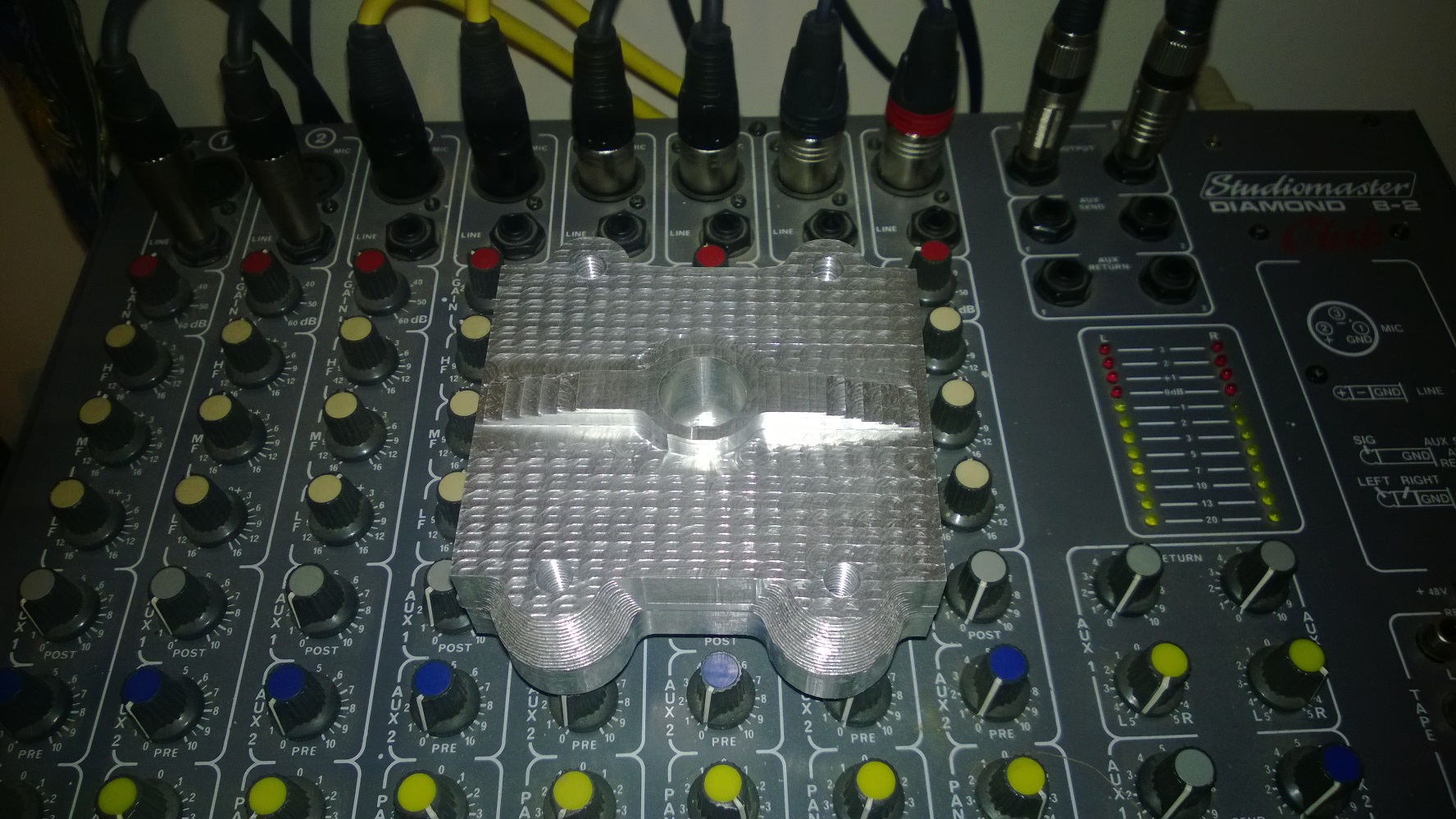

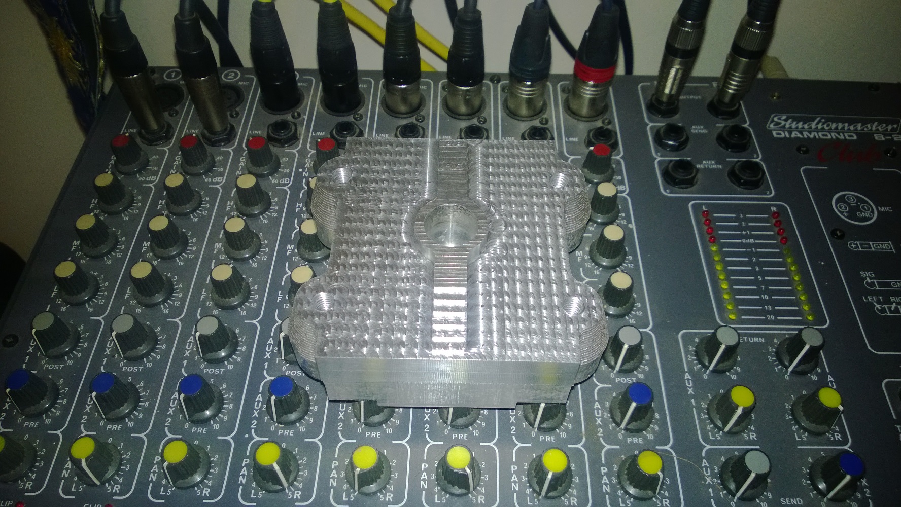

    Firstly the pics below are a sub-frame mounting bush, which on the normal road car is an ali and rubber affair and in order to increase stiffness on the track are being replaced by these. This is just a roughing pass mostly - the finished bits being the counter-bored hole in the centre, the bottom half which is all 2D stuff and the M8 tapped mounting holes. So this is a bit of a milestone, as its the first proper part to come off of the machine apart from the L-shaped jig so the part can be flipped for 2 sided machining.
    The warts as I see them are a few ledges here and there where the machine lost steps, due to a bent ball-screw, which I am replacing, general chatter marks, which I should normally clean up with a finishing pass, but as this is going to be buried far from sight won't do unless my customer insists on paying extra for a run over with a ball nose mill ;-).
    Other bits I am intrigued about is the pretty pattern on the top which is very regular and I'm guessing is feed or speed related?
    Also once you guys can see the video, I am running what was to be a kind of pocketing pass to cut the part out, but it was such a faff I stopped that and just went for a slotting cut out path. Also the path you can see there hopefully shows the machine behaving nicely when slotting and chattering away when cutting on one edge (using climb is worse) and for info this is 6082 ali with an 8mm HSS end mill @ 10000rpm, 1mm DoC, 800mm/min and ramping over 10mm combined with a 600mm/min plunge (seems to be the sweet spot for my machine so far).
    The path was also being run after I had done the bore and two pockets, so there is a fair amount of air cutting going on, but hopefully shows a variety of behaviour.
    Once I have replaced the bent ball-screw and hopefully resolved the stalling/missing steps issue, I'm going to have to play about with the machine as the ease at, which it slots seems to indicate I should be increasing my step over when pocketing/profiling (currently 20% or 1.6mm) or increasing DOC, as the machine actually seems happier when going a bit more aggressive.

    Strange tool paths those it seem to cut more air than Chips.??
    Your correct about step over being small and could possibly be why your getting chatter has not enough tool engagement. At those DOC you could easily do 50% thou I prefer 45%.
    I would do some playing around in scrap with different DOC and STO etc and think you'll be pleasantly surprised just how much more aggressive you can be.!

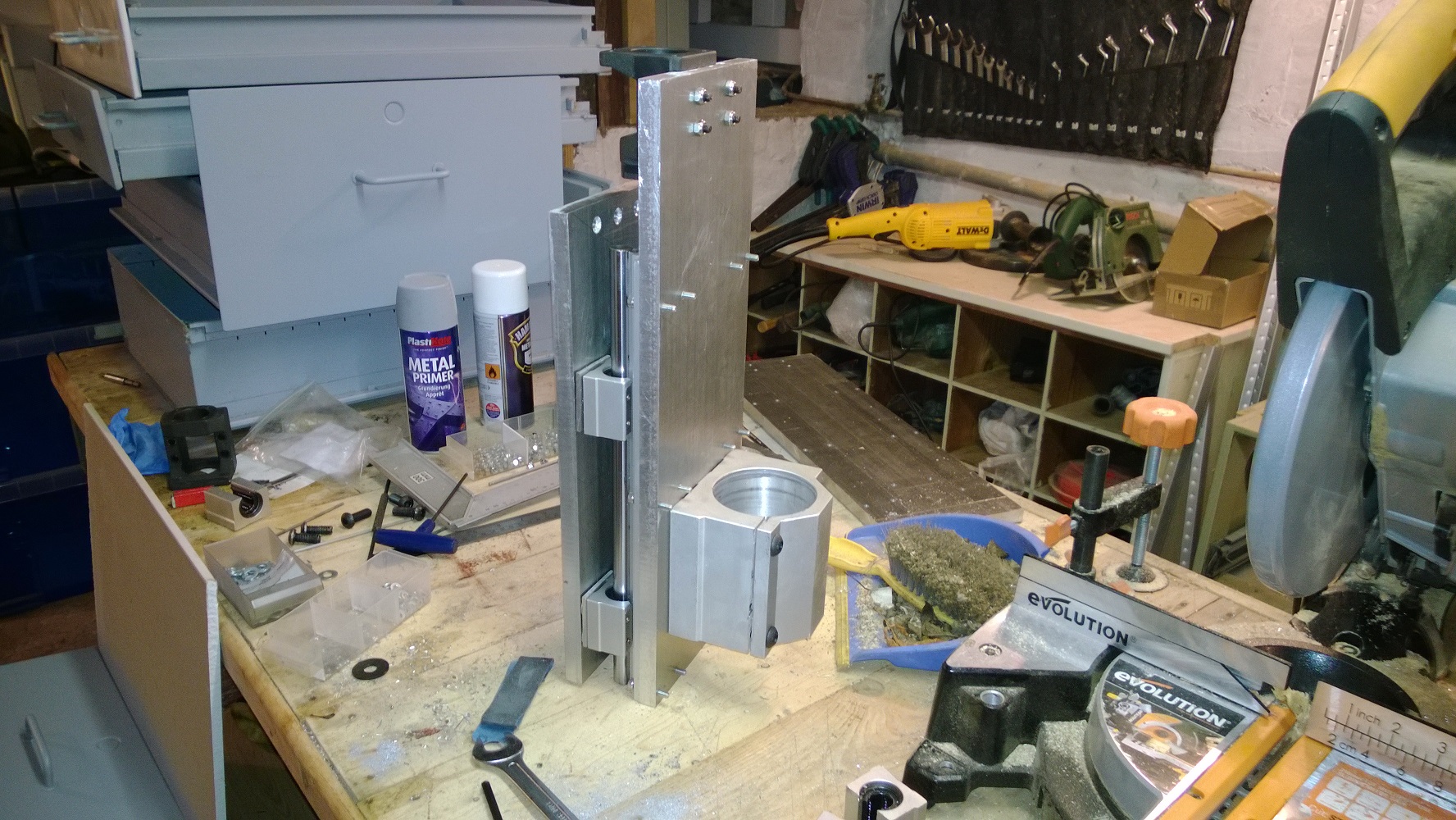

    Over the last week I have been retro-fitting my machine with the new spindle mount using the 80mm bore bearing block I have had for a while now. As I also had some stalling issues on the Z-Axis I wanted to replace the manually marked and drilled axis plates with new ones and used the machine prior to dismantling to machine these out - making CNC is a lot easier when you have CNC obviously ;-)
    So here is a pic of the partially assembled new z-axis with its new spindle mount. I have to fettle the rails/bearings a little before locking them down, but given the two halves slid together easily, the alignment of the drilled holes etc. on the machine is a lot more accurate than the MKI eyeball I used previously.
    I also discovered when disassembling the axis that two of the SBR16 bearing blocks were loose and may have accounted for some of the chatter I was getting and may also be evident in the pic on the edges of the plates.
    I will hopefully have some video once the axis is remounted.
