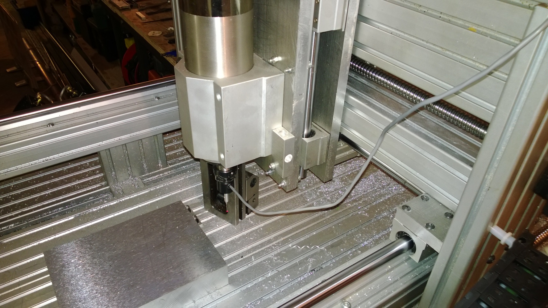

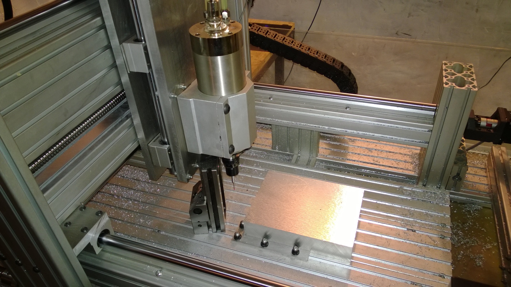

    Some pics of the changes to the machine over the weekend, including the new spindle mount, the additional Z clearance and touch probe.
    Also I have the mixing block for the mister mounted to the right of the spindle and am now awaiting a 1/4" BSP tap so I can hook it up to fluid and air.
    The axis is chocked up as a safety measure as the more freely move (read better aligned) Z-Axis means there is very little resistance to prevent the axis "falling" when the machine is off, other than the stepper motor "steps" themselves.
    Hopefully I should be cutting again this week.

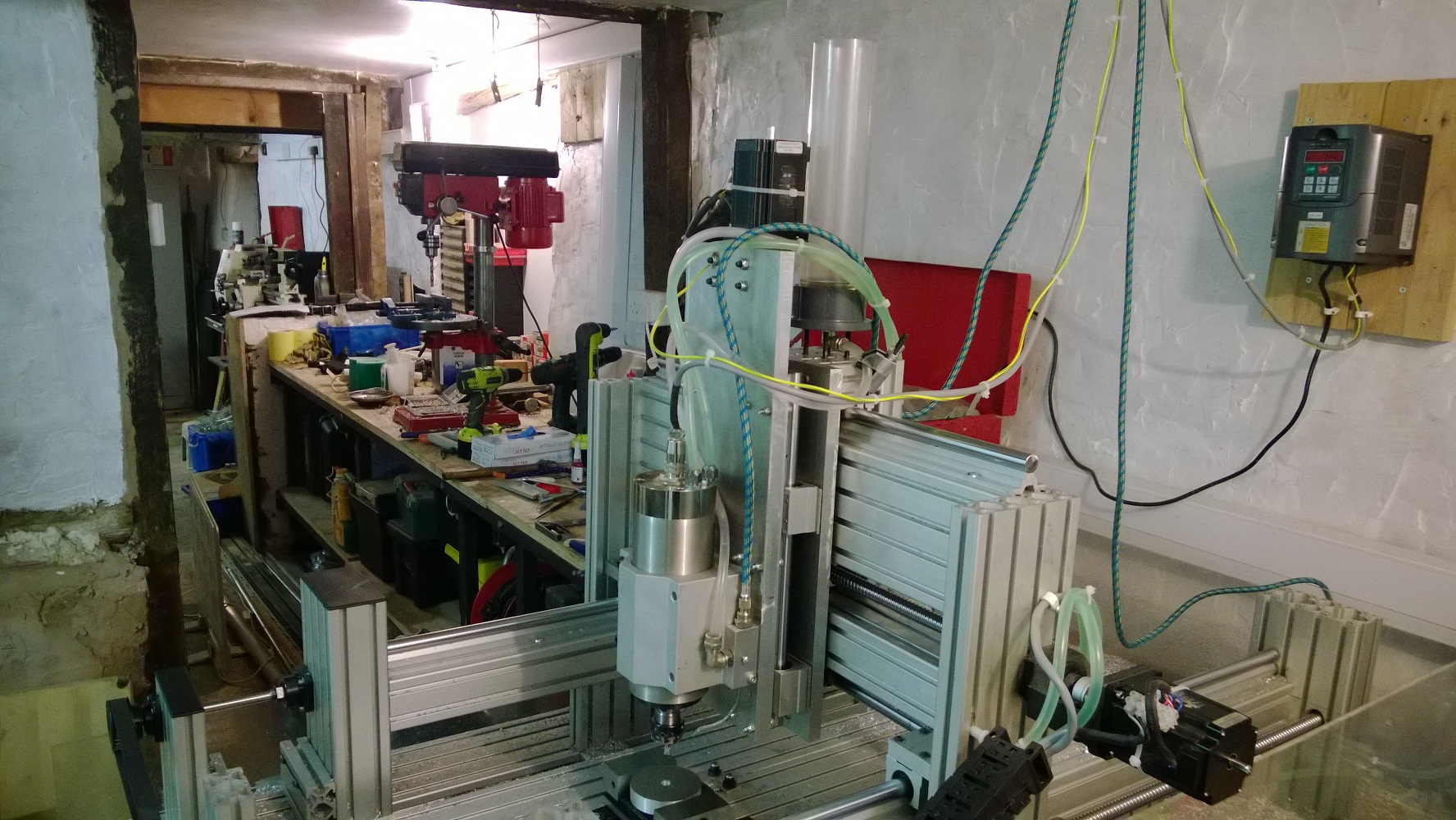

    Evening all,
    A quick pic showing some more progress since my last post:
    This one shows:
    a new and longer air line,
    a remount of the "mixer" block so I don't lose any Y axis travel
    the coolant/cutting fluid line attached and also a reservoir for the fluid on the top of the gantry at the back
    The only thing I am missing now is a 1/4" male to 1/8" male adapter for the air line (its current position is "fake" as a "dry run" and the connector there is a mock one from a PC cooling system. Hopefully the adapter arrives soon or I'll have to work out how to setup my lathe for threading (if it can cut BSP - it does metric and imperial).

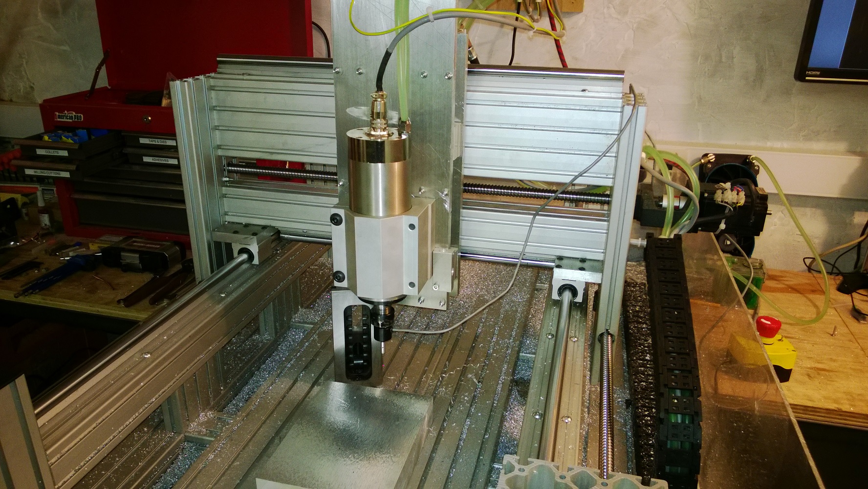

  9. #138
    Hi All,
    A couple of vids, as the machine is cutting again. They're not very long as the one was just a facing pass to get the material block to the right thickness and the second one I had to start clearing chips with the air gun (more to be safe now I have decent air).
    Sharp eyed amongst you may notice I abandoned the mixing block effort from before and just ran two lines - one brass tube for air and the other PVC for cutting fluid, which just drips into the air flow.
    The second one was a 2mm DoC using F&S from GWizard, which I was quite happy with and I think I could go deeper. A good sign was scorching hot chips, which I noticed when one fell down the front of my t-shirt, but no discernible heat on the part (I wasn't going to touch the cutter, but trust in my coolant) ;-)
