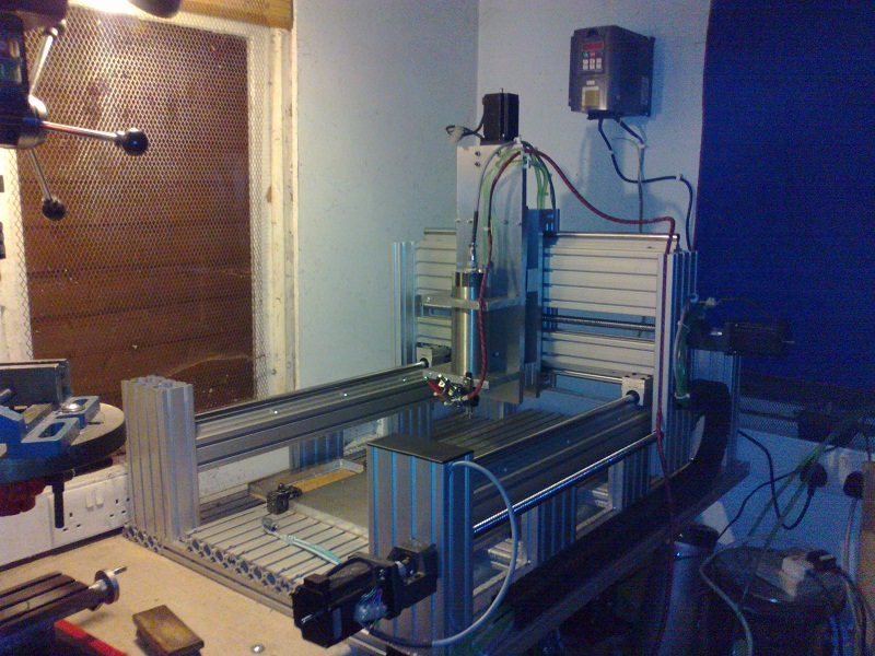

    Yeah I figured the single x axis ballscrew was causing weakness - I'll get a mail over to Chai for a new ballscrew with appropriate machine end and go the pulley/belt route (seems less prone to error than two steppers). I'm looking at Zapp/Gary for the belt and pulleys if I can decipher what length belt to order (whether the length is for the whole belt or the loop if folded in half - if that makes sense).

    The machine will be a beast at this size and strength. To give some idea my machine Y axis travel is 1100mm, so technically more likely to be weaker or more flexy than yours.
    Smack bang in the centre at 3/4 Z extension so possible 120-130mm extension below Z axis. I've just cut a oval pocket 70mm x 30mm length single pass at 8mm Doc 45% step over @800mm/min 12Krpm in 6082 T6 Aluminium just using blown air no misting or coolant(quick initial squirt of WD40).
    In doing this, it first spiralled down to depth, it then had to cut full slot for about 40mm and while it moaned slightly more than the when cutting 45% stepover it still handled it no problem and the actual 45% stepover was a doddle and I'm sure I could have easily pocketed at 45% step the full 10mm depth of material.
    While bit extreme on DOC and not something I do often at full slot width. I Can't see why your machine couldn't do this kind of cutting and like mine will most certainly easily handle half this DOC at higher feeds.

    A quick pic of the machine for those interested.
    Doesn't look like I can get a ballscrew machined before Christmas, so the build/upgrade etc is going to have to go on hold. I'm also moving house next week, which means taking the gantry off or seeing the removal guys slip a disc or two and this will also be a good opportunity to fit the second ballscrew when it arrives.
    For the sharper eyed amongst you I didn't have my new gantry mounting brackets on when I took this pic, but they are ready. Also for some reason the flash on my crappy camera phone has made the ali extrusion look like I have pimped it with blue LEDs, but the coolant is indeed green. I've been using PC watercooling pump and fluid, as I have been water-cooling my PC's for years without any gunk forming and using a spare radiator/fan unit means I don't need much of a resevoir for water. So far I've yet to feel my spindle get warm after a continuous 54min session.
    BTW - the new house has a 31x15 foot workshop and I'm going to be building a workbench down one wall out of steel box section, which means learning to MIG weld - does anyone have any recommendations for a welder and whether gasless or gas is better?
    Chris
