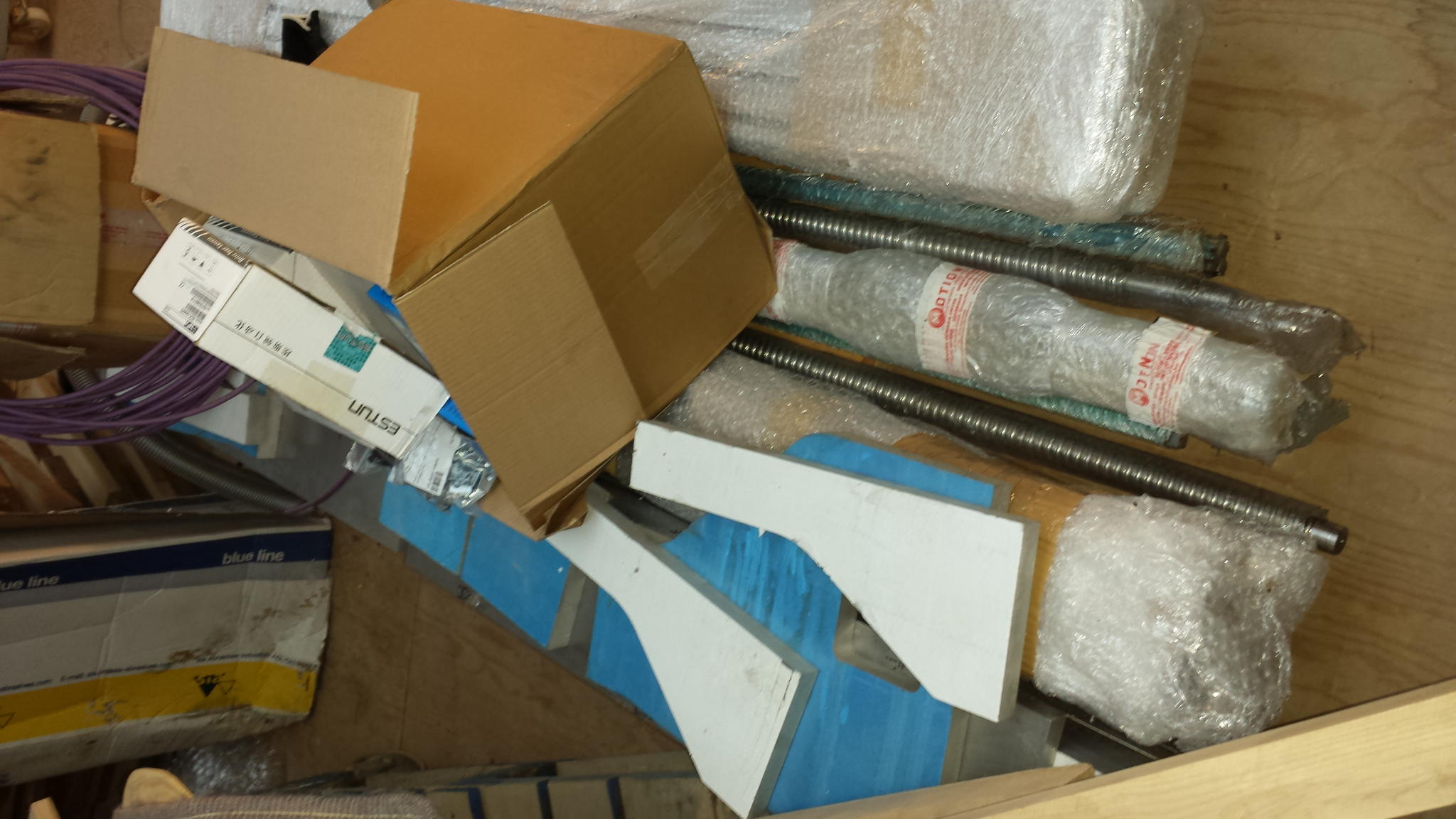

    Well not at all what I was expecting! I was talking to a friend about a build and the conversation has ended up with me adopting a partially completed build.
    The machine was started as a project by a precision engineer friend and has been abandoned because of lack of time and his moving overseas for work... I still find it hard to believe he is allowing me to play with it.

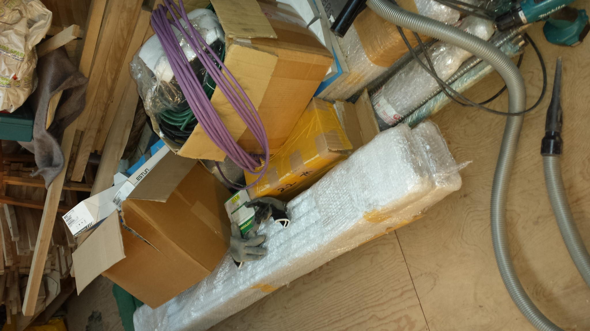

    Not much detail yet, I am still waiting for the original drawings so I know what the partially finished parts are for and what machining is still needed...but collected a few bits last week.... probably 350kg of them...
    A pallet full of parts, some machined, some partially machined and some waterjetted.... the visible ballscrews are x axis and 32mm!!!

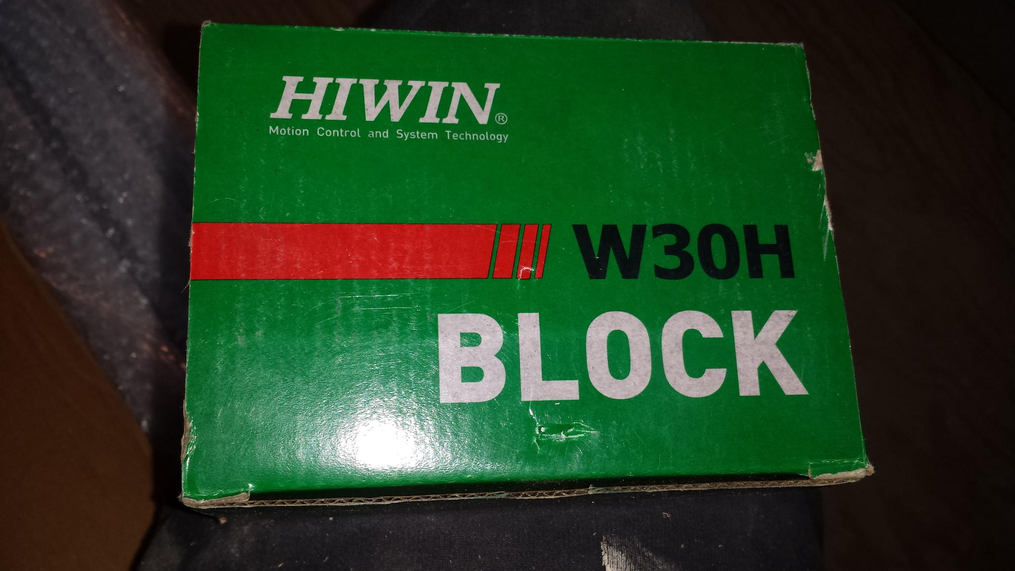

    30mm hiwin x rails, 20mm for y &Z
    most of the frame is 30mm aluminium... gantry is extrusion, sixes to follow
    everything except the BOB in the electrics... servos and controlers etc...
    2kw watercooled spindle
    extruded aluminium table
    Hoping to start work on it next week... far sooner than I would have chosen and still far too many basics to learn.. but we will have some fun along the way
