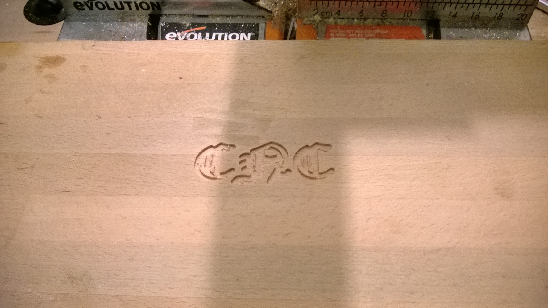

    On the bright side, to do the testing for the spurious e-stops I ran a job in beech block just to try and the following pic resulted, which despite the e-stops probably losing steps when incurred, is at least something and came out nice and clean apart from where the wood won't hold the very thin details. The 3mm end mill went through the wood like it was not even there (ran at 18600 rpm at 800mm/min on a 3flute), so aluminium next :-)

    Even quicker update: looks like all parallel cables are not equal, as I have just replaced that for the old one and all is now well - test job ran without any e-stops :-)
    Now for some cutting.......
