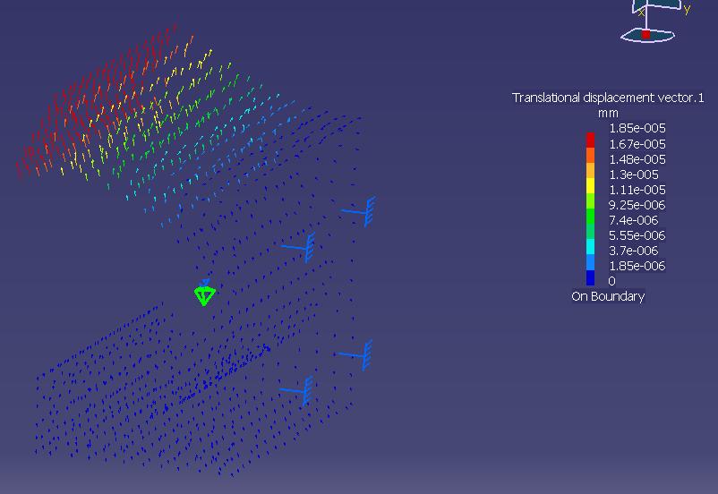

    I've answered previous posts on sideways mounted open bearings by pointing out that they will open up a bit with load in that direction. This time however I decided to carry out some stress analysis on a simplified part. The results were quite interesting.
    For a 16mm open bearing:
    1N load was applied vertically to inner bearing whilst restraining the outer face (the area you would clamp your gantry to).
    Displacement is 1.85e-5 mm, therefore 1.85e-5 mm/N.
    So for a 30kg gantry spread over 4 bearings thats 73 N per bearing, which is about 0.00136 mm or 1.36 microns.
    Initially that seemed pretty small so either there was an error in the calcs or I was worrying over nothing - but then realised that I should really model the supported rail and include that since I think it would be quite significant. Will have to wait for another night . . .
    Here are the pretty pictures for the open bearing under 1N vertical load. Stress on the left in N/m2 and deflection on the right in mm.
    Attachment 6986Attachment 6987

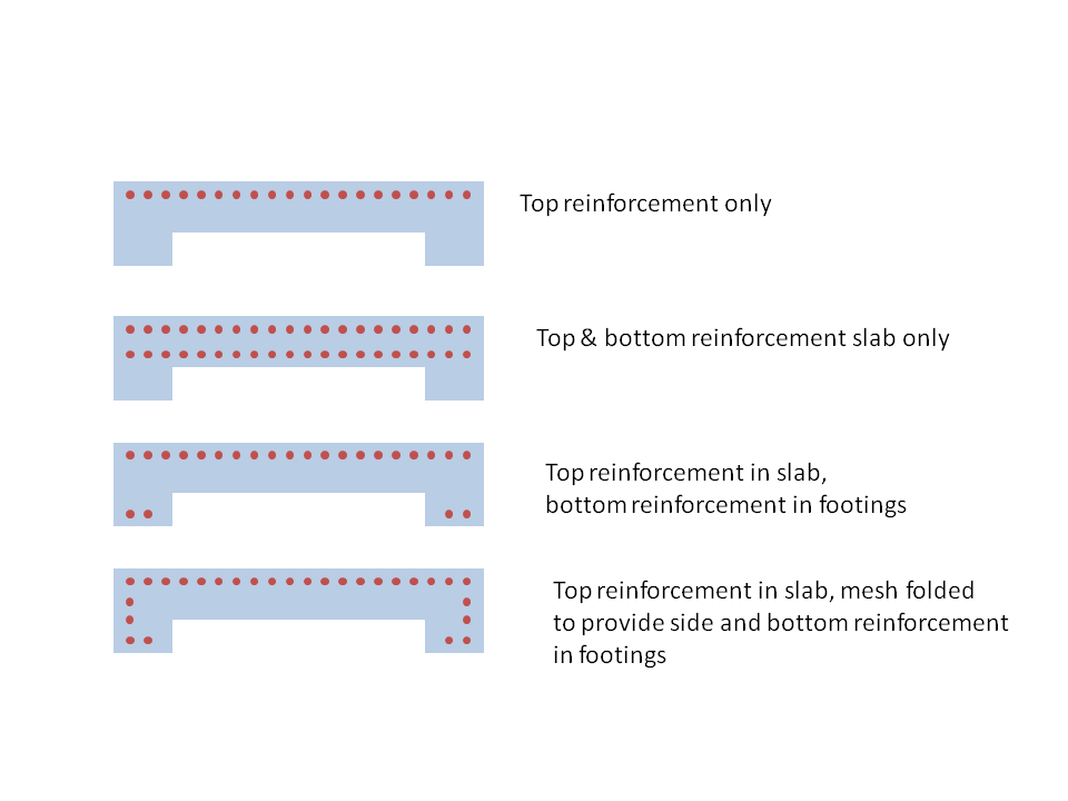

    what I'm trying to do is model a concrete slab with reinforcement. I've not found a tutorial on this online yet. I'm guessing I can model it as a set of stacked beams/fibres?

    No, progress halted by the fact the hole is doing a poor impression of a swimming pool filled with porridge :(
    But before I order the reinforcing mesh I want to check out that A142 mesh is sufficient and whether I should put 1 layer mid beam or 2, top and bottom, or fold the top one down the sides and back under the footings
    The reason being thast the clay soil I am 'floating' the raft into can experience 'heave' of up to 150mm potentially so there's quite a bit of stress on the raft if thats all at one end...
