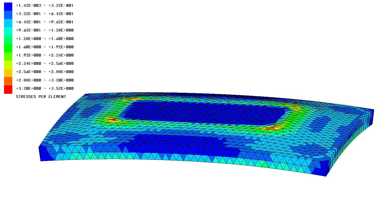

I've never seen weldmesh folded - don't even know if it can be!
From a dismantling point of view, I would prefer that you only put one layer of mesh in the top, that would guarantee an easy job of demolition. One layer in the mid would be next-easiest with the top layer and bottom of footing third easiest. Most robust would be top & bottom layer of steel in the slab. U-bars on the egdes fully tied into both meshes even better again, you have a strong slab then. Best of all would be a full cage in the footings with top/bottom layer in the slab with u-bar links but you're looking at a few bob for that.
