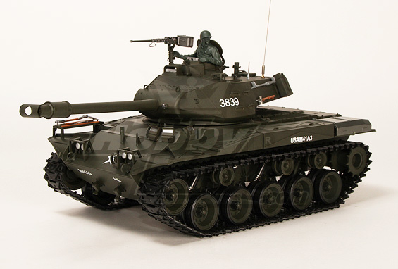

    Anyway I bought a Heng Long Walker Bulldog
    *Not my tank but for reference.
    There’s nothing fancy about it , no smoke or sound, and after a few hours playing around shooting various things (badly) it got a tad boring lol

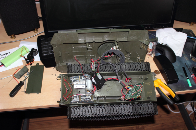

    The idea is of what to create... is evolving as I go along. I first thought of using a wireless camera via my Wi-Fi network. This is fine but is very very limited. First of all the range would be poor unless I added repeaters or boosted the signal somehow. Anyway I decided to go for first person view equipment. Lots of range , lightweight for RC planes and lots of things on the forums to help me decide the correct equipment for my project.

    So part 2 Controller.
    Well I’m not sure here, I have an Arduino Nano, which would server the purpose in all honesty, mainly because there’s actually not much to it.
    It uses 6 motors and 2 servos.
    The 2 x servos are for the pan and tilt camera,
    and the motors are :
    2 x motors for the final drive
    1 for turret rotation
    1 for Depression and elevation of barrel
    1 for winding the plunger back for the gun.
    But that’s leave a bit of problem, I have the
    Arduino Servo & Motor Shield for 2 Servos and 4 Motors (Adafruit)
    Which means I fall short by one motor control otherwise it would be perfect. Size weight control all excellent.
    I thought about replacing the gun mechanism with a solenoid type of device, though good in theory I’m not sure, anyway that’s the least of my concerns it tertiary to the actual use,( though slotting a bb in the rusty sheriffs badge of a squatting feline at a 20 paces would be pretty kewl, and rewarding for that matter ).
    The wireless control comes from marrying the Arduino with 2 Xbee pro’s
    On 2 x Adafruit XBee Adapter Kit - Point to point and mesh wireless networking Arduino
    Cheap kit / Prepare to solder
    They rate at about 1 km
    I have been able to control the Pan and tilt using Processing and Arduino sketches. Very simple, tutorial. Be careful though so far I have only found my Mega AXT has been able to supply enough power to the servos and servo board at the same time, I have now 9v external powers on each and every board and it works spot on. This is one of the reasons I’m looking into a power distributor similar to RC helicopter boards, either buy one or make my own.
