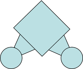

    I've been toying with the idea of using supported 16mm rail for a Z axis, but was thinking of fitting the rails back-to-back, with the rails facing outwards. The idea is similar to the angled version already shown, but would be easier to fabricate from standard parts. The Z carriage would be channel shaped, to keep the linear bearings loaded in the right direction.
    I had thought about doing it the other way around, too, with the rails facing inwards and a block carriage sliding up between them. This ends up a bit wider though, so might limit travel in the Y axis.
    Jeremy

    The problem with the back to back is that the main forces on the z-axis would then be perpendicular to the support which isnt really going to help much. Better to mount the supports on a bit of angle or a square like so:

    Thanks for that idea. I've spent an hour or two looking at ways to make such an angled system, but concluded that it's too tricky. I think I will give the back to back option a try, but as a "face to face" configuration, with the rails fitted either side.
    The rails will be fitted inside a fabricated channel section, capped at top and bottom to stiffen it up. The slides will be bolted either side of the "tongue" of a hefty bit of T section, which in turn will be bolted to the carriage.
    The advantages this arrangement has is that it's relatively easy to make and align, plus it's quite narrow, which gives a smidgen more useful travel.
    I will try and post a sketch later.
    Jeremy
