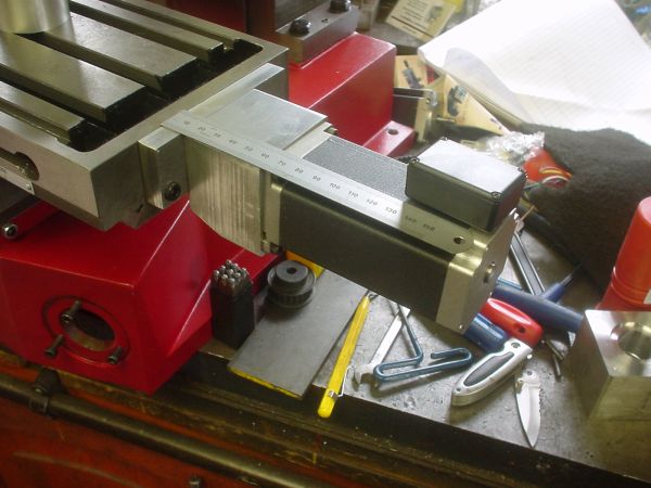

    im on the cusp of wiring my steppers up, however, as they are it will be a bit of a pain to make a nice tidy job at the stepper end,,, is it possible to take the back off a stepper like this without ruining it (iv read that splitting them damages the magnets)Click image for larger version.

    there are 4 screws at the nose running through the entire length of the stepper to the back... i get the uncofortable feeling the whole thing will come apart

    Yes you can take the back off but it has to be in a clean non metallic environment.
    Do not remove the rotor.
    What about using these potting boxes from Arceurotrade, clearance hole in the bottom for the leads, cable in from one side and soldered / heat shrinked joints inside and super glued on.

    Watch out for a stack of slim washers
    cheers robin, ill go in there like a brain surgeon, iv got an extra stepper (untill i build a 4th axis) so if it all goes pear shaped ill get by
    Watch out for a stack of slim washers behind the bearing which will want to zoom into the magnets and gum the works up given half a chance.

    take the back off, turn it over and bang it on the end of a table. make sure there's a load of swarf on the floor, and i can virtually guarantee it won't work again.

    nice one phil... to late now, iv wired them up without taking the back off
    i did take the back off my 4th axis stepper but the rotor touched the sides, it might be damaged now which would be a downer, it was my quietest motor
