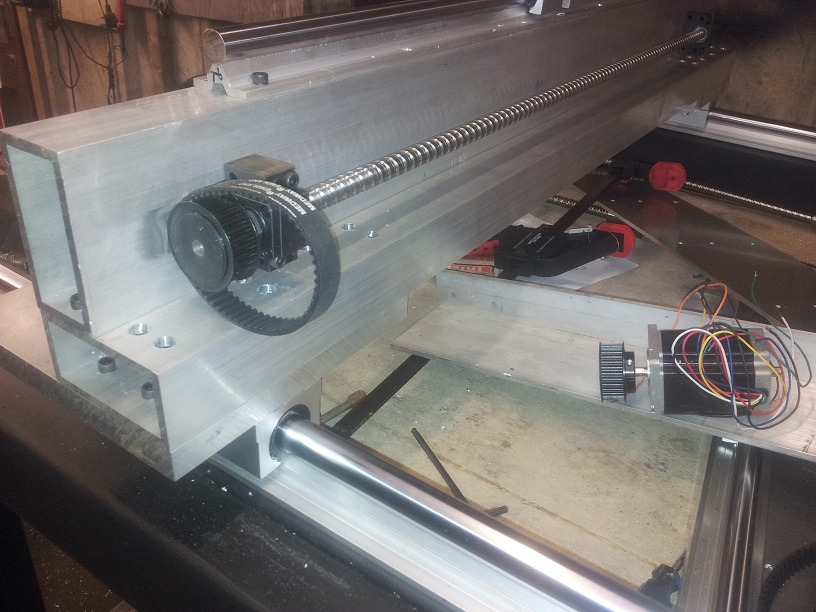

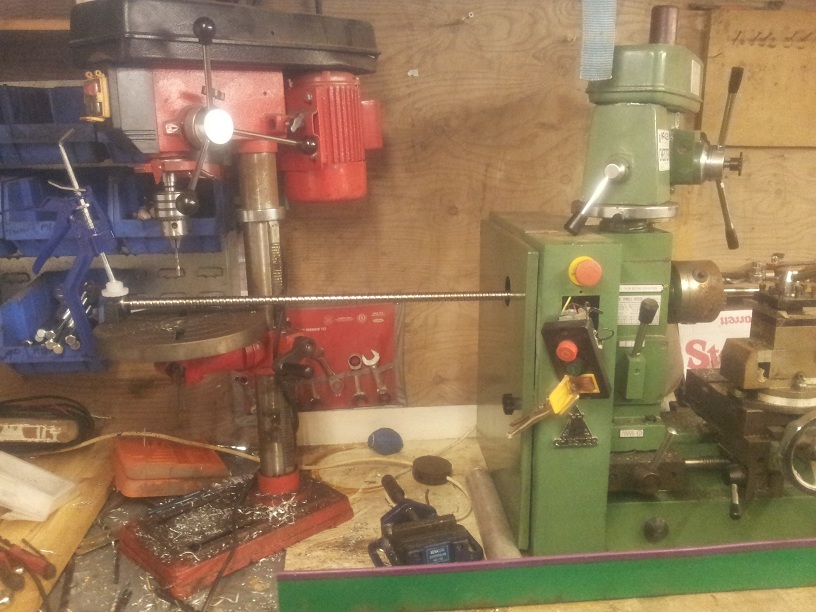

    Right, quick update then.
    Ordered replacement ballnut from Chai, aswell as four ballscrew blocks... Im also now waiting on more bandsaw blades.
    not quite sure where im going to put the Y stepper... should of perservered with drawings.. but too impatient.

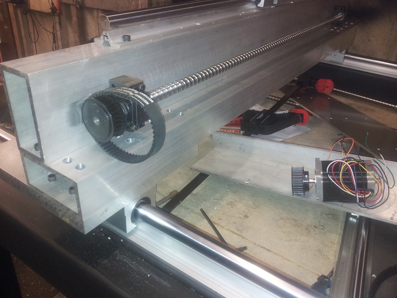

    Plucked up the courage to finish the Y though...

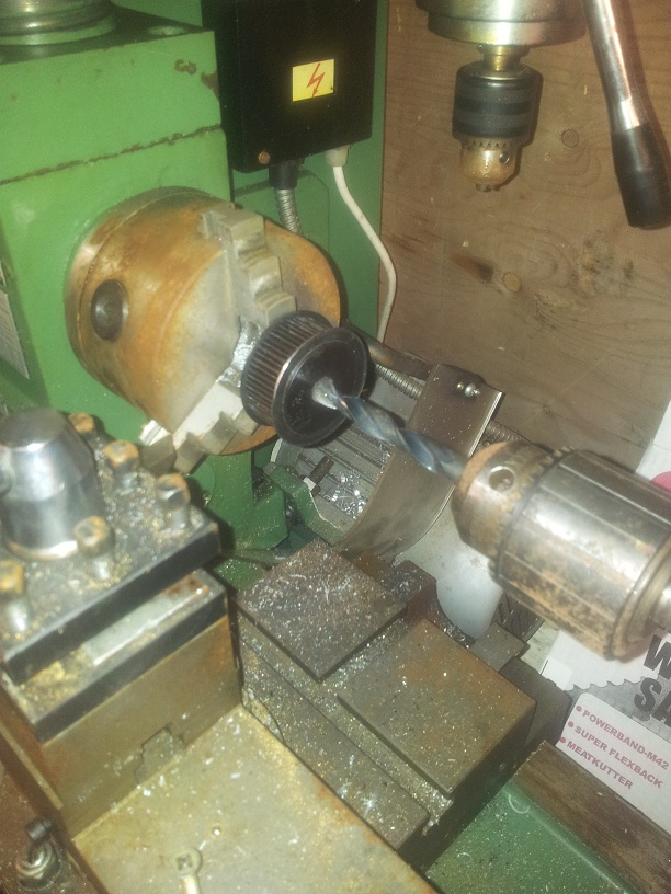

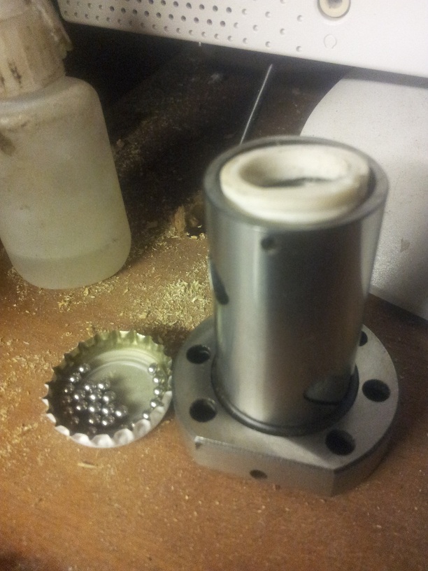

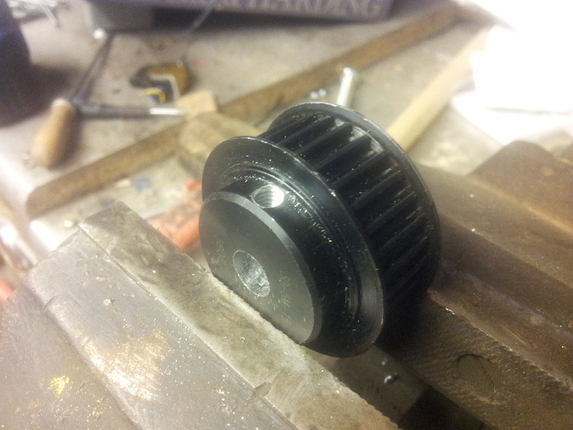

    so, after sitting about feeling sorry for myself.. Ive made atleast a temporary measure... not sure if its good enough for the stresses of milling ali... but will be good enough for now I hope.
    fortunately ive got that old ballnut... the one I broke previously... useful...
    so; heres the plan
    cut the circle out with the band saw (roughly). so it will go in my three jaw lathe chuck.
    bore the center out with lathe
    then get cutting and tapping...
    seems to work... (Jonathon... if you need any help with your 'engineering' give me a shout
