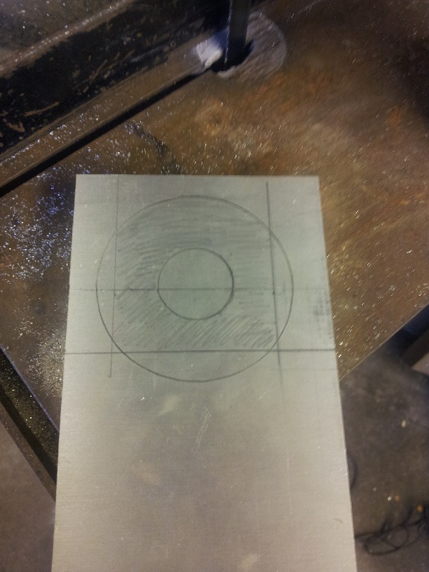

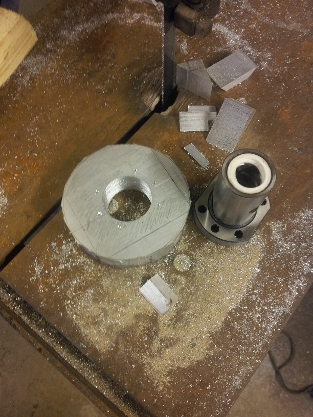

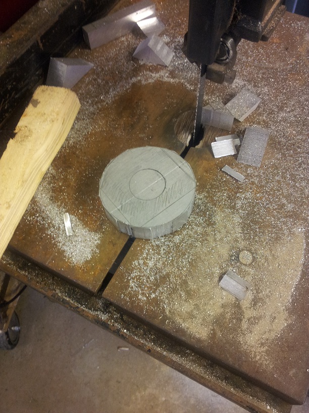

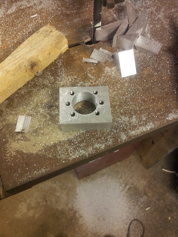

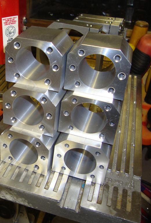

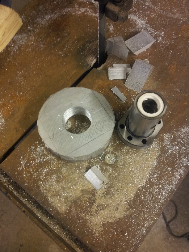

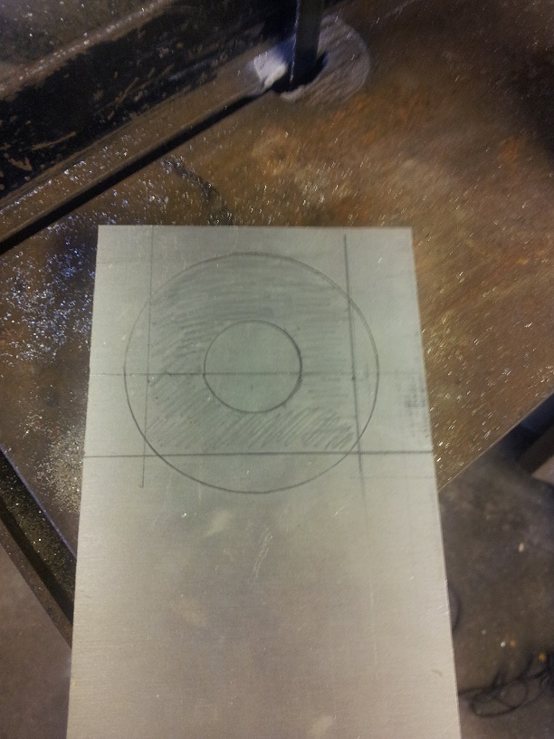

    Why didn't you just make them in the first place if you have the gear to do it?? Sorry just being nosey lol
    think its just lack of confidence martin. I think I mentioned before Ive had the lathe for a while but never really used it. Although your right now ive made one I do wonder why I bought the others... might sell them on or something (when they eventually turn up)

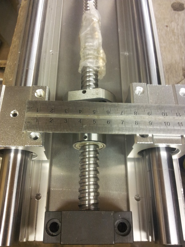

    after Y comes?
ID:	8133Click image for larger version.
ID:	8134Click image for larger version.
ID:	8135Click image for larger version.
    Looking really good and the ballless nut was just the ticket.

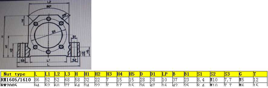

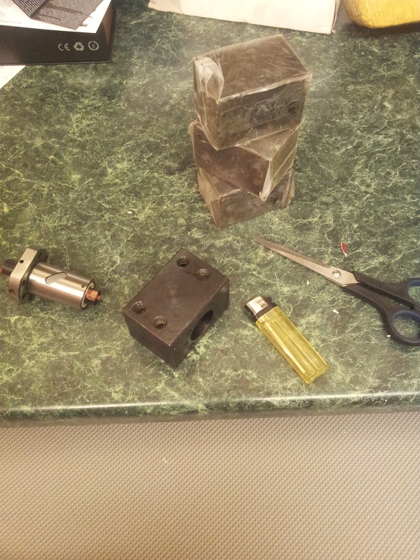

    So, I emailed chai, saying il have four of those ball nut housings to suite 1610 rails.
    assuming he would send me the ones on his ebay shop er... these

    but .... he must of read my previous posts.... or something because I actually recieved these
    Im not having a moan, its not his fault. I didnt specify part numbers or whatever... these are actually the ones id prefer!.
    anyway, so you may also notice the brand new ball-nut.....
    how do I put that on the orphan screw? without dropping my balls everywhere?
    Matt
    Just screw the nut on to the screw. Make sure you push the tube that's in the ballnut against the end of the ballscrew (so it's covering the end machining) as that will ensure the balls cannot drop out. Just do it slowly and carefully and you shouldn't have any problems.
    A tip I was given for removing and replacing the nut, but have not yet tried is that standard airline hose not (curly-wurly) is a really good fit (tight but flexible) and the nut can be wound on and off the screw quite safely. G.
    I doubt that Chai reads all the posts on every forum & even if he did would remember who had ordered what so I would think he has just sent you what he has got at the time.
    That would annoy me, ok you didn't specify a part number but you did go by a picture in his webshop. I know that sellers have the right to substitute items if it's in their terms and conditions but if you had ordered these & had already done the work for this style to fit or were replacing existing units the new ones he has sent wouldn't fit.
    I got caught out with some electronic components I bought from RS in a similar way, my fault I suppose for not reading the technical spec properly but not being a whizz with electronics I just went by the picture. RS were very quick to point that out to me so won't order from them again if I'm not 100% sure exactly what I need, what it looks like & how to use it properly lol.

    i can imagine what has happened here though
    so creaky has noticed chai has ball nut housings in his ebay shop.. but then instead of going through the shop has contacted him direct and asked for 4 ball nut housings... yes maybe chai should have maybe said i have a few different types and asked which ones..
    chai has likely just sent out the most popular ones. luckily though this worked out well any way

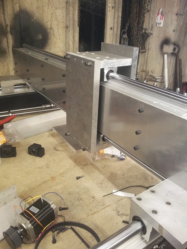

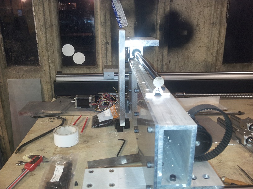

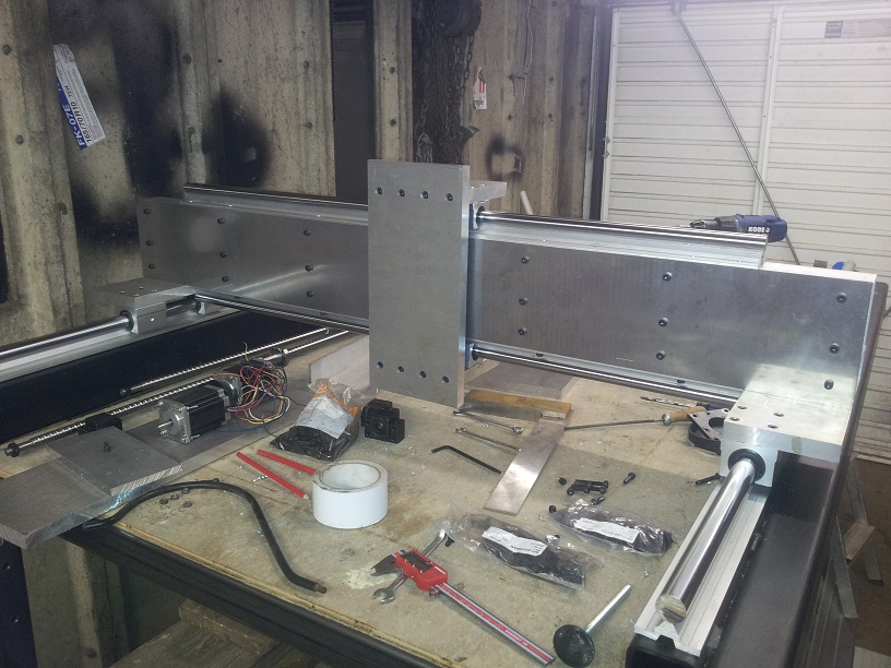

    OK, Id like to have all the peaces together in order to get it moving at the weekend... or atleast try! assuming I can connect the X ballscrews and all the steppers this week I think it may be possible.
    Ive also, for now decided to drive the X with dual steppers... rather than the single stepper long belt approach. Only because its easier (long story) Ultimately I may change my mind on this at a later date... but for the purpose of getting it initially going... 2 steppers it is...

    2 x steppers for X axis 3.1nm (will these be powerful enough? it weighs a ton!) Nema23 Stepper Motor 3.1Nm
