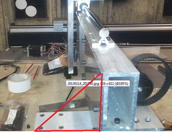

    Can anybody recommend anything else im going to need.... or wish I had?
    Looking good mate, I'm currently in a mexican standoff over clearing the garage out. :(
    You don't seem to have listed a spindle, bucket, water pump, hoses & clamps for water pump, limit switches, homing switches, cable for the switches, PC, software or any end mills?
    PS on the pics of your z-axis at the rear you have a few cm sticking up at the top. If you stick a couple of bits of aly in there bolted to either side it will add rigidity.

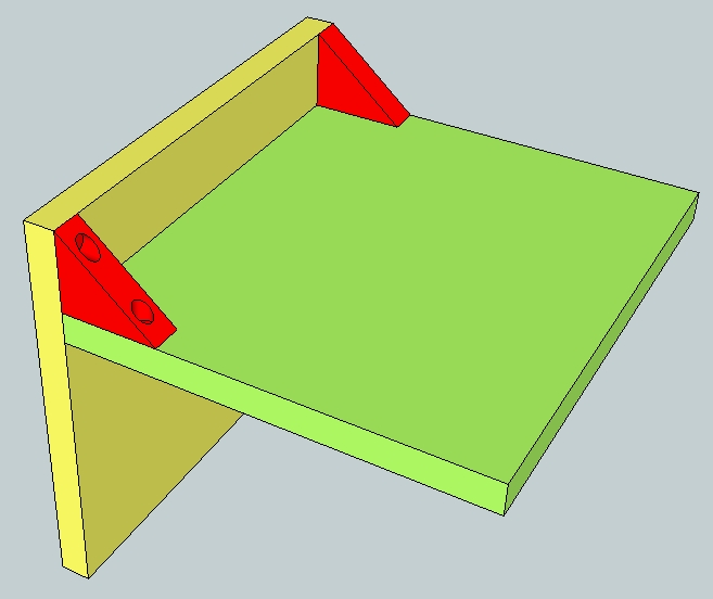

  8. #127
    To start with, Im going to use a pencil!!!. I figure I cant cause any damage that way!. Il order one of these 2.2kw jobbies once Ive sold my wife. I also have a contact into coffee vending machines who can supply me lots of gear for this type of thing
    hmmm.. limit switches etc Im going to get it working first, then get that bit sorted once I understand it a bit more
    Got PC, Software (mach3, and linuxcnc on dual boot) and I work for the biggest industrial supply firm in the country. so tooling is no issue & cheap
    re-bracing...
    That is exactly my plan!. Im also putting some diag bracing on the frame... I was also thinking on the shoulders of the gantry... coming forward....
