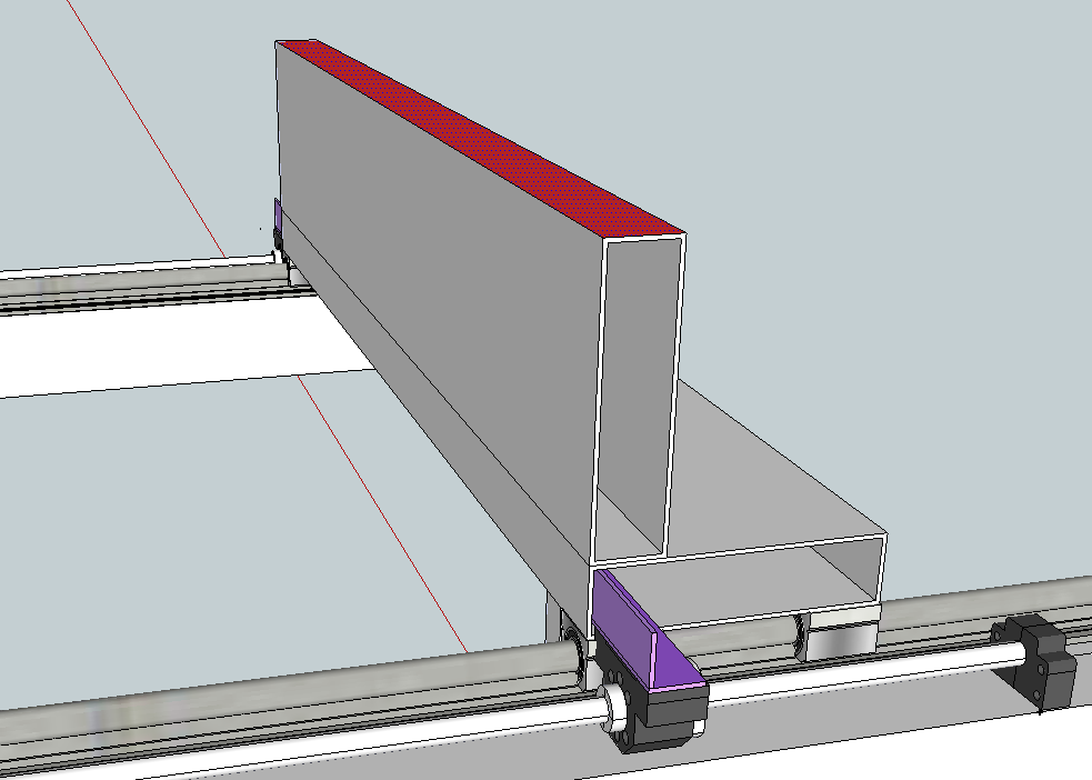

    I think hope that I am nearing the end of the design stage. I genuinely need to start ordering in order to finish the design now. Can I trouble you with casting your eyes over what I hope to be my final table and gantry design.
    I have at present omitted the Z axis, or properly finished the Y. Mainly because until I have the bearing houses and rails in my hand, to measure them.(I appreciate the sites give dimensions. But) until I can bite it, Im not confident enough in my drawings.
    Therefore I need some help before I approach linearmotionbearings2008 is it 'Chai?' for a quote on the bits I need.
    Based on what ive previously explained. I wish to have spinning screws, rather than spin the bearings. (for now). This is mainly due to my present ability. I'm going to go for RM1610 screws (under recommendation). I never did understand irvings point within his post on p.21 when he refers to
    "Another option is to upgrade the bearings to be double angular bearings (BK) at both ends. This will increase the critical speed to 880rpm (4.4m/min), better but still not great."
    so, BK is like a bearing (next to the driven end of the screw) and BF is designed just as a support. I assume the BK end needs to be machined to fit the bearing, and the BF is non-machined.
    His point is simply it would be better if I have BF style at both ends. and therefore get each end screw machined to suite?
    So, based on my design. I will need
    (X Axis)
    * 2 x RM1610 (1500mm) screws (machined at both ends, one side will need to be machined to fit through the BF bearing and also so I can fit a driven pulley, and the other needs to be machined simply to fit the BF bearing. Im assuming I just let Chai know that I want to fit a pulley so he leaves enough shaft after the bearing housing. then I just by a piloted pulley and bore it to fit the machined end of the screw?
    * 4 x BF bearing with supported block mouting
    * 1 x ballscrew nut (quite tempted to make my own housing for this)
    * 2 x SBR20 fully supported rail (1600mm) (with 4 bearing blocks) I assume SBR20UU
    Y Axis
    *1 x RM1610 Screw (1000mm) (same question as above)
    * 2 x BF bearing with supported block mouting
    * 2 x SBR20 fully supported rail (1000mm) (with 4 bearing blocks)
    Z Axis
    * 1 x RM1610 Screw (300mm)
    * 1 x SBR16 fully supported rail (300mm) (with 4 bearing blocks)
    Right, now I have satisfactorily embarrassed myself with incorrect terminology can somebody tell me if the above sounds about right? Or have I completely misinterpret ted anything?
    while im asking the question.
    assuming Im not bothered about speed initially. Therefore Id prefer to gear everything at a higher resoloution 1 turn of the stepper, means 1/2 a turn of the ballscrew. Therefore the pulleys on the ballscrew need to be twice the diameter of the pulley on the stepper.
    so something like
    10XL037 Flanged Timing Pulley :: BearingBoys.co.uk
    for the steppers
    and
    16XL037 Flanged Timing Pulley :: BearingBoys.co.uk
    for they the screws?
    The steel on the frame is mainly 60x60x3mm which I may get ordered so I can begin building the frame.
    Id appreciate your thoughts.. negative or positive.
    RM1610 is good for X and Y since the higher pitch means you can get a higher feedrate with limited critical speed, however since the Z-axis screw is so short there's no need to do this, so stick with RM1605 on Z to maintain good resolution.
    I advise using bigger rails on X and Z. Particularly Z since the forces on Z are a similar magnitude to Y, so you shouldn't use smaller rails.
    For a 1:2 ratio you don't want 10:16 pulleys for two reasons - for a start 16/10 is 1.6 not 2, and also it's not good to have such small pulleys as you will have less teeth engaged in the belt which can lead to premature wear and possibly reduced accuracy. It's best to use at least 15T, so 15:30 would be good. Also HTD pulleys are better than XL.
    The BK and BF mounts both hold bearings, the difference is the type and quantity. BK has two angular contact bearings inside, which means it can resist both radial and axial loads, whereas BF just has one 'standard' bearing in it, so only supports the ballscrew radially. If I were you, since you have the lathe, I'd make my own bearing mounts from aluminium. It's not that complicated and you'll be able to do a much better (and cheaper) job of it than the ones from China. They are often too tight a fit, or the seal rubs on the nut or other annoying thins to correct. I've never bought the BK/BF blocks myself, but I know people who have and they've all needed tweaking.
    Also making your own ballnut mounts is a good plan simply because it's so much cheaper. Here's one I made earlier:

    Jonathon, Jonathon... How on gods green do I even start thinking about making something of that caliber? they really are amazing. But I am a realist as much as I could probably make one, if I set my mind to it. The other 7 just wouldnt be the 'same'. :-D Just looking at them, their accuracy makes me feel sick. Its one of these situations where I need to see them before I know what Im doing... For example you have mentioned seals, Ive heard circlips mentioned. All of this is assumed knowlege that you guys have gathered from building a mk1 machine first. And I think ultimately this is what I am going to have to do.
    An example, if I need 1500mm of drivable screw. (inside the supports) then how do I calculate how much 'extra' I need at either end to go through the housing (your suggesting I do not buy from the same supplier), and also through the support on the other side and through a pulley that I also havent bought!. This is why (I guess) for me it may be easier to just buy the supported bearing housings from the china supplier and if necessary re-make them based on the design on the ones that come with the screw? (can you see my thought pattern?) On previous threads on here I noticed your original build thread for your first machine. This machine was significantly different to your present one, and I guess you learnt from your mistakes on that build to gain the knowlege you have today?
    You say i should upgrade my X axis rails, they are already SBR20... what is an upgrade to them?
    So, taking on board your comments, a modification to the shopping list would be

    Although your comments re-pulleys is useful. Its another answer that fills my head with more questions... I think il put off buying pulleys until I have stuff on the workshop floor I can bite.
    I genuinely really appreciate your thoughts, Im absorbing as much as I can. Your clearly an immensly clever lad but Im just a normal bloke!. The entire point of me building a machine is to be able to get to a point where I can make 'things' more accurate, Its a chicken and egg situation. If I had a rig, this rig build would be as easy as you make it sound!
    SBR25, or minimum 15mm profile rails (linear guides). Latter is a bit too expensive though.
    Get the Y and Z ballscrews with the standard end-machining since they are quite short, so critical speed is not a problem, but do ask Chai to increase the length of the cylindrical portion on the fixed end of the screw (dimension F on his drawing) from 15mm to 25mm to accommodate the pulley.
    Since the X-axis ballscrew is quite long, to get the best feedrates you can put a pair of angular contact bearings on both ends, so you could get the ballscrew machined the same on both ends.
    Here are the standard end-machining drawings from Chai:

    For all that are interested. Finished design.
