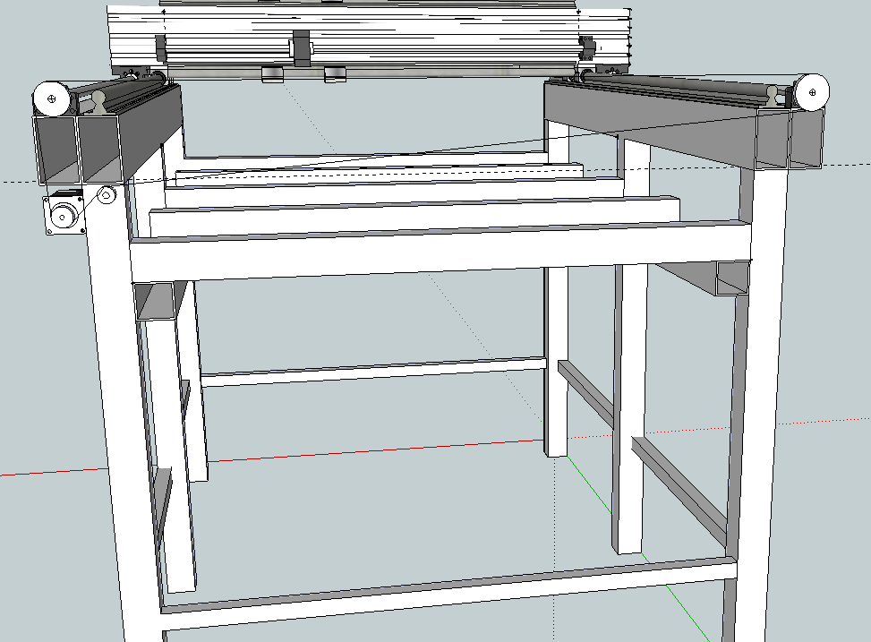

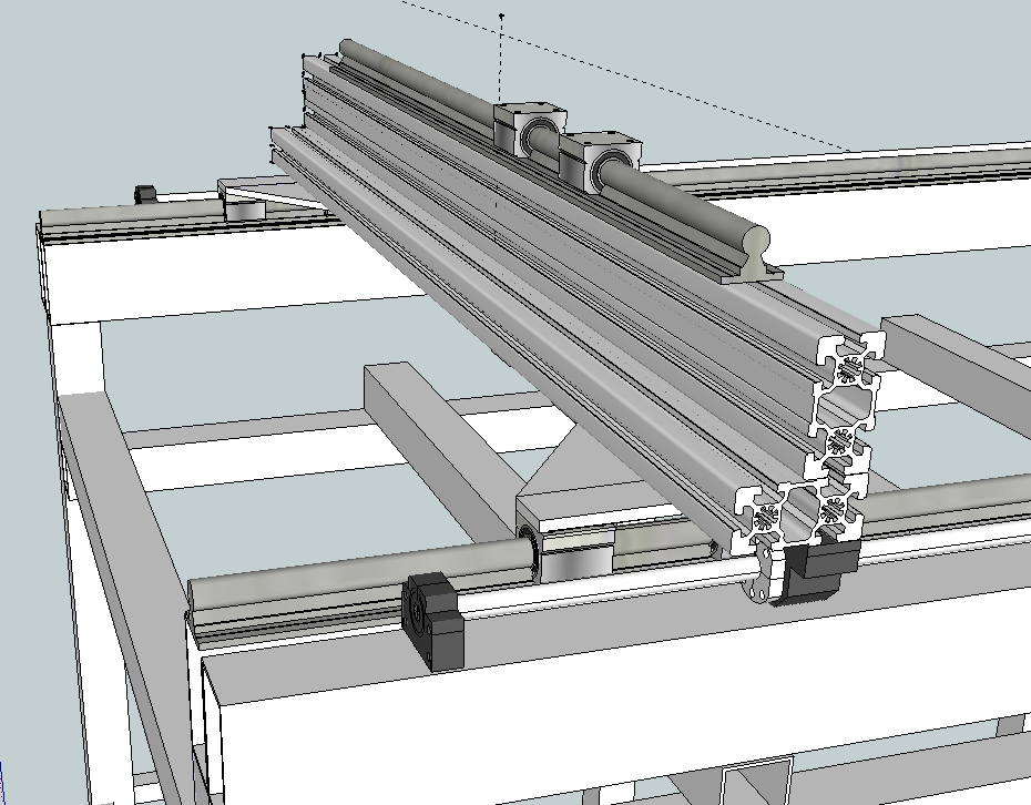

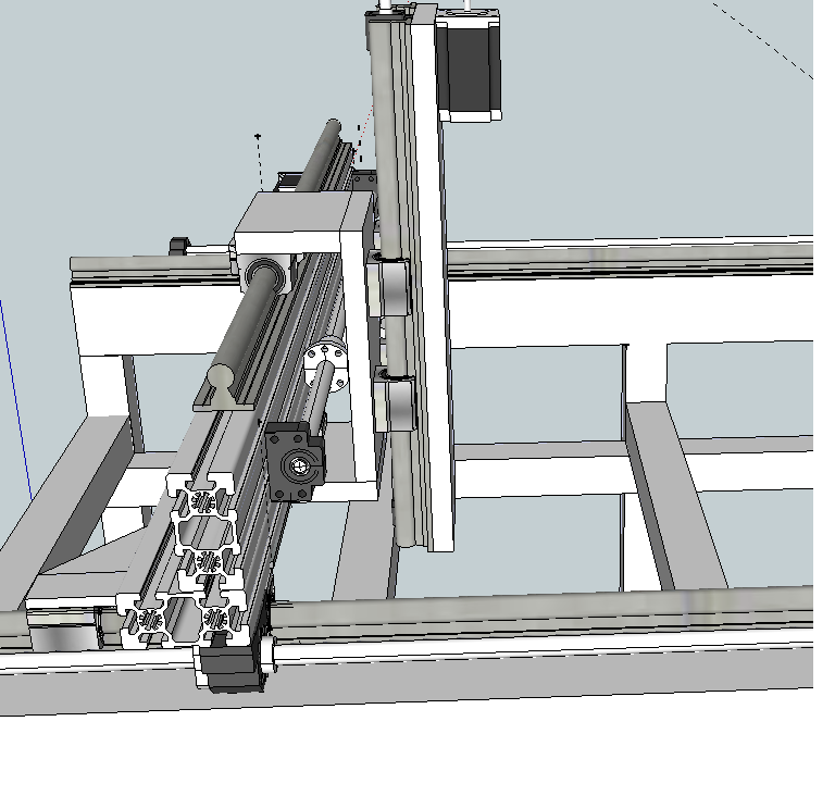

    Gentlemen.
    I think hope that I am nearing the end of the design stage. I genuinely need to start ordering in order to finish the design now. Can I trouble you with casting your eyes over what I hope to be my final table and gantry design.
    I have at present omitted the Z axis, or properly finished the Y. Mainly because until I have the bearing houses and rails in my hand, to measure them.(I appreciate the sites give dimensions. But) until I can bite it, Im not confident enough in my drawings.
    Therefore I need some help before I approach linearmotionbearings2008 is it 'Chai?' for a quote on the bits I need.
    Based on what ive previously explained. I wish to have spinning screws, rather than spin the bearings. (for now). This is mainly due to my present ability. I'm going to go for RM1610 screws (under recommendation). I never did understand irvings point within his post on p.21 when he refers to
    "Another option is to upgrade the bearings to be double angular bearings (BK) at both ends. This will increase the critical speed to 880rpm (4.4m/min), better but still not great."
    so, BK is like a bearing (next to the driven end of the screw) and BF is designed just as a support. I assume the BK end needs to be machined to fit the bearing, and the BF is non-machined.
    His point is simply it would be better if I have BF style at both ends. and therefore get each end screw machined to suite?
    So, based on my design. I will need
    (X Axis)
    * 2 x RM1610 (1500mm) screws (machined at both ends, one side will need to be machined to fit through the BF bearing and also so I can fit a driven pulley, and the other needs to be machined simply to fit the BF bearing. Im assuming I just let Chai know that I want to fit a pulley so he leaves enough shaft after the bearing housing. then I just by a piloted pulley and bore it to fit the machined end of the screw?
    * 4 x BF bearing with supported block mouting
    * 1 x ballscrew nut (quite tempted to make my own housing for this)
    * 2 x SBR20 fully supported rail (1600mm) (with 4 bearing blocks) I assume SBR20UU
    Y Axis
    *1 x RM1610 Screw (1000mm) (same question as above)
    * 2 x BF bearing with supported block mouting
    * 2 x SBR20 fully supported rail (1000mm) (with 4 bearing blocks)
    Z Axis
    * 1 x RM1610 Screw (300mm)
    * 1 x SBR16 fully supported rail (300mm) (with 4 bearing blocks)
    Right, now I have satisfactorily embarrassed myself with incorrect terminology can somebody tell me if the above sounds about right? Or have I completely misinterpret ted anything?
    while im asking the question.
    assuming Im not bothered about speed initially. Therefore Id prefer to gear everything at a higher resoloution 1 turn of the stepper, means 1/2 a turn of the ballscrew. Therefore the pulleys on the ballscrew need to be twice the diameter of the pulley on the stepper.
    so something like
    10XL037 Flanged Timing Pulley :: BearingBoys.co.uk
    for the steppers
    and
    16XL037 Flanged Timing Pulley :: BearingBoys.co.uk
    for they the screws?
    The steel on the frame is mainly 60x60x3mm which I may get ordered so I can begin building the frame.
    Id appreciate your thoughts.. negative or positive.
  3. #33

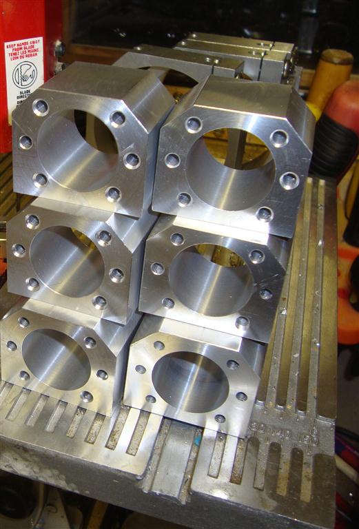

    Also making your own ballnut mounts is a good plan simply because it's so much cheaper. Here's one I made earlier:

    They're a copy of a common design on eBay. I started with 2" square aluminium bar, used the lathe to face both sides and bore the hole in the middle. Next I milled two opposite sides to the correct size using a fly-cutter (hence the nice finish). I then spotted and drilled the holes using the milling machine by just moving to the correct co-ordinates for each hole and finished off by milling the other 2 sides and the corners. The milling was done using CNC and g-code written then saved as I went along, but it could just as easily be done manually. I could have started with aluminium bar closer to the final size to save some milling, but since my lathe has a 4-jaw self centering chuck it's more convenient to use that than get a load of rectangles on centre with the 4 independent jaw chuck.

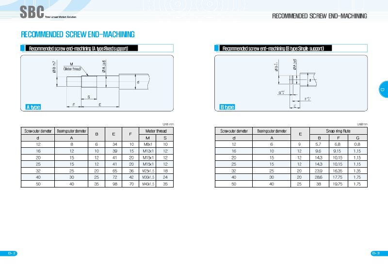

    Here are the standard end-machining drawings from Chai:
Name:	end machining.png
    You can see from those how much 'extra' length you need for each ballscrew. If you ask Chai for RM1610-1000mm for instance, he will machine it such that the total length is 1000mm and the actual ballscrew is 924mm with F increased to 25mm.

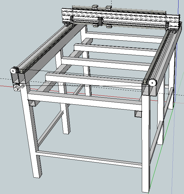

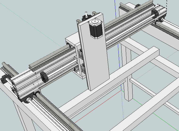

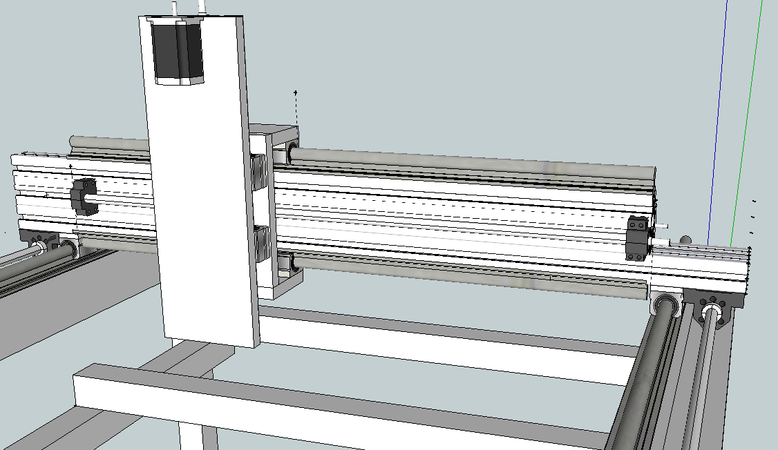

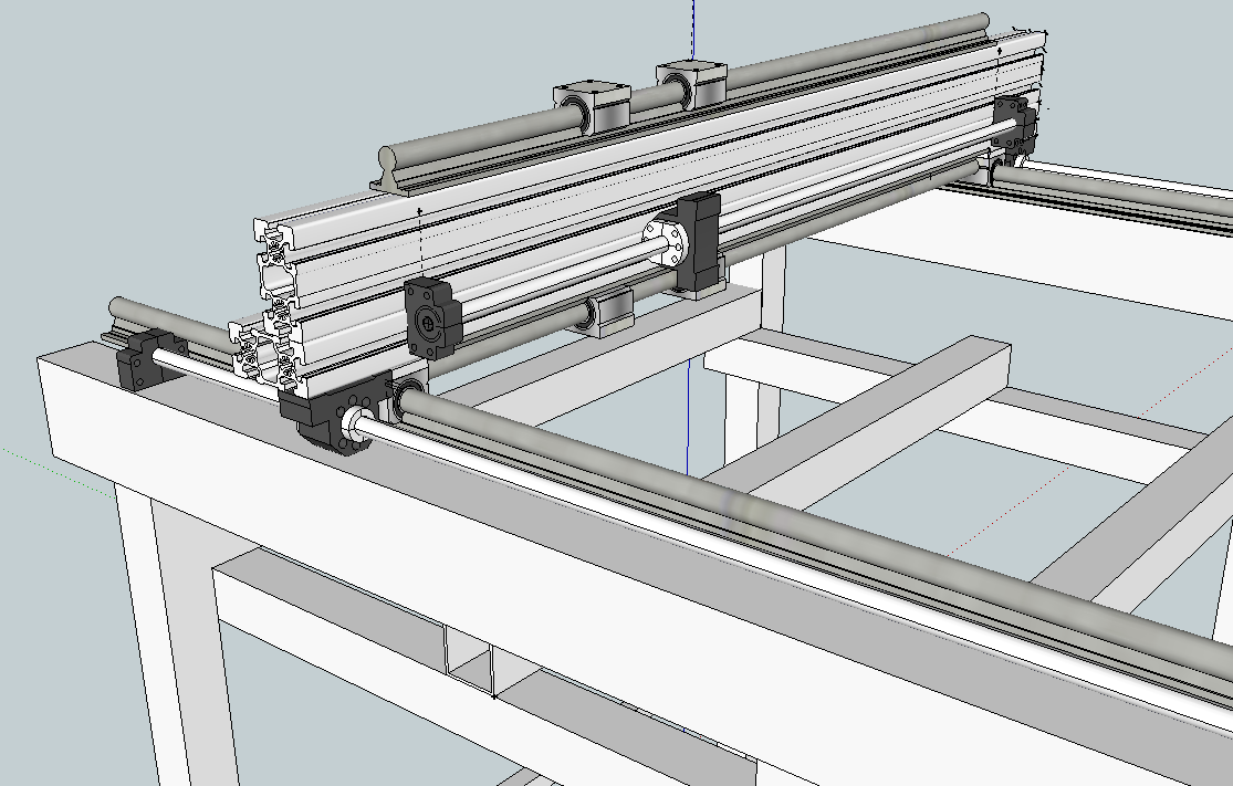

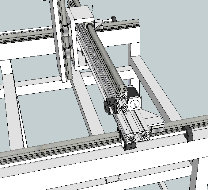

    For all that are interested. Finished design.
ID:	7396   Click image for larger version.
ID:	7395   Click image for larger version.
ID:	7397   Click image for larger version.
  9. Looking good, how are you connecting the steppers to the frame?
  10. #40
    hey, thanks for the reply!
    I see "you lot" mill out these sexy pocketed aluminum peaces of art. take a photo stand back and say 'that'll do'. I dunno glue? bluetac? nails?
    Il probably make some steel brackets initially until I become a certified wizard.
